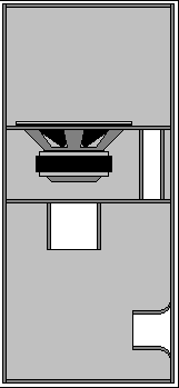

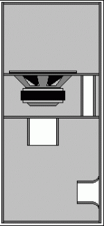

Actually, the 8th-order bandpass is not something an Audiophile would like. It is more of an acoustic trick than anything else because it is designed to get huge amounts of output from small woofers while sacrificing definition, speed, and musicality. It is just that no one has built one yet that I have heard of so I want to try it out and see what happens. The woofer itself is quite crappy, with extension only down to 85 Hz, so its use is limited to a multimedia sub of some sort. The only thing is that the T/S parameters that Radio Shack provides are too sketchy for Isaac's Subwoofer Simulator to work. Darn.
Here is an illustration of an 8 th order bandpass box taken from Isaac's, (F4ier's), website.
