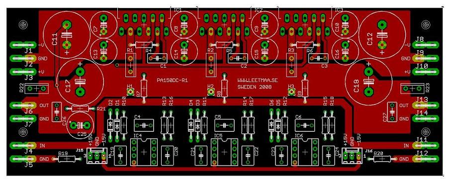

Boucherot cell (Zobel network) values
Generally the resistor value choosen for the Boucherot cell seems to be 2.7R here at diyaudio.com. Why is that? Wikipedia claims that the values often is in the range of 5R to 10R.
Is there anyway to calculate this value? I guess there is but how important is it? Would a 2.5R do the job as well as 2.7R?

Danielwritesbac: No it's not a TDA-based amp. It's a LM3886-based board with 3 LM3886 in parallel. PA150-config with DC-servo, see attached image. Boards are ordered and I attend to use them in a bridged/parallel configuration. The main reason why I asked is that I discovered that the resistors I wanted to use dont come in the value of 2.7R. Then I started thinking about why that value seems to be the generall choosen one in all configuration I have seen here, since I have read different suggestions at Wikipedia for example.
Your detailed answer has answer my thoughts. People here dont really know why they put 2.7R, they just do it because everyone else do it 😉
Peranders: Yes I have read AN-1192. National only mention this under the partlist for the PA100-schematic, as a "Snubber Network on Output" on page 16. I cant find any other detailed information about it. It's also in the Overture Design Guide but no detailed axplenation about it in there to.
