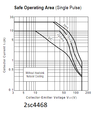

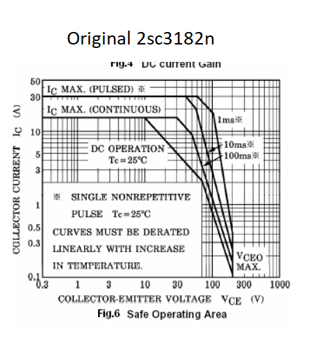

I looked at the SOA of 2sc4468/2sa . , pretty similar to the originals , not the "The second-breakdown breakpoint in the SOA curve " need to read more about that and check.The second-breakdown breakpoint in the SOA curve is more important - where the slope changes needs to be at least as high as it was.

Top curve looks like 2SC3281, not 3182. It’s 15A/150W/200V, full power to 70 V. I think the 3182 did full power to 70V too, but it’s only 10A/100W/140V. That Sanken will handle just as much, at your 55V rail voltage. Sanken (and Toshiba) make cheap-o versions that start dropping off power handling around 30V Vce. Just don’t stick those in there.
