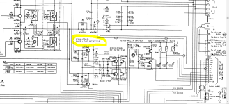

I'm not sure why you're talking about output devices when you have an amp that won't even light up the standby LED. How about fixing that first?
It sounds like there's an always-on housekeeping power supply somewhere. Check the fuse. Check that the rectifier still rectifies, etc. Once you get to the point where you can power up the amp you can start checking the rest.

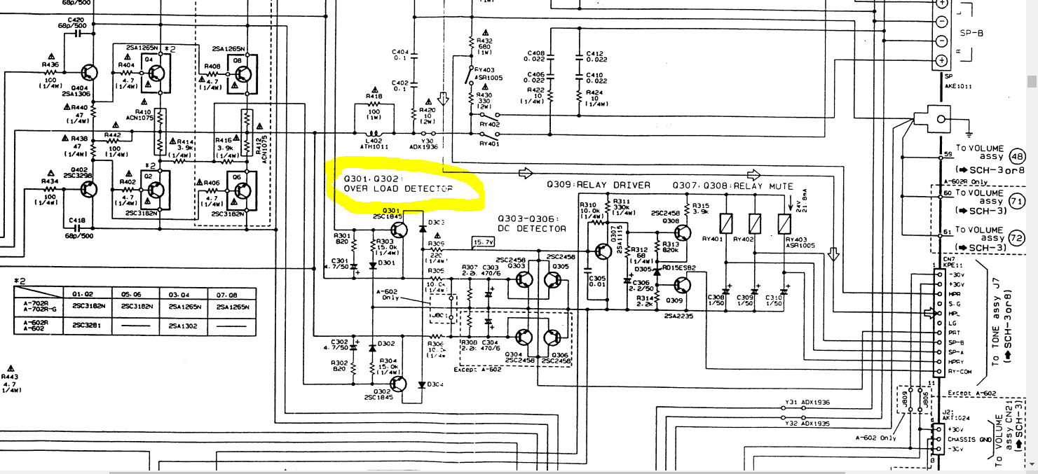

@brianco it has two fuses, I only saw one ( that was good) , the other one is burnt 3.15A 250V.

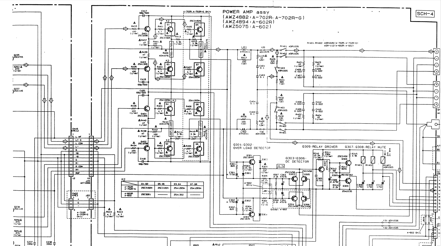

All output transistors are dead, I desoldered them, they are either open or short.
No short circuit on the drivers, power supply to the board now does not show short circuit.
Should I try to turn it on with the power amp unplugged first.
Try without output trans?. Output is 3EF as I can see .

No, it does not matter (much) since in 99,99% of the amp running, you're not even CLOSE to the maximum rate. Your problem is somewhere else and the 'perfect match' of the power trans is not what keeps your amp failing. Get to the source of the failure and care about what happens before the final stage. If you just swap the final stage trans your amp will blow them again anyway, no matter what you put in there.

Check the power supply first, then the pre stage(s). If you don't fix that, every swapped trans will blow too anyway.
Reactions: U102324
@ICG Amplifier died , because I accidently droped water in it while it was running. So far fuse was blown, and all the output transistors.
Yes, I've read that. But that does not mean the pre stages are intact!
E:
Yes, check the pre stages and check them after desoldering them, then check the final stage trans but if the pre are blown, the final stage will be too!

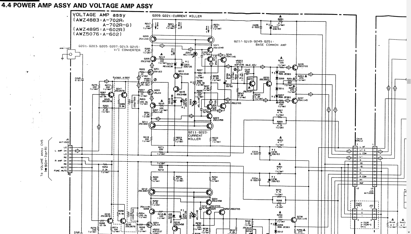

Verify operation of the bias stack, and everything up to R347,439 and 441. Disconnect the zobel. Then run off the drivers with a 1K ohm load (and a dim bulb). If there is no sudden jump in current move to a variac and turn it all the way up, slowly, again being on the lookout for any jump in current. Should be full signal, undistorted.
For output transistors use 2SC5200N (Toshiba), 2SC5242 (Fairchild), or NJW0281 (ON) - and the PNPs of course. These are the most direct replacements for C3182. Reconnect the zobel of course. It will NOT be needed running off high fT drivers, and could overload them if hit with high level high frequency.

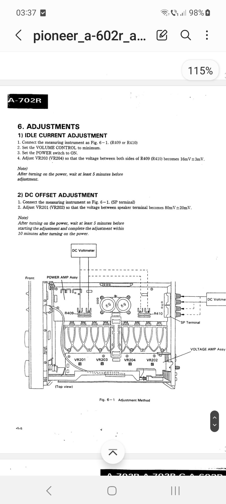

@wg_ski Measured each driver , they were fine.
Power transistors are in ( using 2sc4468/ 2sa ) Until I buy something else.

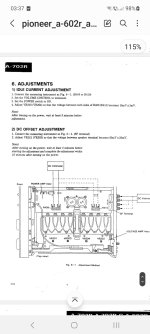

Adjusted idle current at 16mV , how much mA would that be? Seems very low.
Next is dc offset which is 180mV now.
Should I aim for close to 0 as possible or the manual says 80+- 20 mV , .
For transistors when I will order, you recommend getting the originals 2sc3182n or I risk getting fakes ? Maybe is old stock.
Or the 2sc5200N u recommended. ?.
What about MJL3281A / MJL1302A, same 30mhz , stronger transistors?.
Thank you .

The over current detectors respond to emitter current and output voltage, therefore effectively VCE. With different power trannies, they will still trigger in the same place. That just has to be safe for the new transistors. Of course bigger ones are possible. The C3182 is the baby brother to the C3281. The MJL version is even bigger. With the bigger parts, phase margin could degrade, and high frequency distortion could increase. With EF3 the latter is unlikely. It could actually be better, the C3182’s were less expensive in the day and it very well could have been why they were selected. It turns out the MJL0281 “shrunk” version comes closest to the original Toshiba parts. The N-cased version of the C5200 has the shrunk version of the die, same as the TTC version. It gets even crazier and more confusing than that. The original Toshiba C5200 had two baby brothers - the C5198 and C5242. But when Fairchild made their C5242 they put in their full size version of the C5200. The Toshiba family (which include the ON versions) are pretty much interchangeable as long as you don’t downsize. Parallel banks of course NEED to be the same, and complementary pairs should be used. I have paired L-cased C5200’s with A1302’s because a had a surplus of the PNPs from way back when and never noticed any ill effects. But they are the same size and the amps in question had a distortion floor of about .005%, limited by EM compatibility. It wouldn’t have gotten better if the transistors were perfectly linear.
Old stock 3182’s would be fine if you can get them. Big if, but not as impossible as old stock 3281’s.
