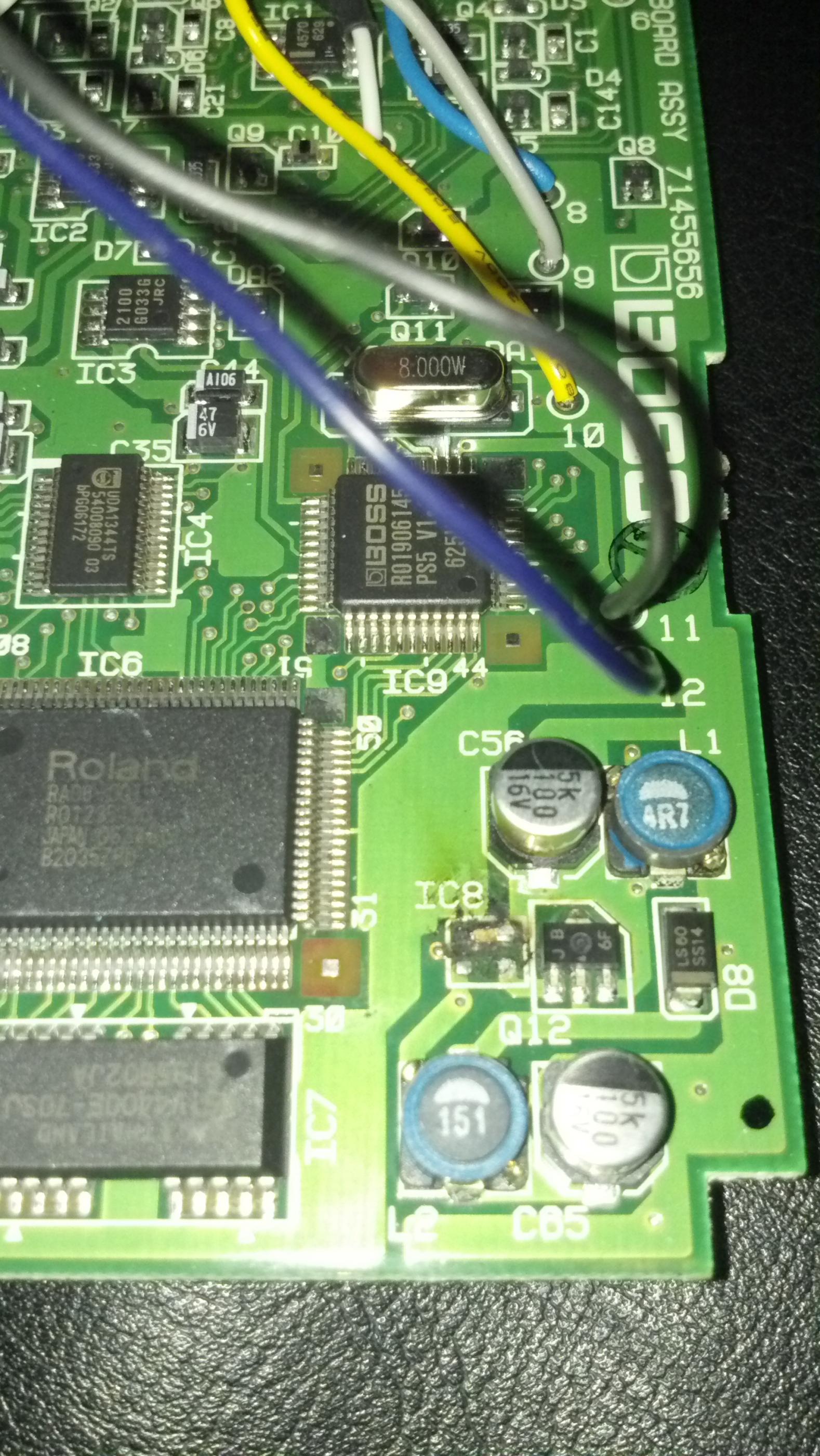

I recently picked up a Boss PS-5 Super Shifter that won't power up, from Ebay.
After opening it, I found that someone else had previously attempted a repair.
Part of their "repair" was to remove IC8. Does anyone have a schematic or other information? Thanks in advance for the help.

The PS5 is an intelligent harmonizer so it should use a sort of DSP to detect pitch an generate the harmonized note. It's not a simple device and find a schematic would be very hard...
Number of pins of IC8 and package? DIL , SIL , SOIC ecc
Hope it isn't the DSP processor or you can trash the unit...
I don't expect it is anything as significant as the DSP. A picture is worth a thousand words though, so have a look...

Uhm IC8 seems buruned 🙂 I think it's a voltage regulator due to the fact it has only 3 PIN and is an Ic (not a transistor or mosfet) , so can be a sort of voltage regulator to provide supply to DSP 3.3 or 5 don't know...Can you read anything on it?
Sorry , i've just looked at stomoboxzone and seems a user report it as a
S-8520E33MC-BJS-T2
A PWM regulator to provide 3.3V .. it's hard to find 🙁
If you can find the part then fix is easy , only other solution is to use a lineare voltage regulator bypassing this part of the circuit , easy if you are experienced ..
