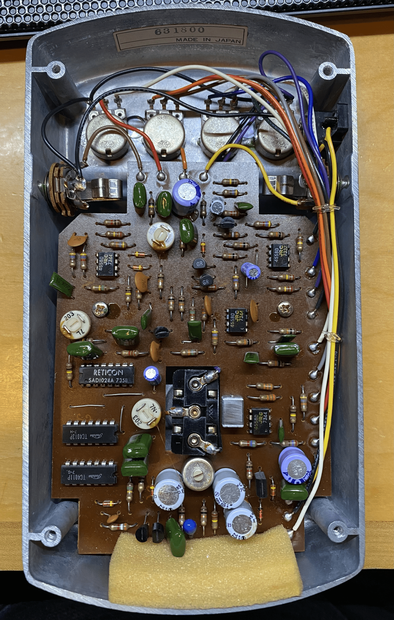

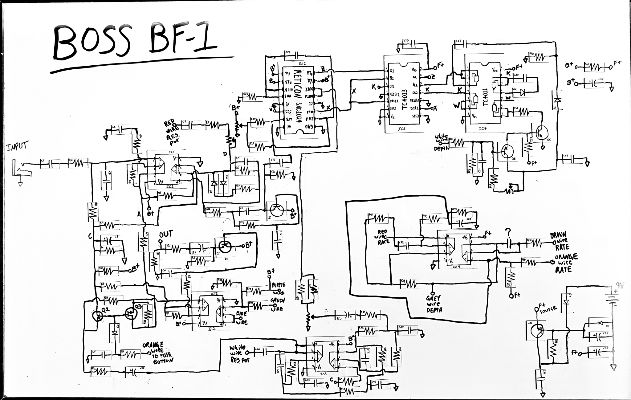

So, I went to work reverse engineering the PCB (photo attached). Since it was only one layer of traces, it wasn't too bad to draw it out. I first drew it out on a white board (photo attached) and then made a better looking schematic on KiCad (pdf attached).
I am mostly creating this thread to share the schematic for others since I was unable to find one online. But I want to be clear that there could be error in this. I am not saying this is 100% the Boss BF-1 schematic.

- I noticed the electrolytic caps where max voltage rating of 16V. I took em out, tested them all and replaced all but a few (C10 & C21, they were good). I replaced the others with Nichicon caps that matched the previous caps almost exactly (capacitance, rated voltage, temp rating, and diameter). This did not fix the noise, but it did make the effect sound much more lush and full which is nice.
- I have looked through all the datasheets and, to me, it seems like all the active components can handle 18V, yet I do not know about the signal strength increase due to 18V that could have maybe broken a component. The only active components that could have hit the hardest is the Reticon SAD1024 since the datasheet states the absolute max voltage it can take is 18V. But that chip is used in the effect line for delays and the effect sounds just fine. So, I'm at a loss there.
- The Zener diode (D6) is fine. I have yet to take out the other diode to see what they are and if they work.

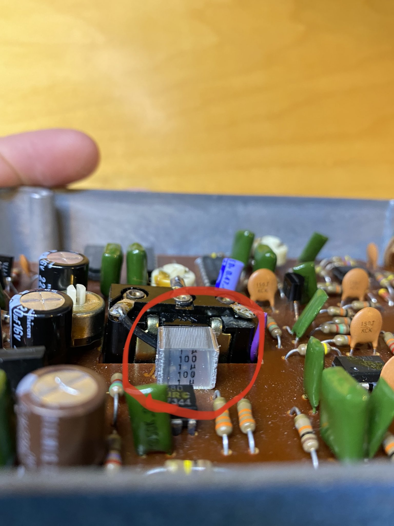

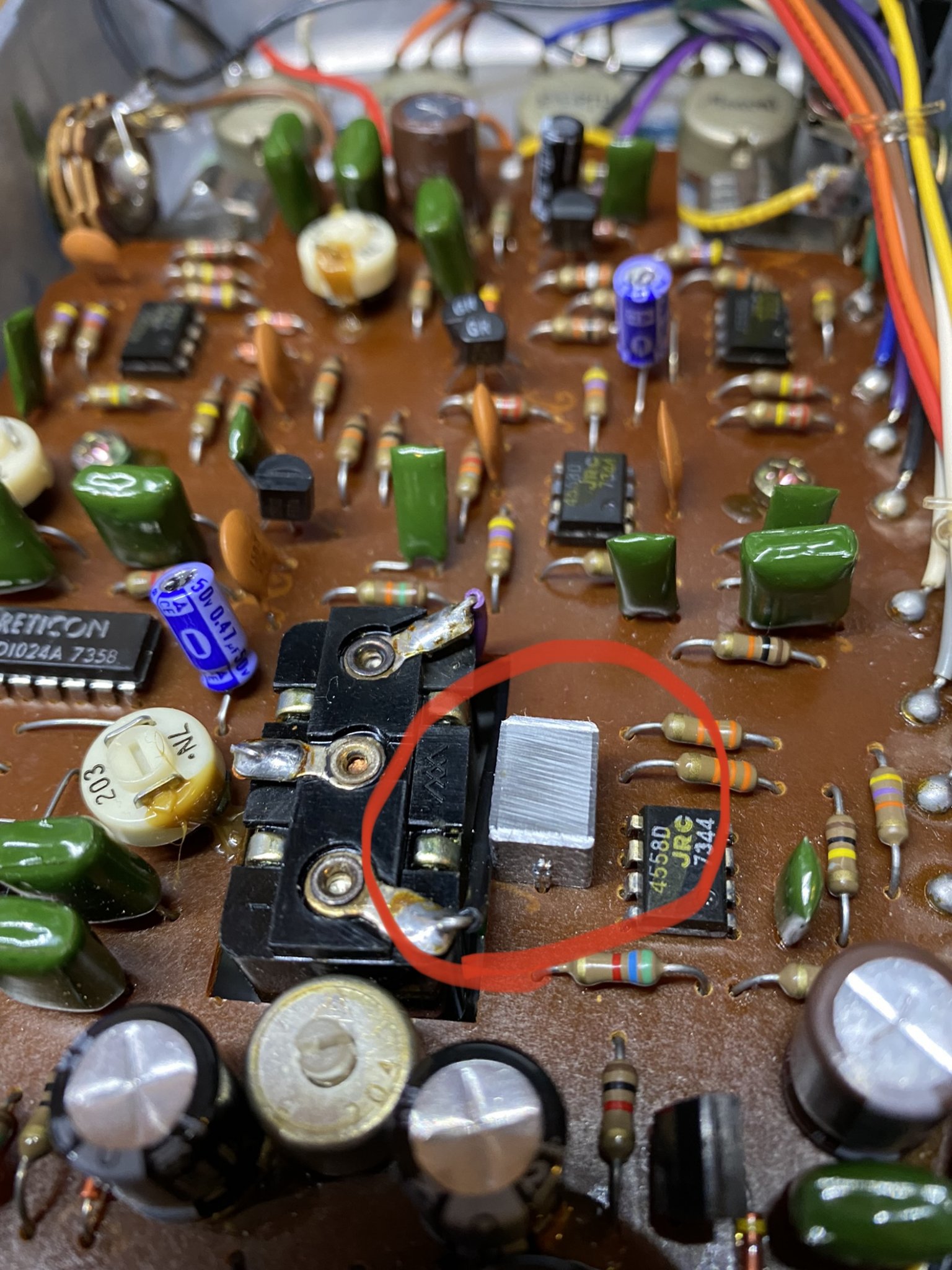

- C33 is a puzzle to me. It is also the (?) on the whiteboard schematic. I have attached a picture of it. Im not completely sure what it is, but it does say 1uF on it. If anyone has any clue, please let me know. I have tried to find it online to identify what it is exactly.
