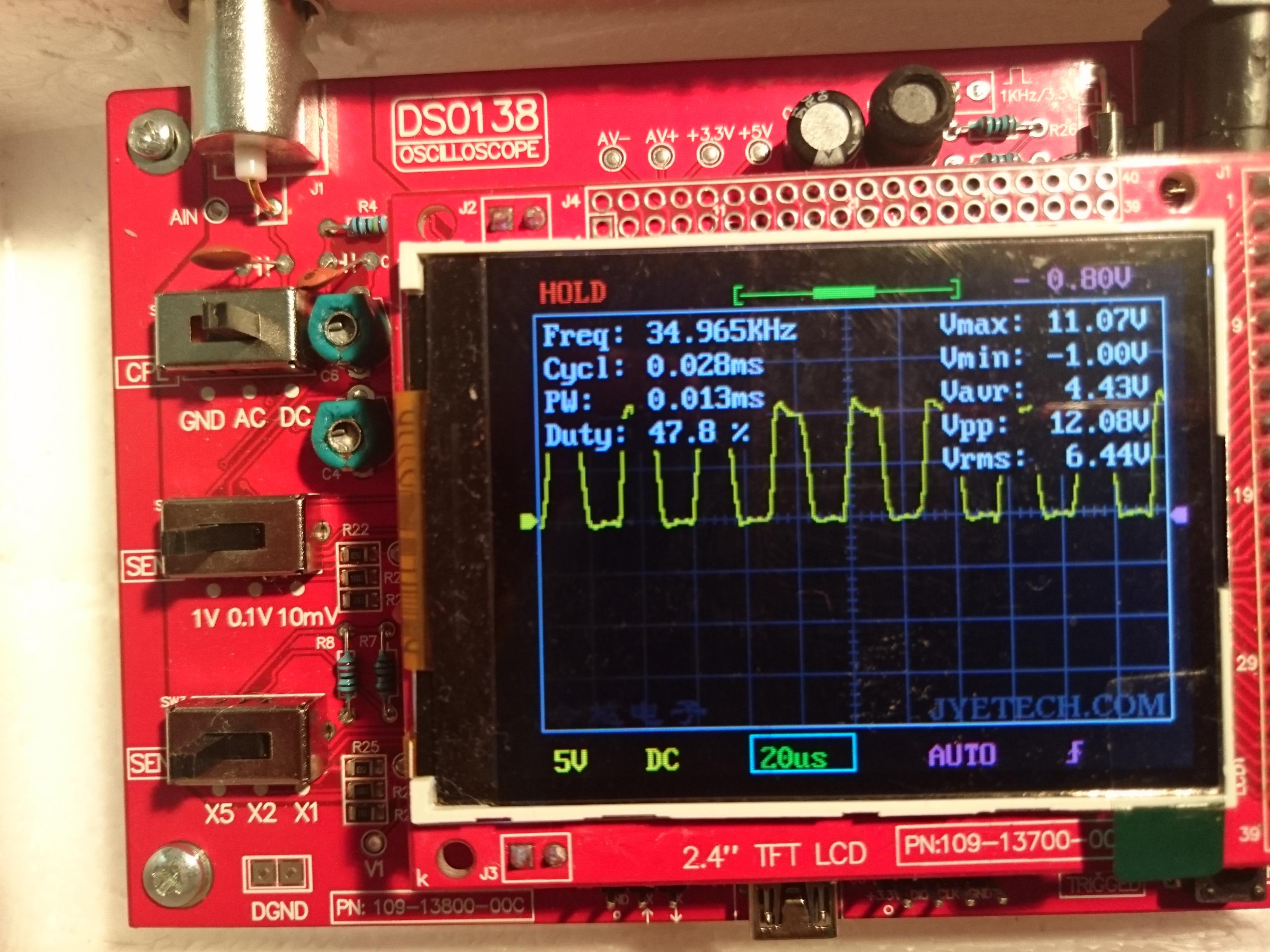

I think i partially solved the PS problem the transistor tha trigger the d600k Was bad(like two diodes) i replaced and the amp needs 12 volts in remote to turn on.
Could some one tell me if this model is diferent in the behavior of the Leds at the starting process???, i ask this because when i put 12 v in remote, the green led flashes three times and then stays On, when the green led stops the flashing i have rail voltages( 70 volts) , but the red led never turns On, i checked the red led and is Good, if this condition is not normal i Want to solve it first, so i can go to the output section.

Perry i fixed PS copletely now the amp starts normally with red led first goes off about 3 seconds and the green led ligths inmediatly after the red goes off, the lm393 comparator,involved in protection cuircuit Was bad. I replaced with a New one

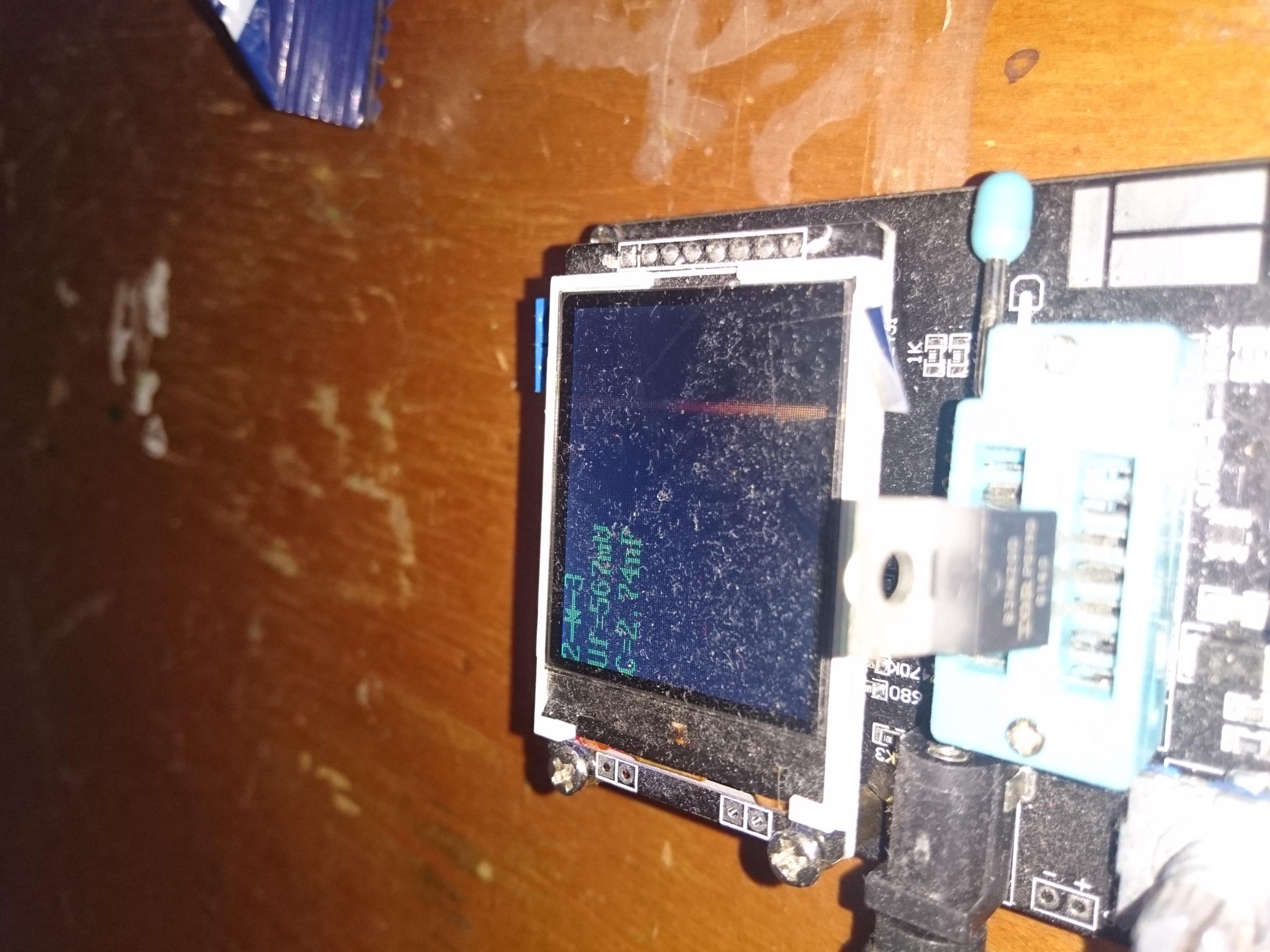

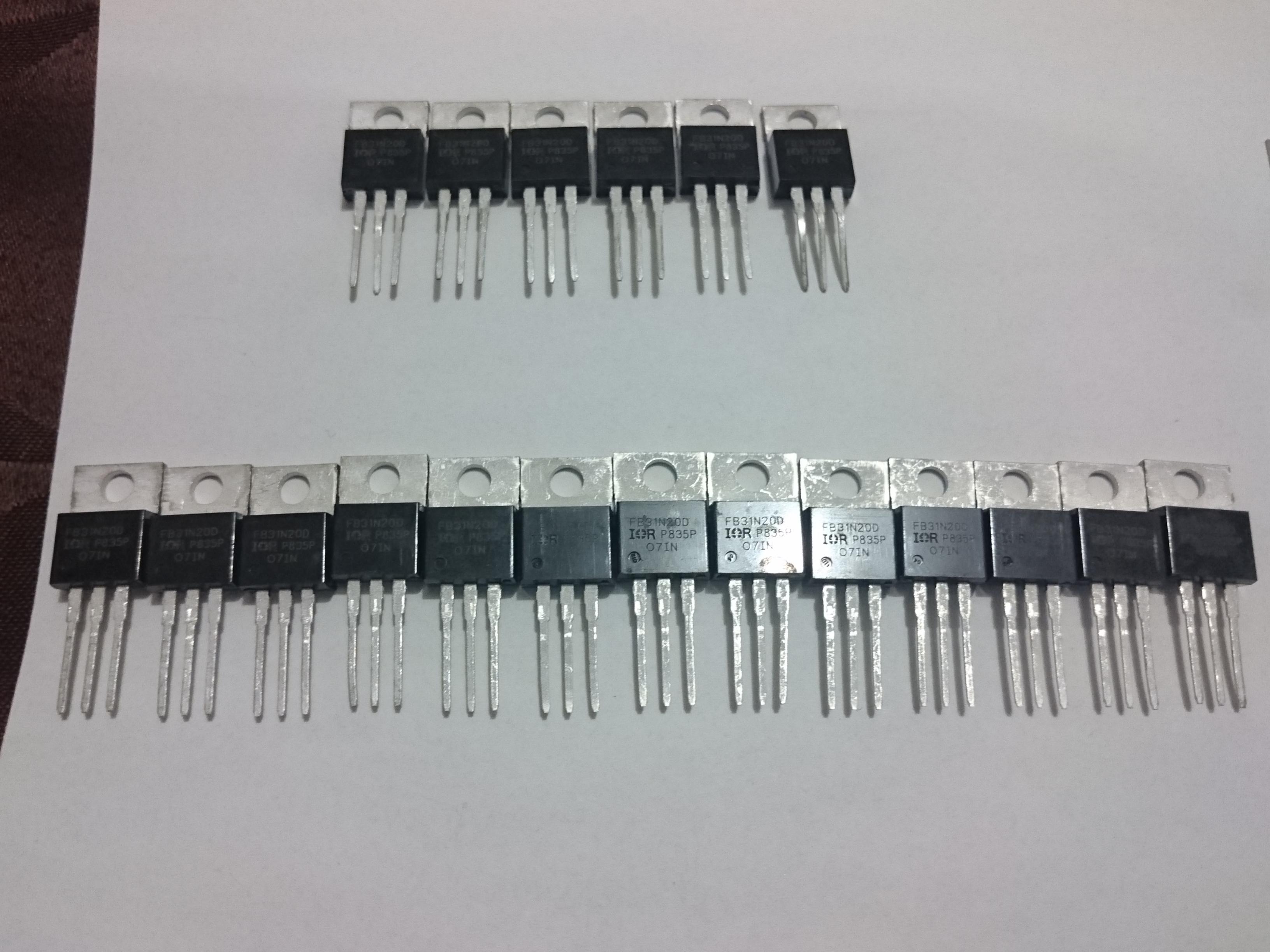

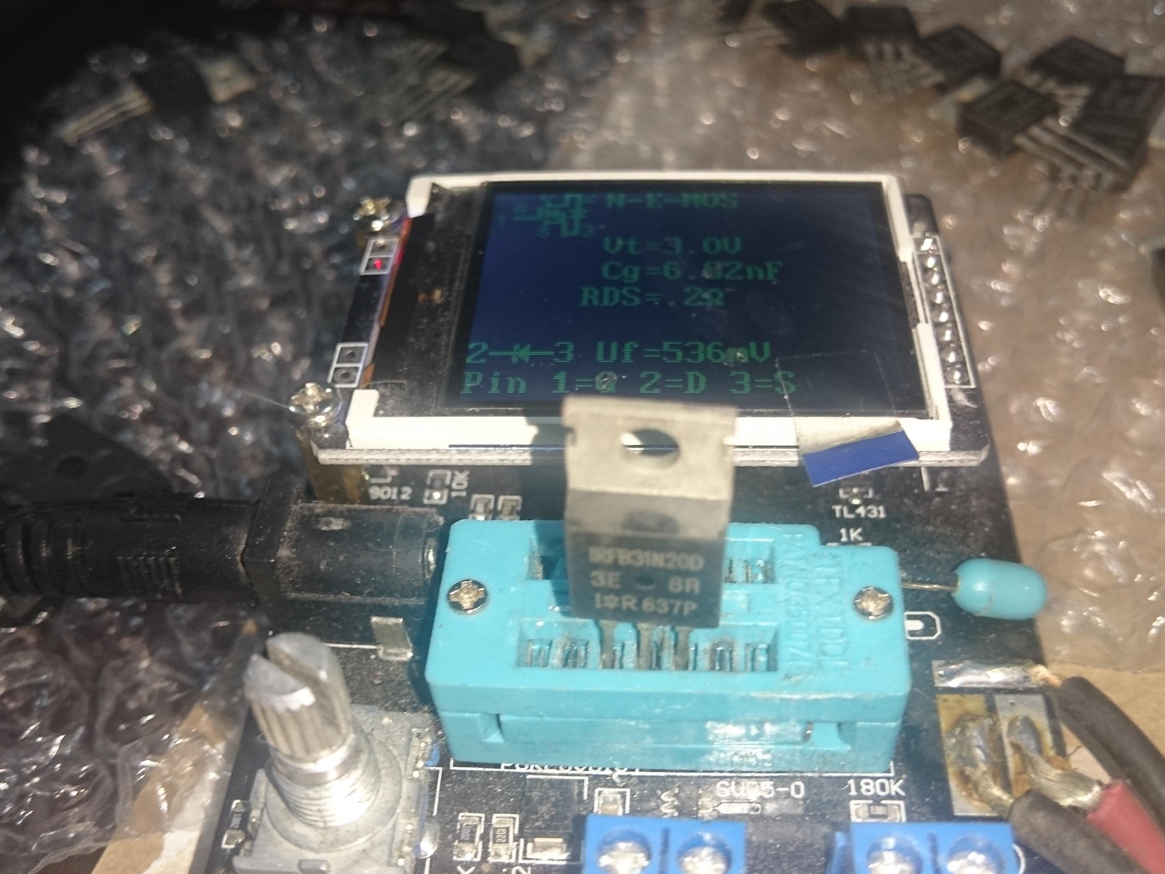

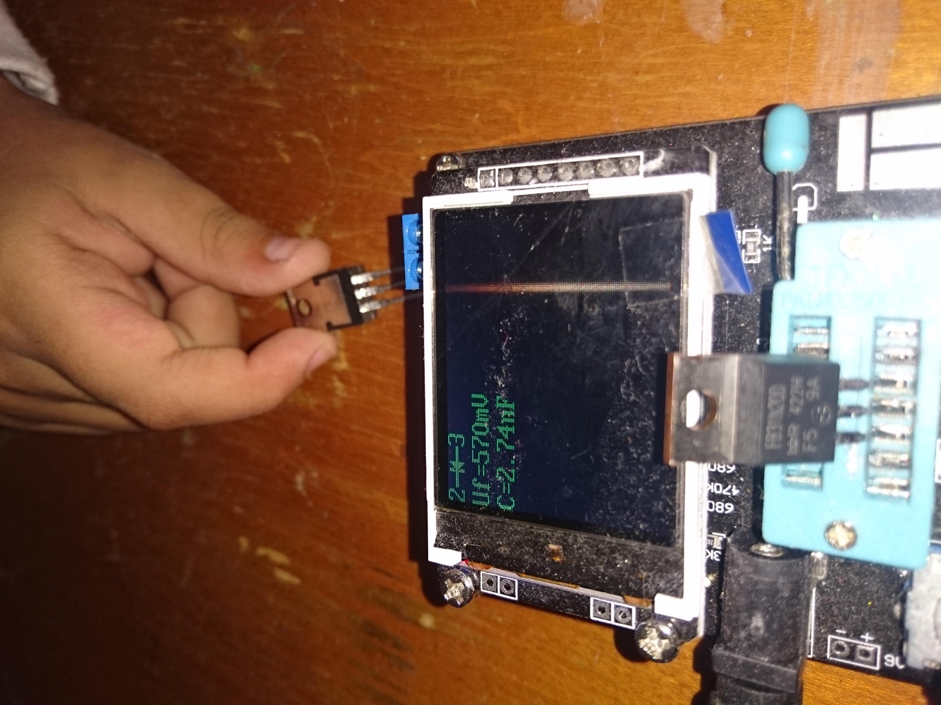

I installed the New mosfets an this gets hot like the used ones, i turned the amp off when the positive mosfet reached 60 Celsius without clamped to amp, the negative rail mosfet Was about 4 degrees cooler, could this diference in temperature be a clue of what the problem is?
I Was thinking in trace the audio path, an see if the dirtortion is produced in the driver board or Back in the other circuit with op amps jrc4558, in part the fast heating of Fb31n20d could be the excesive distortion or not?

Now that i have a clear and nice sound, the 2 output mosfets installed keep heating the same, but now i'm going to install all 12. Fb31n20d and monitor if the heating is equal i Was thinking in clamping the mosfets and monitor the total current consumed @ 12 volts.
