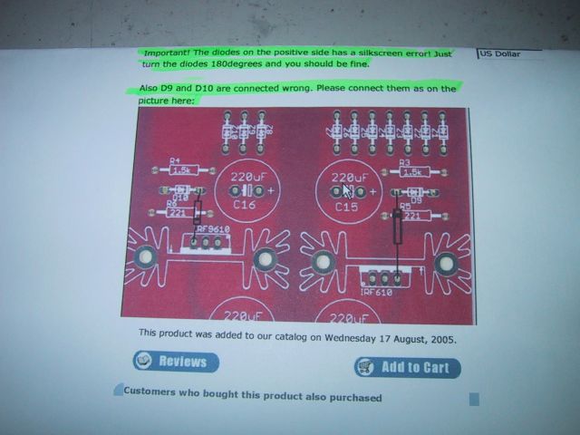

Yep, I quote: Important! The diodes on the positive side has a silkscreen error! Just turn the diodes 180degrees and you should be fine.There was an error with the diodes in the PS.
Also D9 and D10 are connected wrong. Please connect them as the picture here:
I just took a pic of the pic from Kari's homepage😀 Hope you can see it🙂 Luckily enough, I did print it out, when the homepage was still running🙂 Here you go🙂 Hope this is the answer!
Steen😎
Sorry if this is the problem, I took it for granted, that you knew about it!
