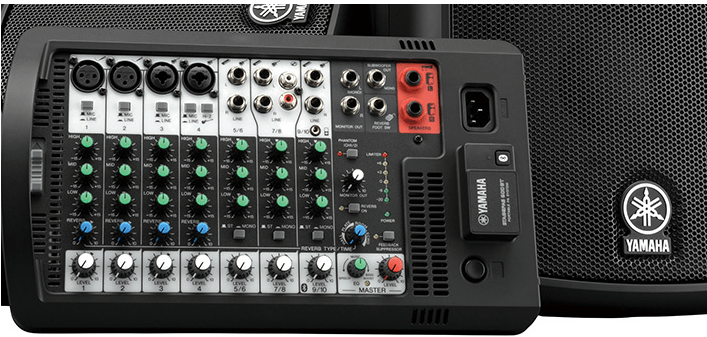

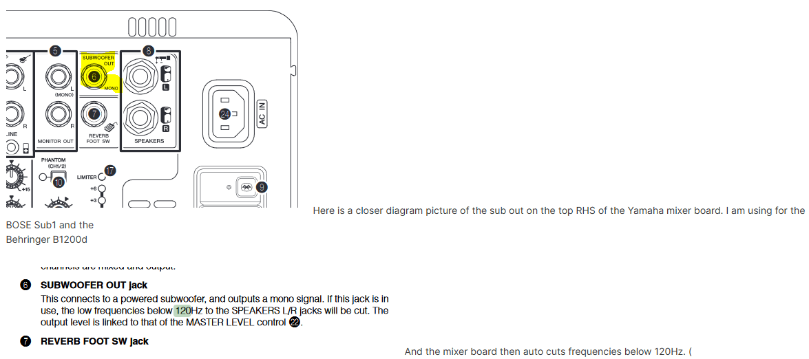

By the way, I connected both subs to the "sub out" on the Yamaha mixer board ( one at a time), as the top speaker boxes are passive, and must connect to the mixer board for power. I can then match the Behringer sub cut off to the Yamaha's mixer board 120hz cut off, but cannot do the same for the BOSE Sub 1 as it has no variable cut control - it is expecting a BOSE S1 Pro or L1 system for mid/upper range. As a result, I do not run the Yamaha Stagepass top boxes through the subs like normal powered top boxes - which means any DSP signal processing or cut off from the sub is not used in the top boxes.
