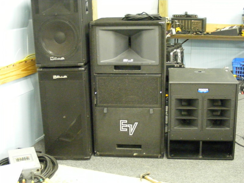

The depth of the plenum means it should be crossed at 250hz or so.
In the late 80's Electro-Voice marketed a PPSL that they crossed at 800hz to a pair of DH1 compression drivers. The response got a little bumpy from 300hz~800hz. With the DSP available today you could probably make it work OK.
http://r.search.yahoo.com/_ylt=A0LEVvtmknpY.akAqm0nnIlQ;_ylu=X3oDMTByOHZyb21tBGNvbG8DYmYxBHBvcwMxBHZ0aWQDBHNlYwNzcg--/RV=2/RE=1484456679/RO=10/RU=http%3a%2f%2fwww.electrovoice.com%2fdownloadfile.php%3fi%3d971684/RK=0/RS=lG5gBPDIWh_Bl_G.GNklGI2lAjE-
I think you can see why I suggest no more than 250hz, although the peaks and dips are no more than about ±3dB over the midrange.
A LR24 requires the woofer to be -6dB at the crossover point, so we should be OK with 250hz.
The 3FE25 will also be -6dB down at the crossover point with the LR24, they should like that.
I would play around with adding a touch of EQ and try a 300hz crossover if you like, it will probably work OK.
There is not a lot of added stress going from 300hz down to 250 hz in any event.

the mth stuff ain't small i do beleive this is the stuff DJKwas referencing
and yes i've seen people do exactly that cross that sub to a dh1 horn no mid and think it sounded ok me not so much.
oops same technology larger scale than the mts1 my bad!
the rig in the previous post "pic" was crossed at 200 and between 1.5 and 2.5 k depending on choice of high frequency horn/driver combo.
Thanks djk
Am I right here
The bottom half of the EV is the PPSL section I need and should allow me to cross over at a -6db point around 250Hz. Similarly my tower should hopefully be at -6db at around the same freq. Do I adjust this to 'smooth out' the any peak/dip at the xover point, my brain tells me two speakers operating in the same region can amplify or attenuate depending on phase.

I ran a plot on the 3FE25.
With 24 in a box they would be x-max limited at 200hz on a sine wave with 480W RMS input.
In reality, this would not be an issue as the signal from the crossover would be 6dB down around 250hz or so.
It looks as if one PPSL with 1.2KW has enough output to keep up with a pair of tops, a pair might be overkill.

Most of what I've learned have been learned through these forums or my own experience. Stick around. 🙂
The 3K figure is the amount of power the amps will be delivering if you drove up to clipping. The NU6000 will do 2KW/ch into 4ohm, 1.2KW/ch into 8ohm. The 10"s are 8ohm, wired in parallel to channel 1, so that's 2KW between them. The 8ohm HF is on the other channel, so will get about 1KW. The active crossover takes care of relative levels etc, though IIRC I've got 8dB of attenuation on the HF amplifier channel. I run the volume knobs wide open and control volume from my mixing desk. Those power figures are per side - I drop one NU6000DSP behind each speaker, run a short 4-core cable between the amp and speaker, and then send XLR and power.
Regarding excursion,
SPL is a function of frequency, cone area, and excursion. If you multiply cone excursion by cone area, you've got the volume of air the cone is moving. When you get to big subs, the Vd (Volume displaced) figure is important. Car audio and home theatre enthusiasts often compare their systems on this figure. Anyway, I tend not to do the maths there - I keep cone area and excursion seperate.
So lets say I'm comparing a 12" driver and an 18" driver. The 12" has pretty much exactly half the cone area as the 18". So, if you want to make the same noise with each, the 12" has to have twice the linear excursion of the 18". You could also use 2x 12" with the same excursion. If you go down an octave, you need 12dB more output. A double of excursion gives 6dB more output, so going down an octave needs 4x excursion (two doubles). Doubling cone area is like doubling cone excursion, +6dB.
So lets say you've got an 18" driver giving 90dB at 40Hz. A single 12" driver would have to move twice as much to give the same SPL. A single 12" driver at 80Hz would have to move half as much.
Piston Excursion calculator
In the example of the 10"s...
According to my sims, at 90v input the cone excursion on the 10"s reaches 9mm one-way at 110Hz. It's going to be a pretty serious 3" driver to match that, but, as we've seen earlier, you can take the crossover up and get some of that back.
Lets talk 1 for 1 for now, and then change the crossover frequency and see what's what.
We'll call it 100Hz to keep the numbers easy.
Our model 3" driver has 3mm one-way travel, and you need 12 of them to match the cone area of a single 10". So, to get the same volume displacement as 1x10", you need 36 of them (or, 12 of them running at 9mm excursion). I had 2x10" a side, so that's 72 of those Visaton units if you want to match the SPL of those 10"s at 100Hz.
If you take it up to 200Hz instead, you gain 12dB of SPL. That's the same as two doubles of cone area!
So, 1/4 of 72 is now 18x 3" drivers. That's more sensible. Playing around with the caliculator linked above will confirm this - 18x 3" drivers at 200Hz and 3mm excursion will match 2x10" drivers at 100Hz and 9mm excursion.
If you're happy to take a 6dB penalty on SPL, you can use 9x 3" drivers with a 200Hz crossover and get something pretty respectable.
All you need to do is ensure your drivers will reach the excursion required at the crossover frequency without burning up. You won't get them to hit Xmax at 1kHz, but 200Hz will probably be possible.
HTH
Chris
