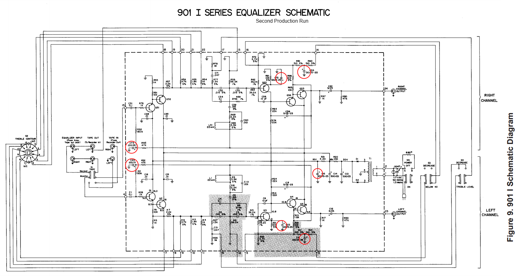

S-I EQ
The last I did for now, is changing the 8 ceramic capacitors in the supply lines of ICs, with WIMA MKS. Just a theoretical improvement, nothing noticeable.
But let me leave a side S4 EQ, for a moment.
The problem is, the system S1 EQ/S2 speakers, become to sound worst, comparing to S4EQ/ S3 speakers. The voices are not so clear, miss some details. I'm 90% confident, the reason is not in drivers.
Well, please help me to analyze the scheme of S1 EQ. And try to find together, the reason of that sound.
My few points of supposed reasons are:
1. The topology of scheme, and feedbacks?
2. The type of resistors - carbon ?
3. The unchanged film capacitors in RCR and CRC groups?
4. The type, brand, of transistors used. May they exert such influence on sound quality?
So, what are your suppositions and advices? How to begin?

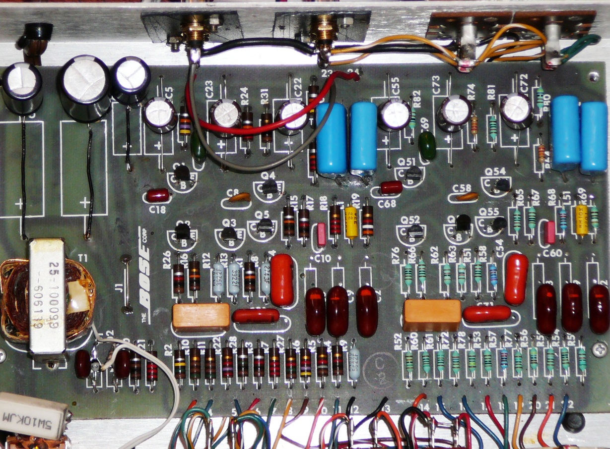

EQ S1
So, I did and the last step for now.
Spent a few $ and hours, and changed all carbon resistors with new metal-films. In 2 steps. First only one channel, for comparing, next and the other.
The expecting difference is fact.
Sound become clean, sharp, more dynamic.
Yes, the carbon capacitors sounded soft, but for me this softness = dullness.
Now this cleanness is comparable to cleanness of S4 EQ.
And something else. The bass changed. Become more fundamental and deeper. Before under 40Hz was empty, now frequencies about 30Hz are noticeable. With analyzer, too.
In conclusion, what to say?
If some of you is going to renew his old EQ S1-2, the first things to change are capacitors. And next the carbon resistors. And you'll find your 901s in new light.
May be, someone'll feel the new sound a little sharp. But for me it isn't problem. I simply turned 2 points backward the ton-control knob.
If I can use figurative language, it is same, as to look out of well-washed widow.😱

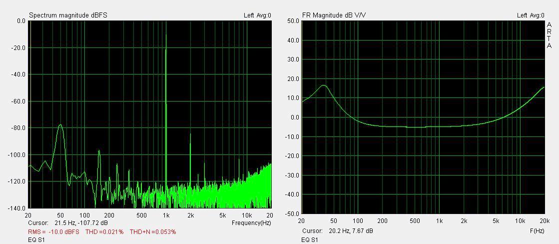

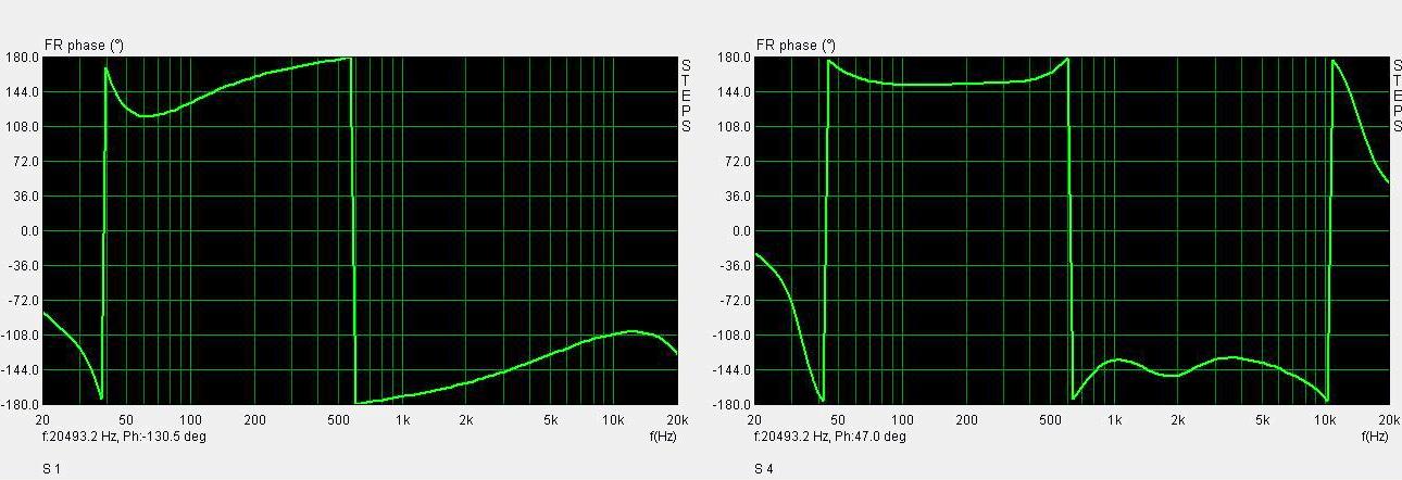

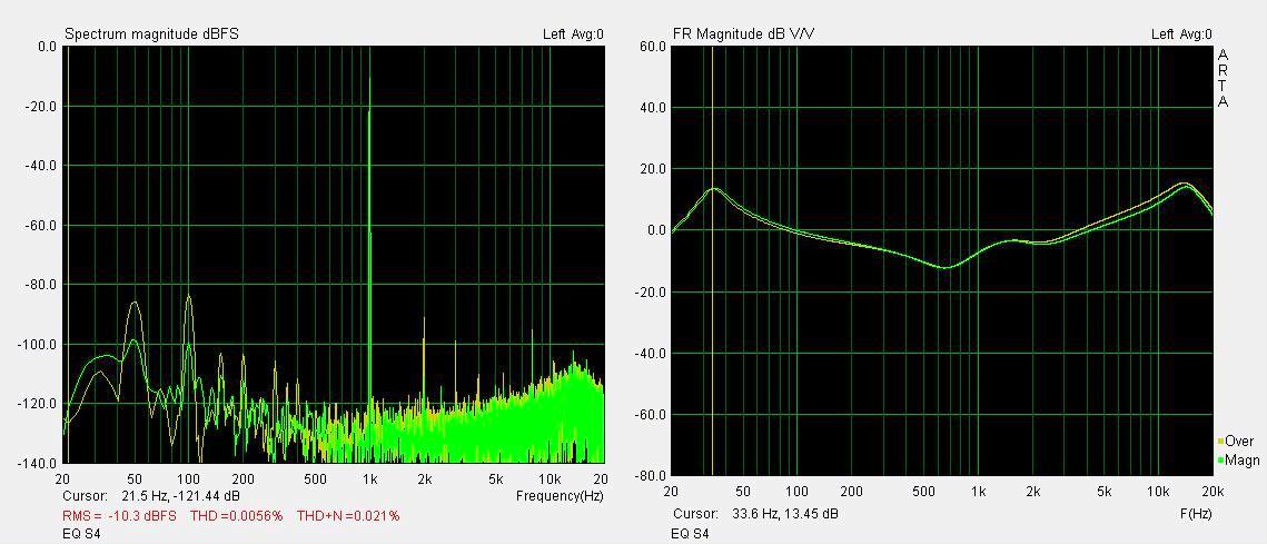

Well, now a little measurements.
Here you can see the real-life diagrams.
What is my comment? Obviously the S1 is more noisy.
My big regret is, I didn't measure the S1 before the changes, and after every step.
For EQ S4, you can see 2 lines. The yellow is EQ in original shape. The green is with NE5532 and refreshed capacitors.

I just now show the real frequency curves of the EQs. They are very close to the curves in the service manuals. You can work with them.Could one just use a miniDSP to do the EQ and skip the Bose analog EQ completely? Are the EQ curves well-known?.
Is the noise audible with the EQ in the circuit?
No, there is no hearing noise. The main noise level is under 100dB. Eh, well, if I fully open the volume of my 150W amp, without no records, I hear some noises.
A little problem I see with S1 50 Hz. Must work on it. You see, moded S4 is with better result at 50Hz.
And again, the most important. The first 4 series are very sensitive to level of the input signal. Increasing it over 0.5V, and noise and distortions increase dramatically.
