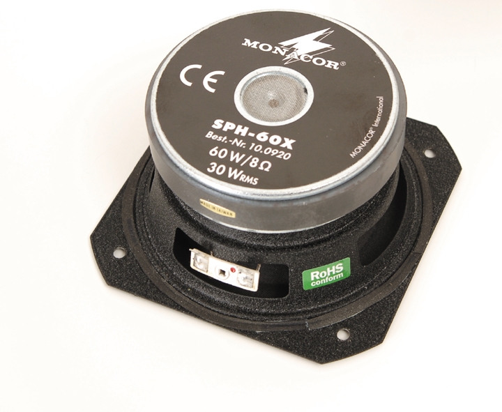

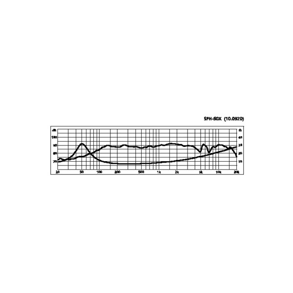

I am looking for a diy project with cheap but good quality full range transducers with the same design goals than by the 901, but higher quality. Where I can find such projects (maybe here on diyaudio?).
Some examples of Chassis are follow:
SP-200X (for very large "901")
MCT PROFI SHOP (SPH-60X, not available in u.k.)

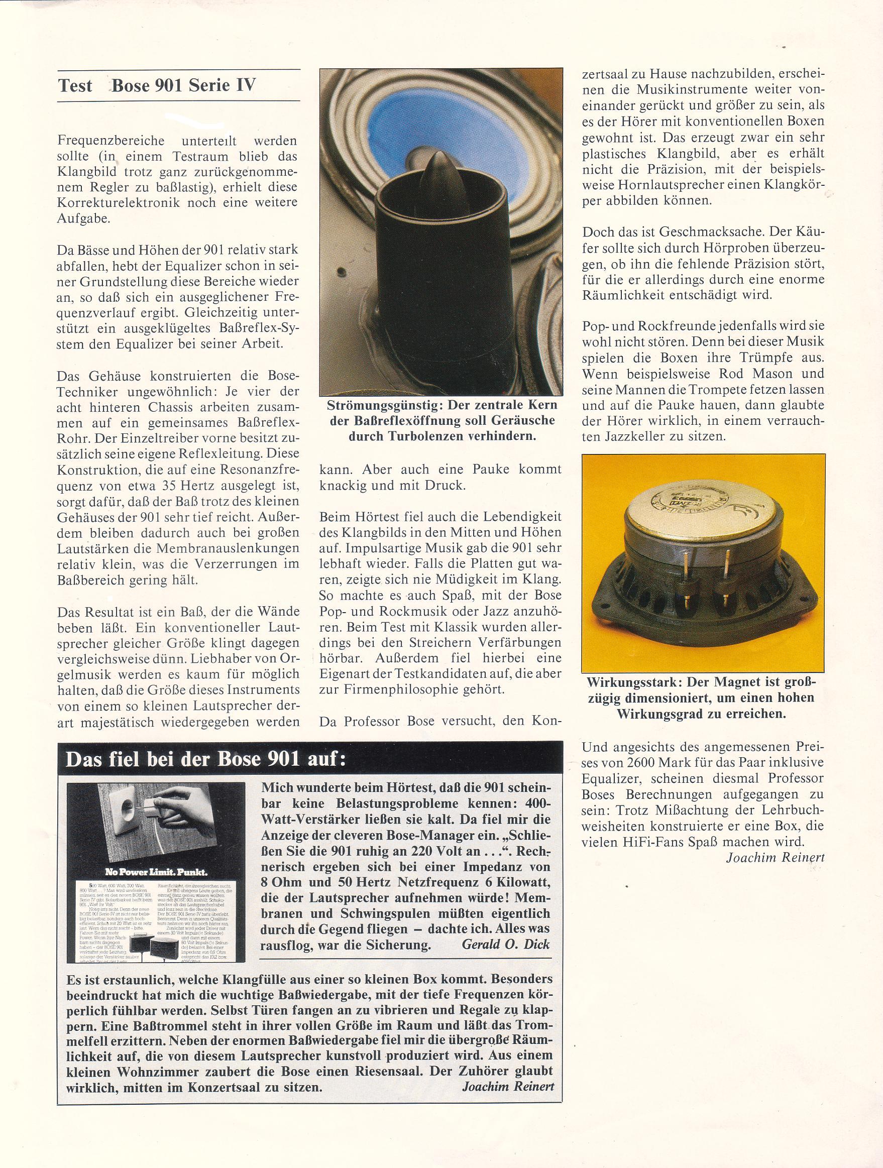

Are those two vents (ports) on the left and right sides in the 3rd photo posted by the OP in his first message? If so, I was wondering if the shape is just cosmetic to look cool, or did Bose at the time engineer a special kind of vent? If the two tubular shaped parts aren't vents, then what are they?
^ yep they're vents, along with the smaller but identical version for the single front-mounted driver. The tapered rod located in the center of the vent is designed to decrease air turbulence at high volume levels. When I used to sell audio in the early 90s, I remember placing my hand near one of them while some bass-heavy music was turned up particularly loud and the air rushing out felt like a (heat-less) hair dryer. 🙂
I guess no subs at the time (commercial gimmick like now) in the 70's & 80's, from what I remember, or LFE for the same effect.😀^ yep they're vents, along with the smaller but identical version for the single front-mounted driver. The tapered rod located in the center of the vent is designed to decrease air turbulence at high volume levels. When I used to sell audio in the early 90s, I remember placing my hand near one of them while some bass-heavy music was turned up particularly loud and the air rushing out felt like a (heat-less) hair dryer. 🙂

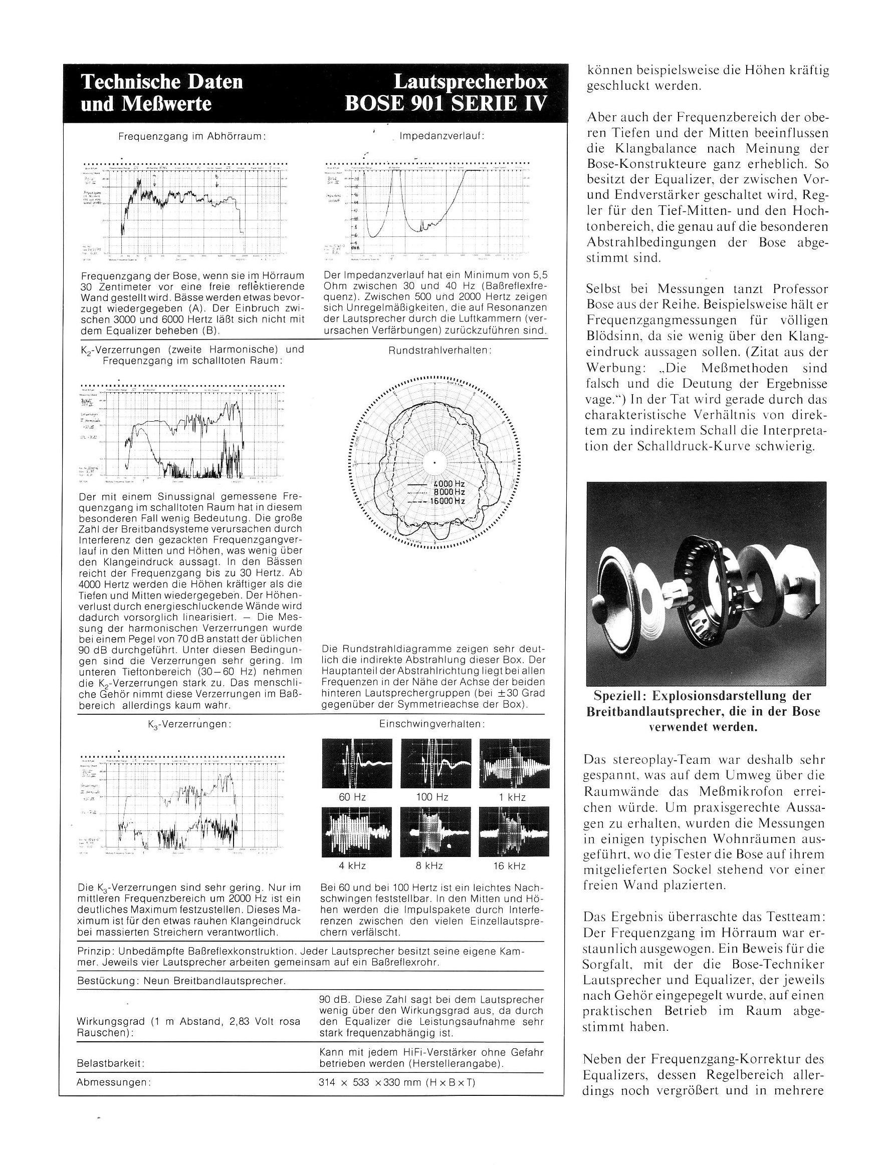

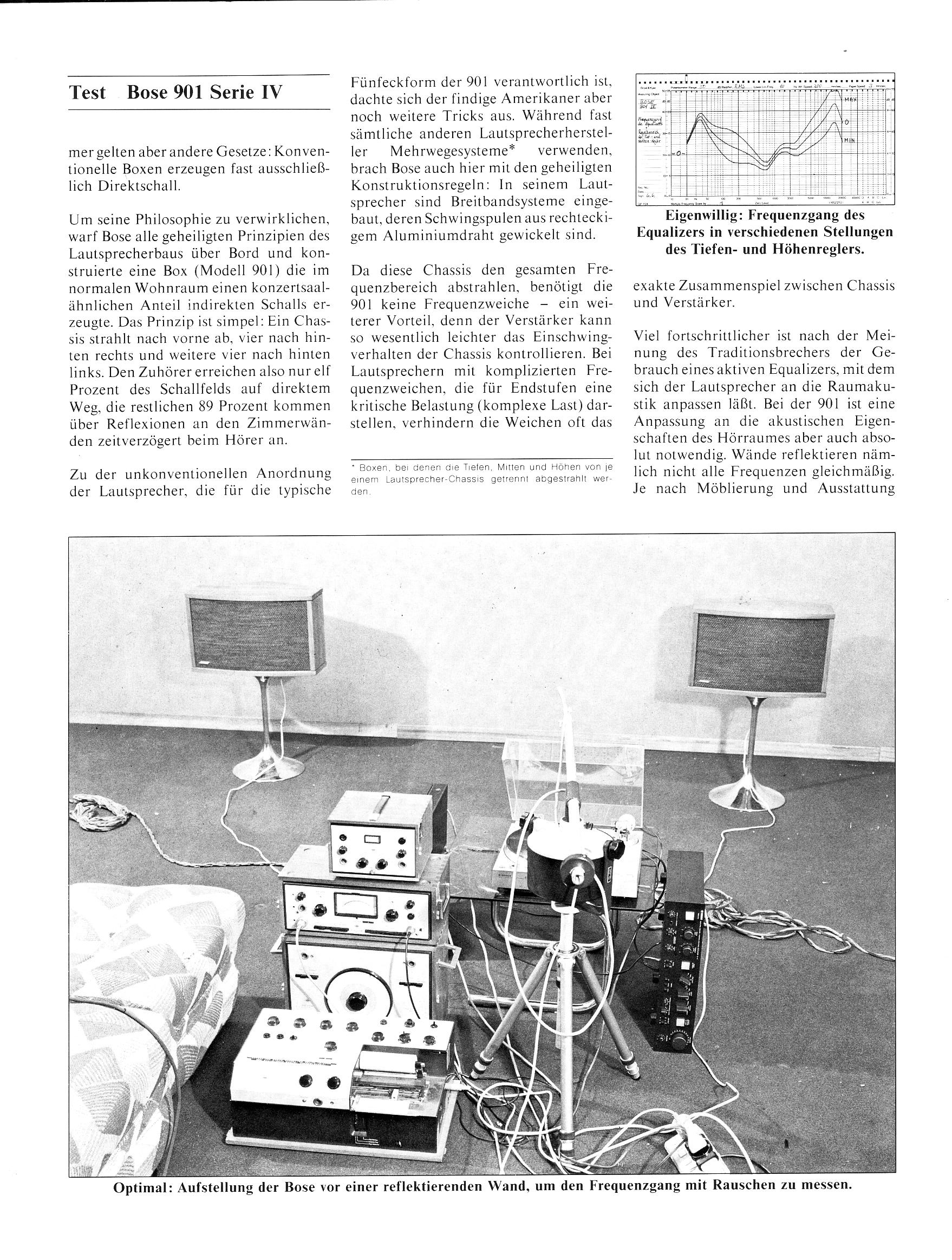

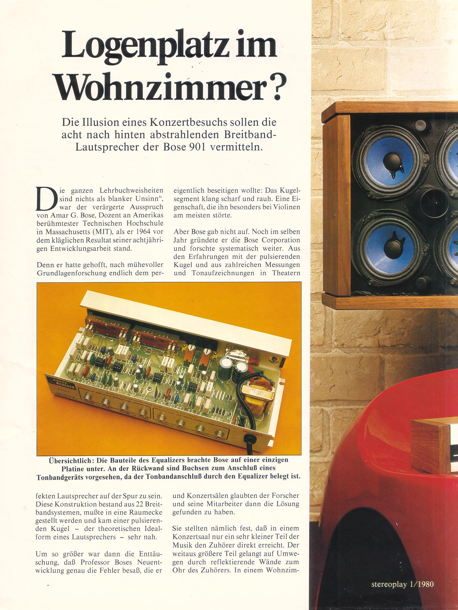

If anyone's interested, in the near future an online audiophile magazine will be testing the current version of the 901. Read about it, and the audiophile indignation 😀, here.
Which one? that would be interesting, a magazine that will not be afraid of being sued by Bose, that is.
Joke aside, it took me long time to get to a speaker that was good enough to replace them.
With the help of online translator, I understud more or less what they tolking about. But will be very grateful if somebody from Germany translate it for us. Not all, just the most essenial passages.
Here you are the same feature, but with digitalized from me text, for easy translation.
- Bose 901 IV serie
