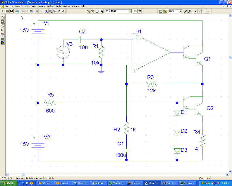

hmmmm now that one looks simple, I believe I have some 530's in my box.. that or 830's. will have to look. What is the opa? power op amp?

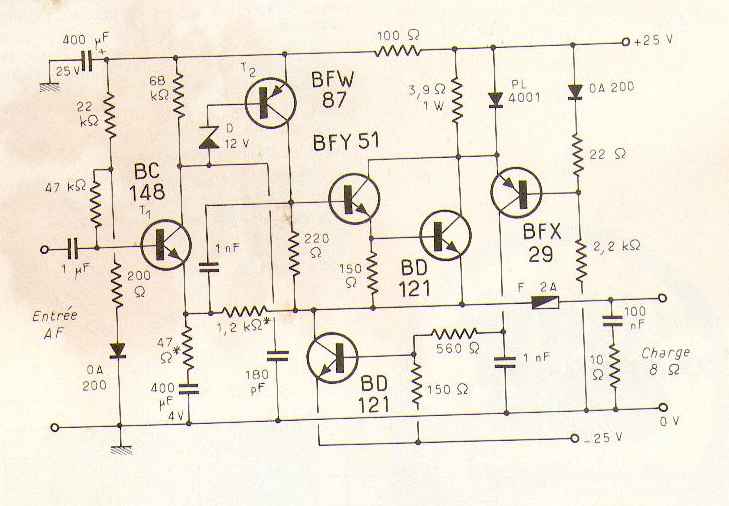

thanks for the posting re the texan circuit
the mosfet version reminds me od a crimson electric version that i used to use this would be in the late 70/early eightys
using the hitachie mosfets the beuty in this is the fact that the sp loads are on the drains on the output devices this enables them to saturate better and obtain more output than in the source follower mode
plus the drivers etc a very low cost all in all a cheap to make but a unit that will perform well
i have in the past built a version using darlingtons this produced 30 watts at a very credible 0,01% midband all for about £5 per channel excluding the psu

darkfenriz said:These parts are obsolete and it may turn out to be waste of time to build up something from these. For also very low price you will get tl07x or NE5532 op-amps, which are way better. Modern power trasistors will be probably something like 2$.
No need to use your old dirt whereas silicon costs nothing nowadays, main expense is transformer, heatsink and PCB.
