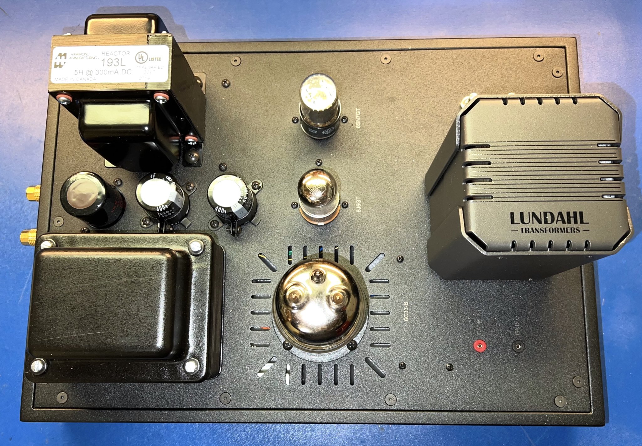

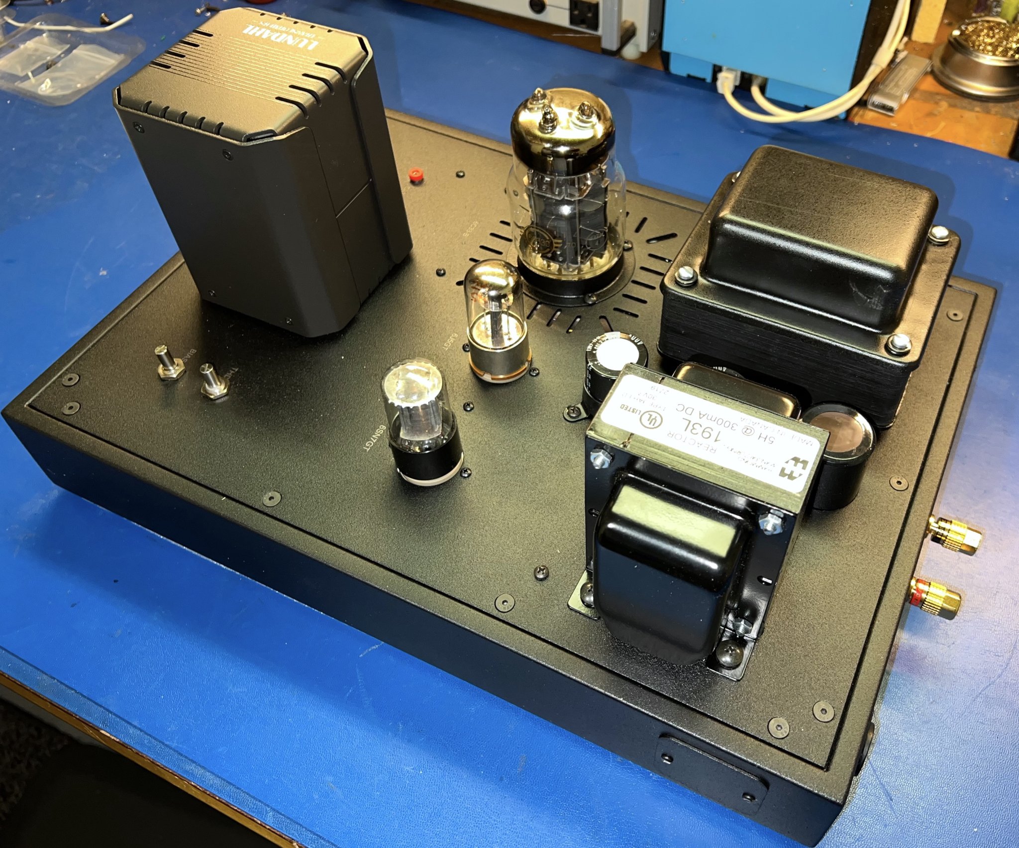

I recently completed a pair of mono blocks with Erno Borbely's 6C33C-B SE triode amp, using power transformers from Kenwood receivers and output transformers from Lundahl. I started the project more than 20 years ago. 🙂
A friend is testing one of them for me. So far it has a great square wave and produces 12.5W output across the entire 20 Hz to 20 kHz band.

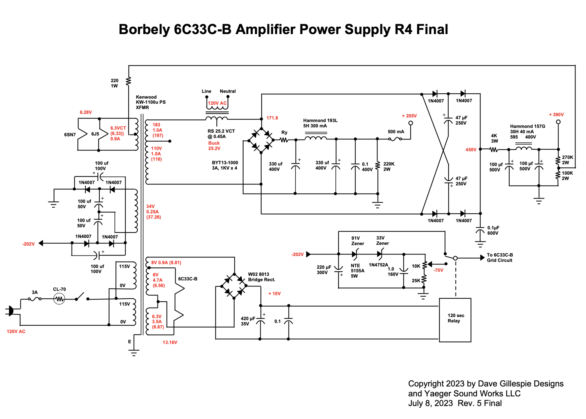

The power supply is a little funky so I have attached a schematic.

Thanks for posting. Interesting negative bias supply scheme. Can you say something about it? Any ripple / noise measurements?
Erno's original article posted below
Thanks for in including the original build article.
The negative supply is a voltage quadrupler. Most designs allow the filament(s) to heat up for about 2 minutes before applying B+. The downside is that instantaneous B+ can give a pretty big "thump" on the output. So my friend (and guru!) Dave Gillespie suggested that the bias on the 6C33C-B be held too low for the tube to conduct (that's why I needed about -200V) until the two minute interval had passed, at which time it would be dropped to about -70V.
I haven't measured ripple (or noise) on the negative supply. For that matter, I haven't looked at it on a scope yet. But given the very low grid current, I doubt it would be very much. I'm busy at the moment but will eventually get back to you with a measurement.
