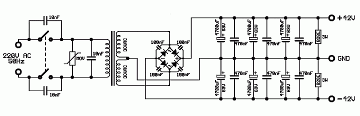

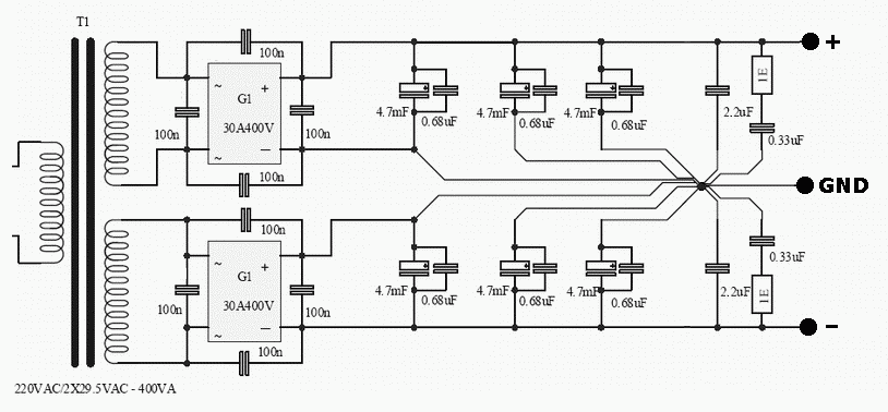

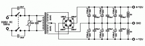

Simple... transformer, bridge rectifier, some capacitance.
I'd say 300VA transformer 30VACx2... and about 10,000uF total capacitance per rail.. i'd go with 2x6800uF per rail personally.
http://users.tpg.com.au/users/gerskine/dxamp/
Look at the PSU on this site... nice simple and effective...
