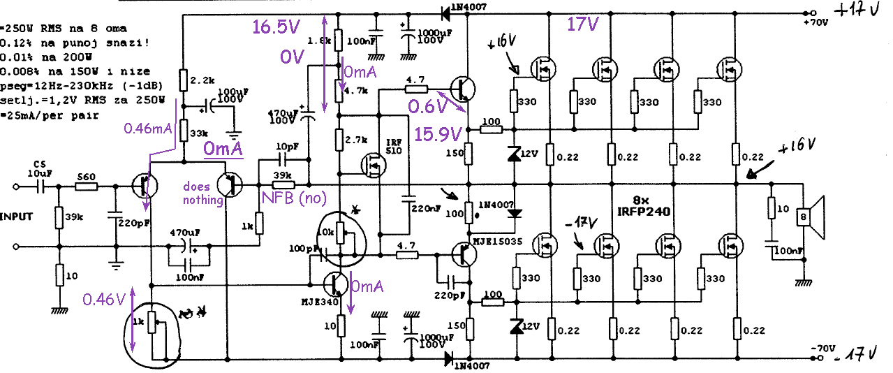

Anyone have a clue of what is going on with my preamp? I changed the "bad jfet" but it didn't work out as expected. the reason I thought it was the transistor in the first place was when I measure Vdrop over R6 and R7 I get a lot more over R7 so it looks like the corresponding JFET is pulling a lot more current than it should. I get about 30mv over R6/R7 on the working channel and in the bad channel they are R6 30mv and R7 about 80mv so over twice as much.

...R7 about 80mv....
With other values as stated, this suggests R11 has 24V across it, and guessing a 240V supply (?) that makes about ZERO across Q2.
Is that what you got? Then Q2 is shorted; probably the wiring not the actual transistor. Otherwise you have a wiring or value error.
Measuring just one voltage drop is not much clue. I like to print the plan and use a fat crayon to mark most node voltages.

I really like that you make me think for myself, but frankly I have no clue. All resistor values measure the same as working channel and I can’t find any short. Probably missing something but could you give me anything specific to look for?
