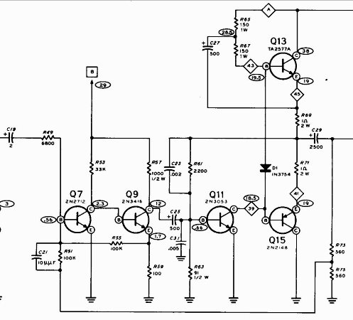

The first amp I built was bootstrapped. Five transistors, and the output PNP was a germanium drift field type. The amp was in a Heathkit AR14 receiver, 20 watts, and wow that was a fun amp, back in 1966. Copied straight from RCA Transistor Manual, I think. I'll post the silly thing.

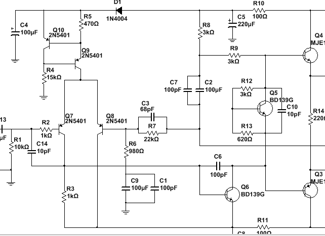

The problem I'm having with mine is if I adjust the differential pair for lowest distortion (1khz 0.05% at 150w), I have 150~200mv DC offset. If I adjust for 0 DC offset, distortion climbs to 0.09%.
Are you adjusting the LTP tail current? If you want to adjust for lowest distortion and lowest offset you should adjust the LTP collector resistance.
Make R3 trimmable instead.
C14 should go to GND, not -ve rail and should be much bigger perhaps 220p.
You have a lot of very small bypass caps that are not really needed or are too small to be effective.
C6 is probably at least twice as big as it needs to be and will have a big influence on performance. But hard to know without seeing the full circuit.
Edit: C6 is about right as a starting point. You might be able to get it down a little to 82p or 68p with experimentation.

R3 had to be reduced to 430 ohm to 0 the offset. But again, distortion is increased significantly when I remove the offset.
C6 needs to be that large or the circuit does not run smoothly in the emulator.
Output load is 4r.
Output load is 4r.

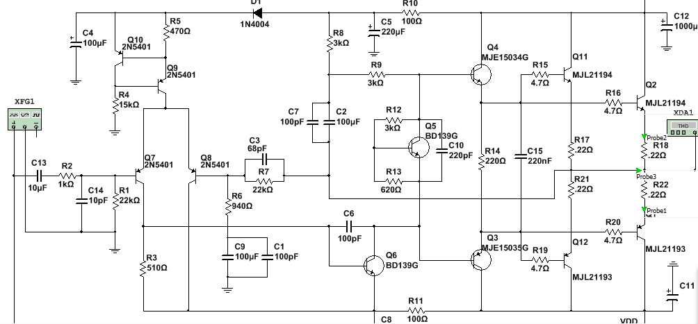

For lowest offset:
- Move R2 before R1
- Make R2 = R7 (22k ohm)
- R3 ~= 2 * R5 (so if R5 is 470 ohm then set R3 to 940 ohm and trim from there.)
Have fun.
- Move R2 before R1
Have fun.

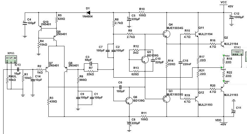

Electrically, R2 *is* at the base of Q7 on your latest schematic. You could solder one end directly to the transistor leg if you wanted to, according to that sch.
The base current drawn by Q6 plus variations in Vbe for different devices types are the reason why R3 isn't exactly double R5 for null offset. In real life you also need well matched input pairs, but simulated devices are usually identical unless you specify otherwise. But I'm supprised 510 ohm gave the best result. Have you built and tested or just simulated? Did you use good transistor models? Is the output stage turned on in your simulation? Increase R13 until there is 15 - 26mV across R18. In a real amp this would be a trimmer for fine adjustment.
C10 is too small to be useful. Its common to use a small plastic cap here (say 100n to 1u) or a small electrolytic (say 1u to 47u).
