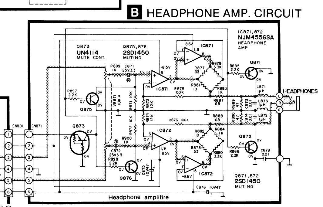

You can go safely with the classic NJM4556 op-amp with a gain of 5x...20x.Before trying anything fancy build this one and i can bet you'll really like the sound on 250 ohms cans.I have the dt880pro and i discovered this small pre in a yamaha cassette deck while monitoring some cd player...it sounds better than the usual noninverting topology with the same chip.

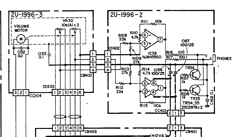

If you wanna try something out of the ordinary try this one.You can use different op-amps for the input and output op-amps and you can also use two in parallel (one full dual can like lm6172) for the output section with a 100 ohms resistor in front of each one.Both sections of LM6172 in parallel per channel will give you the possibility to drive 32 ohms cans with +-5 v supply
