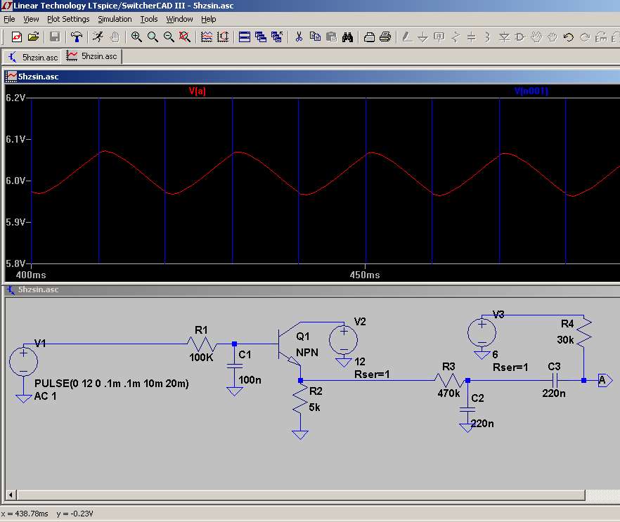

Take a look at this ... the input is a 12V square from the 4040, V2 is the supply, V3 is the TDA1519 internal bias, R4 is the TDA's 2x60k inputs in parallel. Output trace (red) will be amplified x200 (40dB x2 by bridge) by the TDA1519. Make R5 a trimpot and Bob's your uncle.

>Did you mean make R3 a trim pot?
Sorry, I mean make R2 a trimpot, with R3 connected to the wiper, to set the output voltage.

wine&dine said:Sorry, I mean make R2 a trimpot, with R3 connected to the wiper, to set the output voltage.
lol, thats what I meant I duplicated your model and switched the resistor numbers on mine, I understand the logic.

> don't drive the transformer through the regulator.
> you could over load and damage the regulator
Au contraire, use a current limiting regulator to protect the *amp*. An LM317 supplies up to 1.5A = 18W DC at 12V, allowing our little amp to put out 9W AC at 6Vrms. Plus, the '317 has thermal in addition to current limiting.
>the transformer I am using can be center tapped to ground if need be,
>but in BTL configuration, the data sheet specifies there is no need
Not only is there no "need" - the CT terminal is always at 1/2 V+ bias, connecting it to ground will create a short!
BTL means the load MUST be FLOATING.
Don't worry wine&dine, I actually haven't strayed from the design we came up with. I am half way there, I have 50.0000Hz saw tooths at the moment. Amazing precision out of a simple circuit. I am waiting for digikey to ship me some parts their automatic bin picker screwed up. I am very grateful, it is coming along very nicely!
>3 Watt synchronous AC motors don't punish.
I doubt that device's peak power input is only 3 watts. Motors have much higher power input requirements during startup. If the device has a step down transformer, its possible that the transformer loss might exceed a couple of watts alone. There isn't much wiggle room if the device need more than just 3 watts.
>Frequency is irrelevant. At 12VDC to amp, 6Vrms to trafo, efficiency is ~50%: feed 5W to the trafo (3W + losses), dissipate 5W. A lot?
Transistor conduction losses are high when they operate below saturation. For much of the cycle of the sinewave, the output transistors of the amp will be operating below saturation. thus causing significant power loss.
Whatever, dude. Maybe I am reading this wrong, but you seem to me as if this is some sort of deathmatch challege. I see your point but you don't need to be condescending about it.
