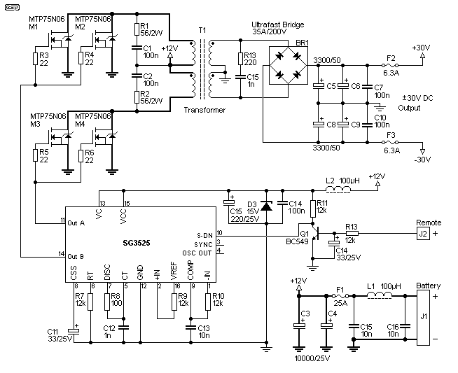

There are alot of great schematice for doing +/- DC-DC converters to run almost any size amp you want off a +12VDC source (like your car). The ESP circuit uses an SG3525AN voltage-mode PWM chip, which is VERY easy to use. (There are also several other, better chips, but the '3525 is an excellent starting block).
I have made MANY +12V DC-DC units using this controller, all with very good results. This chip can drive N-Channel MOSFETS directly, as it has a drive capability of +/- 400mA. Just add a few components for true PWM operation, and you will have a very high quality REGULATED power supply for your amps. (Better than the unregulated converters running in most of the mass-produced amps like Alpine, Kenwood, etc.)
For excellent noise isolation, try using an optocoupler (like a 4N36) to sample both the (+) and (-) outputs equally. This is alot easier to implement that one might think.
Here is a schematic for the MOSFET-based SG3525 converter, running wide-open with no feedback. If you don't need regulation, then this might do the trick. If, however, you want some regulation, try looking at schemtaice of some other DC-DCs on Elliot's Pages.

Unregulated push-pull topology allows for easily obtaining very high power outputs with a small transformer and producing little EMI. They also provide galvanic isolation to the output and require little filtering.
On the other hand, buck and boost topologies allow for regulation but require a big inductor, that must not saturate even for the highest power output, and are prone to EMI due to diode reverse recovery. Furthermore, buck converters draw a discontinuous input current, so peak current is higher than average thus increasing switch stress and requiring careful filtering, and boost converters work with discontinuous output currents, so more filtering is required.

On the other hand, 36V 10A unregulated are easily produced with a push-pull transformer, without involving discontinuous currents or much higher peak than average current values.
