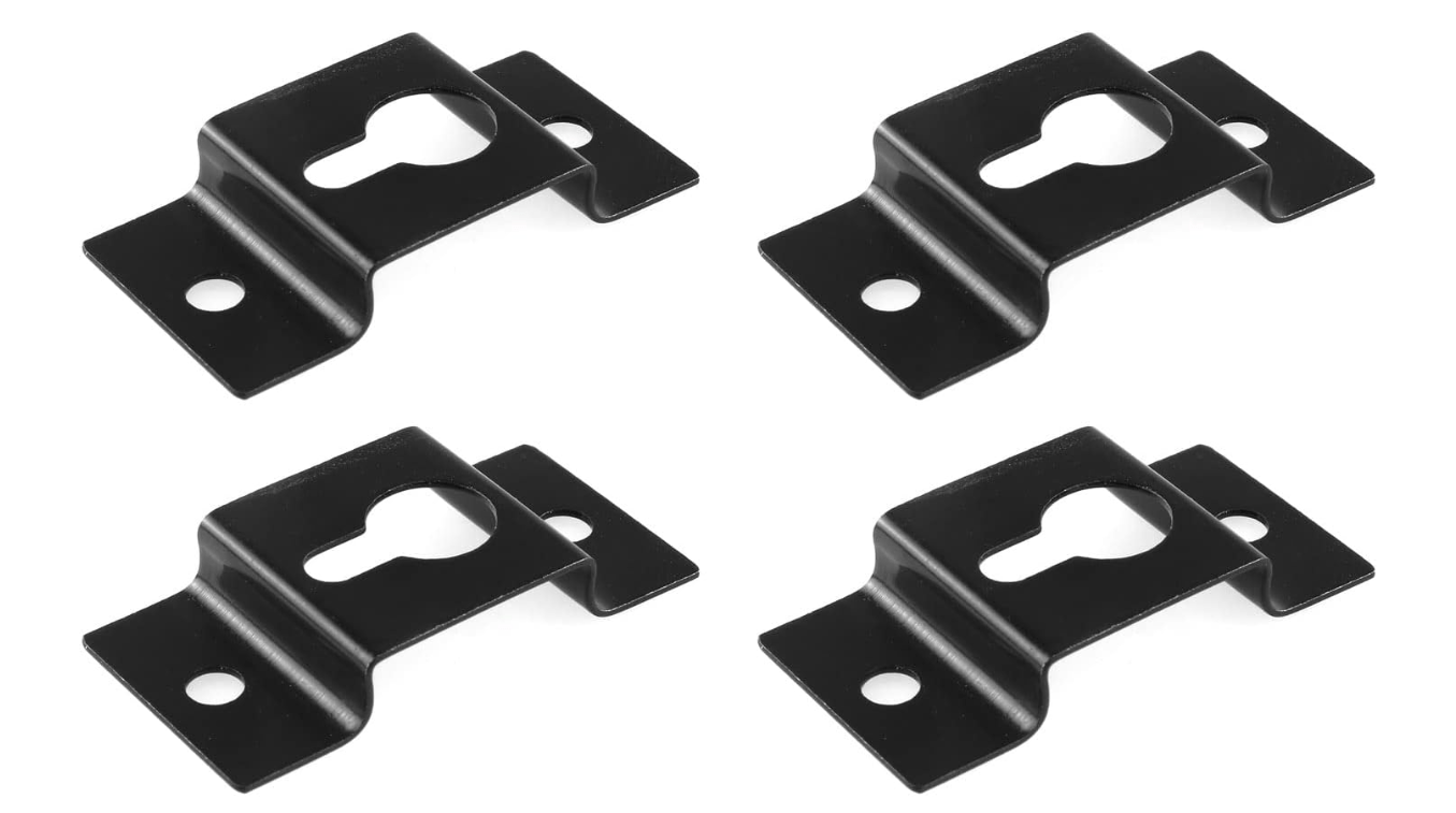

My current thoughts are a strip of 1/4" aluminum down the side of the amplifier cabinet with slip holes down the entire strip. Then a toggle latch on the top.
This is what I mean be slip holes. I would have a piece of aluminum (or maybe steel) with several of these slip holes machined into it.

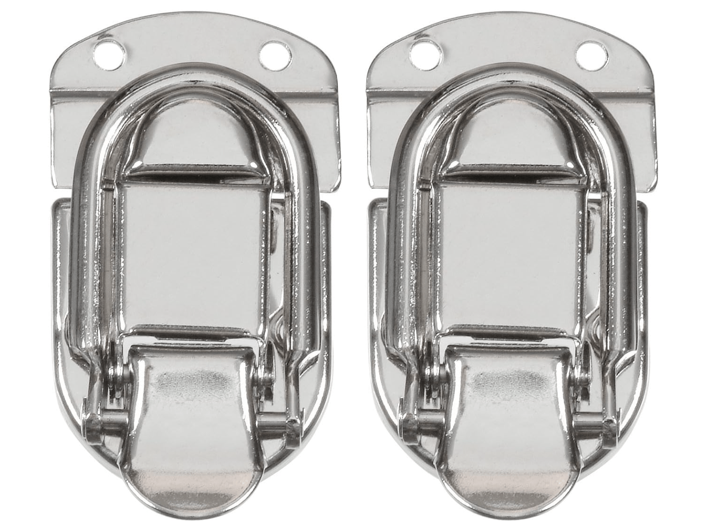

Something like this for a latch on the top:
The multiple slip holes would allow me to accommodate speakers of different heights. The right toggle latch at the top would keep the speaker from sliding up and off the slip hole.

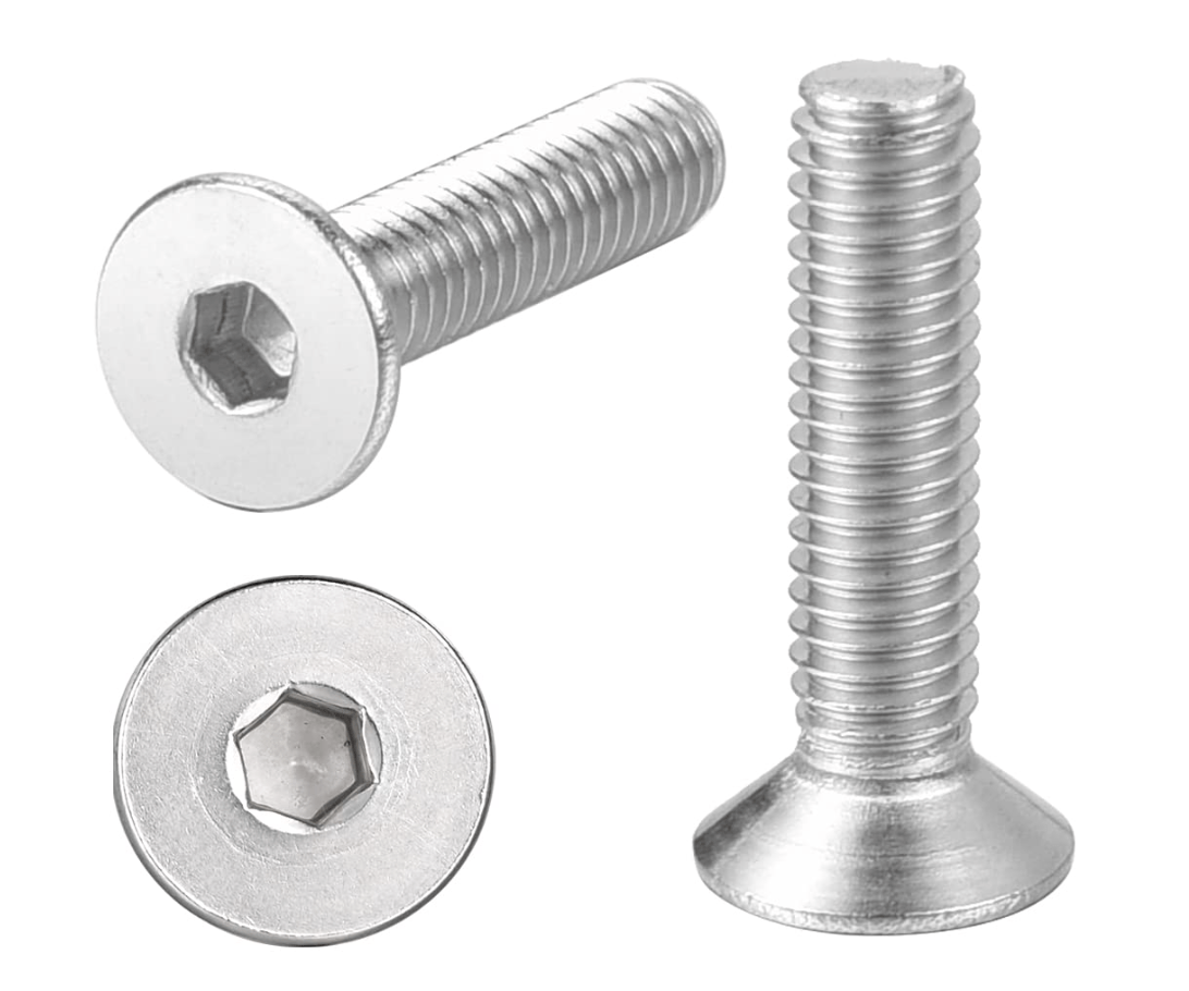

Hmmm... 1/4" thick aluminum plate with slip holes milled into it would make the aluminum no more than 1/8" thick where it holds the stud from the speaker. Will that be strong enough?
Edit: If I used a countersink head bolt as the stud on the speaker and champered the back of the slip hole plate aluminum should be plenty strong.

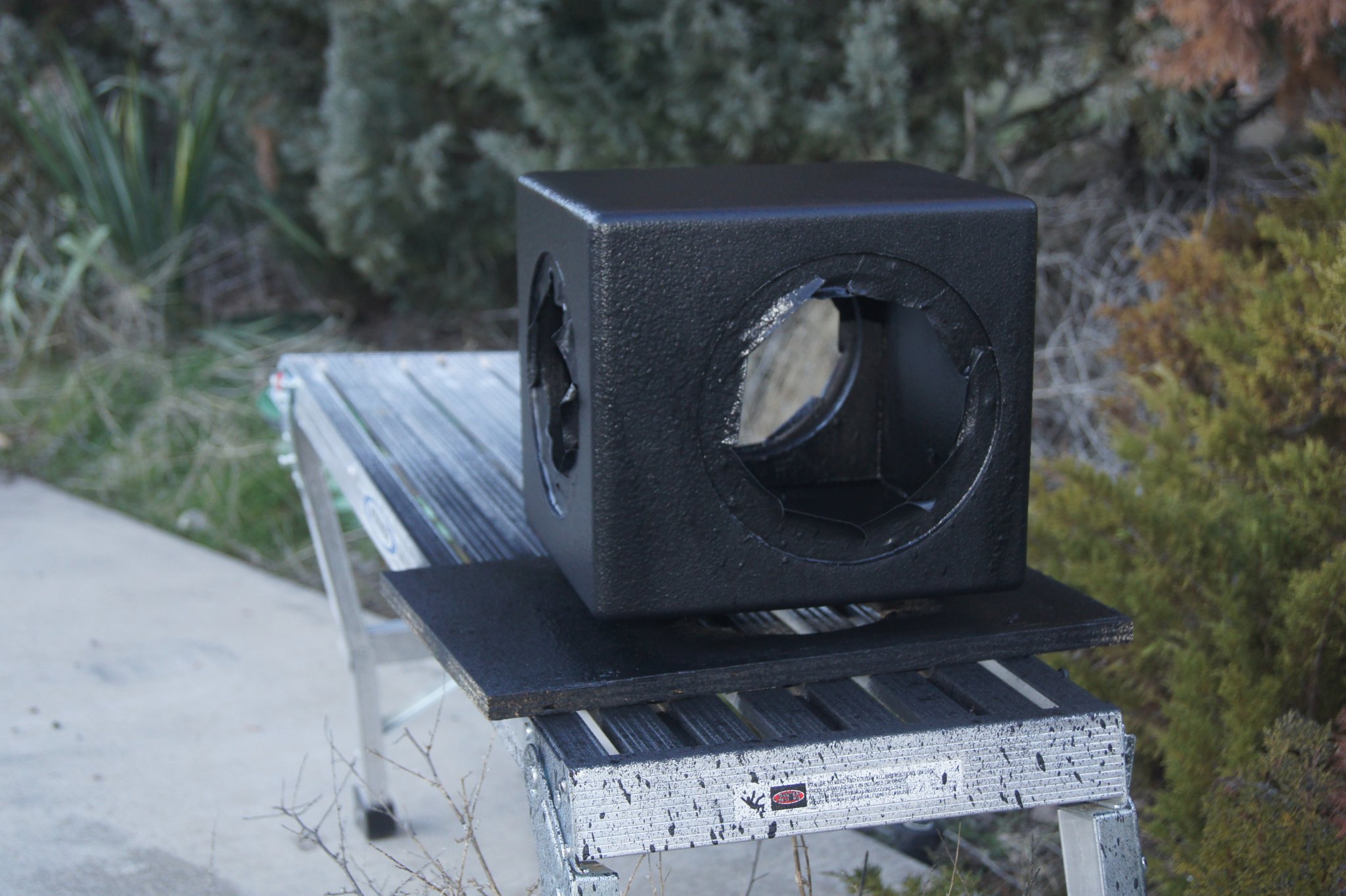

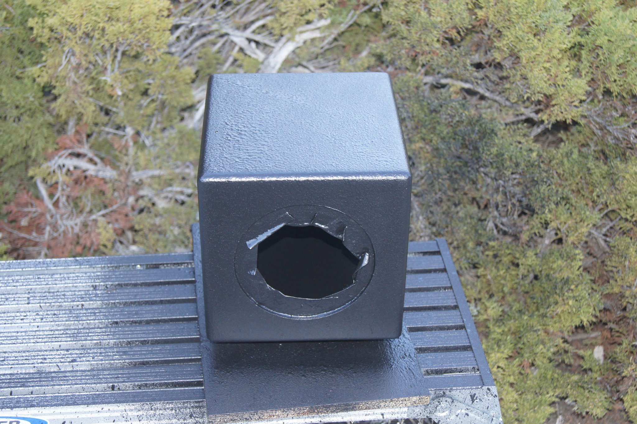

Here is a picture of my mini-sub box:
with a fresh heavy coat of Rustoleum bed liner spray. I am using a TangBang 5 1/4" sub driver and two 6 1/2" passive radiators. It doesn't give me massive thumping sound but it does give me very nice tight controlled bass which merges very nicely with my bookshelf speakers. Tight bass is what I was after.
