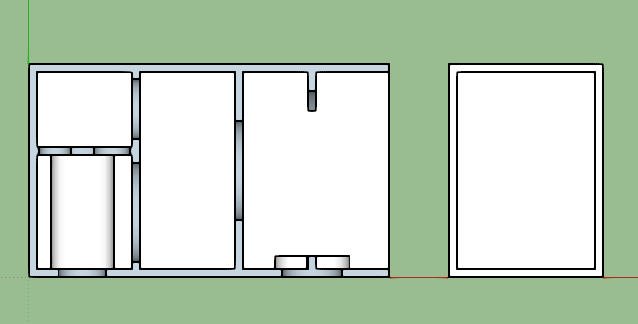

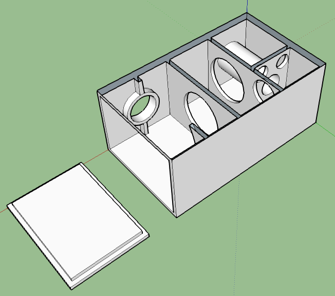

It's interesting to see horn-loaded 4th order BP designs are scoring the top marks here. I'm wondering though how much gain the "horn" section is actually providing. 1/4 wavelength @ 300 Hz is around 27.5 cm, so the path of the horn would have to be at least that long and the mouth would have to a bit larger than given in that design. What that "horn" might be actually doing is amplifying any harmonic distortion related to the fundamentals that the driver is trying to produce within the passband being tested. A slot-loaded bandpass design might actually produce better results (a lot less amplification of any distortion). An offset-driver slot-loaded bandpass design (to null out the first harmonic resonance) might perform even better.episode 8 is out; a Fibonacci spiral shaped front loaded horn / 4th order bandpass ties for first place with the half wicked one (~half a db louder or quieter than the hwo, depending on door open or closed):

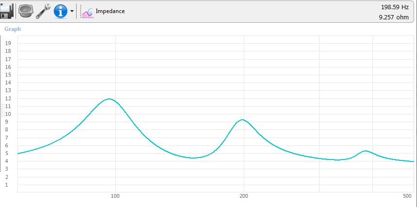

Oh, concerning the impedance curves, I've found DATS isn't so great at giving a detailed view of the impedance - I think the data loses a bit of detail due to the amount of sample points DATS uses. I did get the DATS hardware to work with REW at one point, and REW's impedance measurement routines can provide a lot more detail (those little bumps you're seeing at 600 Hz and above will become a lot more visible). I'll see if I can get it working again, then provide the details here.
Another thing I'd like to have seen in the tests is the response of the D.U.T. to a sine sweep done at various levels until the THD exceeded a known amount, e.g. 20%. All well and nice that the designs can provide high output levels, but if they sound like a** when doing so... 🙂.
Well, it turned out to be easier than I thought. Here are the steps.
1. Connect the DATS v3 device to the PC
2. Open REW,select the "Preferences" menu option, and set the I/O Preferences as follows:
3. Select "Measure" and then the "Imedance" option, and then set Rsense to 100 Ohms and proceed through the calibration procedures. When performing the "Reference Cal", set RREF to 1000 Ohms.
...and that's it! You can now use REW to do impedance measurements with the DATS v3 software.
As per the author, DATS uses the impedance curve to guess the parameters instead of directly measuring the 3 relavant points. Thusly has a large margin of error.
dave
I don't think the approach used by the DATS software would necessarily lead to a large margin of error. Quite likely it's just using a software model of the driver and then doing a curve fit to see what parameters give the closest match between a computed impedance curve and the measured impedance curve. I've compared the DATS results to those computed by the semi-inductance parameter workbook shared by Stephen Bolser, and there's usually pretty good agreement, unless Le/Re is REALLY high...

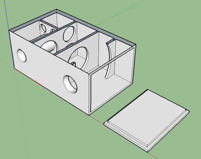

BPs are 2 for 2! I'm surprised of the arch throat. I would have kept it the height of the horn path.
The adjustable compression chamber reminds me of a trombone...hence, bandpass HORN!

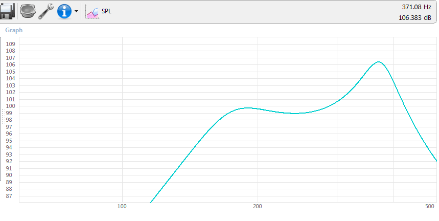

Also, the responses of the designs that he's tested so far are noticeably non-flat. The driver has a fairly high Qts, so there's going to be a fairly large peak in the response around the resonance frequency of any of the vented or high order designs.

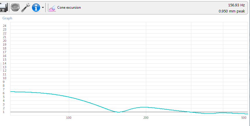

I suspect the "extra sound" is being caused by the horn amplifying any distortion being generated by the driver, so it's not necessarily being caused by the restriction at the throat. That driver has a fairly low Xmax, and it's behaviour during high excursion suggests an asymmetric BL curve or a spider that's not progressive in nature.
I should mention that this is with version G of the hardware. I haven't tested it with version H. Switching between version G and version H settings in the DATS software produces different impedance measurement results (it's a small difference, but still). I suspect that the sense resistor might be of a different value. It might be possible to identify if this is the case using the REW "open leads" calibration, but I really haven't tested this....and that's it! You can now use REW to do impedance measurements with the DATS v3 software.
