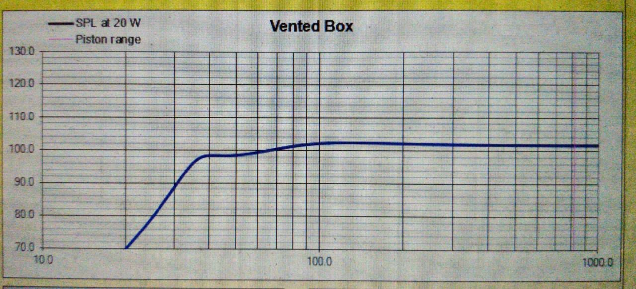

Used UniBox to come up with the box volume and port design. Used MDF as the box material. Hand polishing after creating a faux wood grain took care of the exterior looks.

c) I also tuned the box to as low as I possibly could (45Hz) bearing in mind the TS Parameters of the woofers. That also helped mask (or should I say round off) the brightness of the sound. Corner placement of these speakers totally rock in terms of bass.

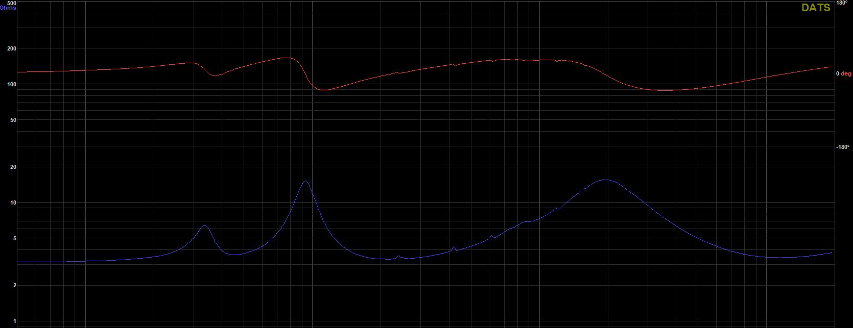

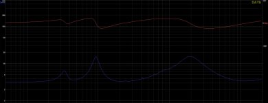

I have recently acquired DATS as well as a measurement mic and will be posting the measurements soon. I do have the UniBox frequency response graph that I can post in the interim.
