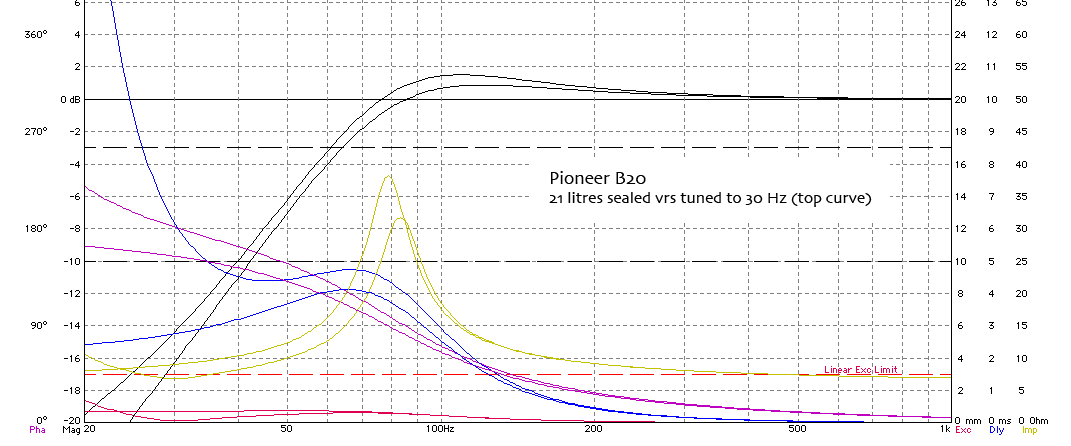

Using the PE specs, and keeping in mind what the high aspect ratio slot ports do to flatten the response i did some sims.
I started at 100 litres, and kept making the box smaller & smaller, adjusting the tuning to keep a bit of a bump, and a "non-wiggly" 1st derivative of the simmed response.
To my amazement, with just a sacrifice of the F3/F10 i was able to keep going, finaly stopping at 30 litres, at which point i kumped to the 21 litre (3/4 ft^3) of Jeff's box.
Attached are sims of Jeff's box and 21 litre sealed. Knowing what the high aspect ratio ports do, i have to wonder if it is really possible that the vented box is actually flatter than the sealed. Usually i estimate the end response somewhere between the vented sim & the sealed sim... in this case the only significant gain you get with the vented is that the box goes from high pressure to low pressure.

FWIW your slot ported boxes look absolutely miles out for the driver
parameters, care to share the design process that led you to them ?

The undersized box provides a high Qtc bump in response, acting as some lightweight bafflestep compensation. It also ensures that the output from the port is significantly damped so that the small port diameter doesn't induce any port noise, while providing a modest amount of extra output in the bottom octave and avoiding unloading at frequencies where the driver is still responding significantly. My alignment allows for relatively high, full range, input without running out of excursion. Further, the characteristics of this rolloff tend to mate well with the boundary reinforcement provided in the typical placement of a small speaker like this. You see similar kinds of alignment in many small speakers, though usually they're tuned quite a bit higher. As you say: horses for courses.
