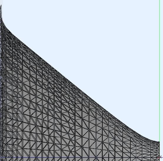

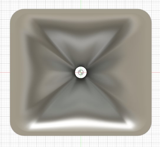

Ath now has a function to import curves and auto lofts into Fusion360 with addon scripts which creates a parametric surface, no need to mess about with meshes any moreIt's also a bit of a pain in the *** to turn the STL's into solids so I can edit them easily.
So now you can get something like this straight away

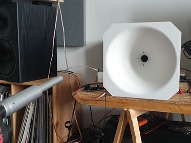

Hornresp is very good at predicting the interaction between the mid range ports and the tweeter reflection null if the correct distances and volumes are entered.
Pick a horn type that is closest to your intended design and use that simulate the bare horn in Hornresp and ABEC from Ath to compare. The port length, diameter and volume of the throat chamber (Vtc) interact to form the bandpass response and they can be traded to get the response you want.
The frustrumizing is a way to make the effective port length very short with a sort of roundover. Can be simulated by adding some extra volume to Vtc.

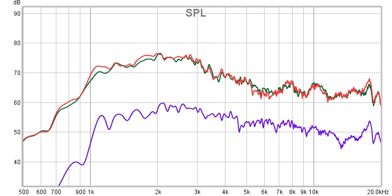

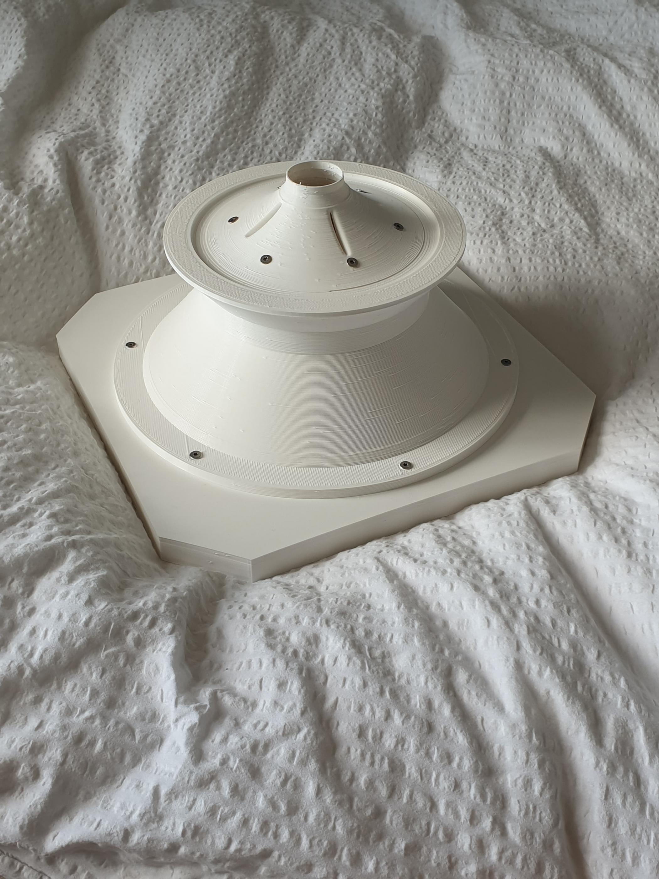

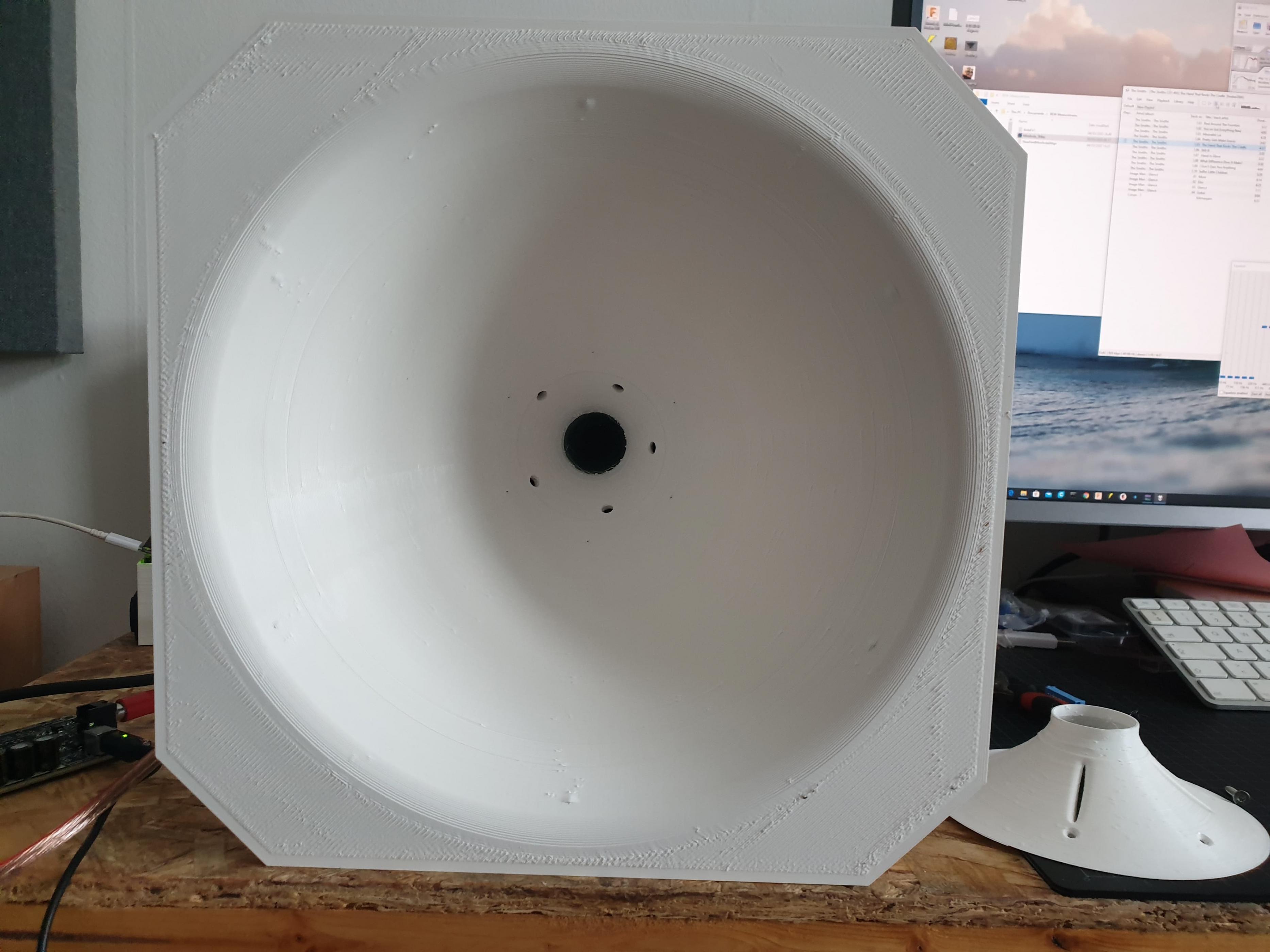

I after managing to calibrate my printer again I made a new design (with the same dimensions. But this time executed in ATH.
I made it in 3 parts so I can quickly iterate through throat designs.
Made a 5 tap and a Slat version and here are the measurements.
Red - 5 taps
Green - Slats
Purple - No Horn (just the driver measurement at the same position)
Straight measurement without any filters 500Hz - 20kHz
The new horn definitely measures better than the old one.
It's funny how much more output the tweeter has with the horn on

Try a “V” shaped slot. With the vertex pointing out. It might be more invisible to the tweeter. And put each V offset at slightly different t axial location and azimuthal position in fact, pentagonal symmetry slightly randomized from nominal 72deg separation is best to reduce interference notches.

I thought about making a sightly rounded V.
I think the high air velocity might produce some noise where the V narrows.

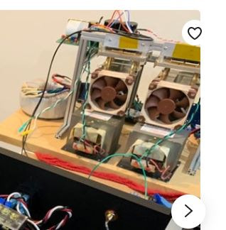

It’s a bit OT but that is a SE Class A amp using a microwave oven transformer as a reactive choke load and a surplus Dell heat pipe CPU cooler mounted to a an IXYS mosfet dissipating about 150w of thermal for a 50w into 8ohm amp designed by Aksa, that is, quite possibly the best amp I have ever built or heard. It’s called the Glass Harmony and is not a public DIY design.
There does not seem to be much difference between the hole and slots but they are both very small. You could try running mid range sweeps at 3dB increments and see when compression sets in for the different slots if you want an objective measure of slot performance.
