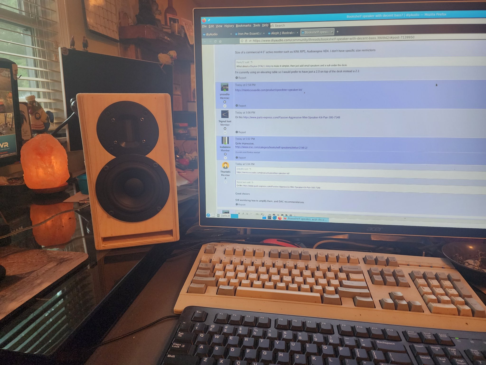

Quite impressive.

Elac BS41
https://www.amazon.com/ELAC-4-Passi...sInFzcCI6IjAuMzcifQ==&sprefix=,aps,540&sr=8-2
Wait for a sale, couple of weeks ago $98

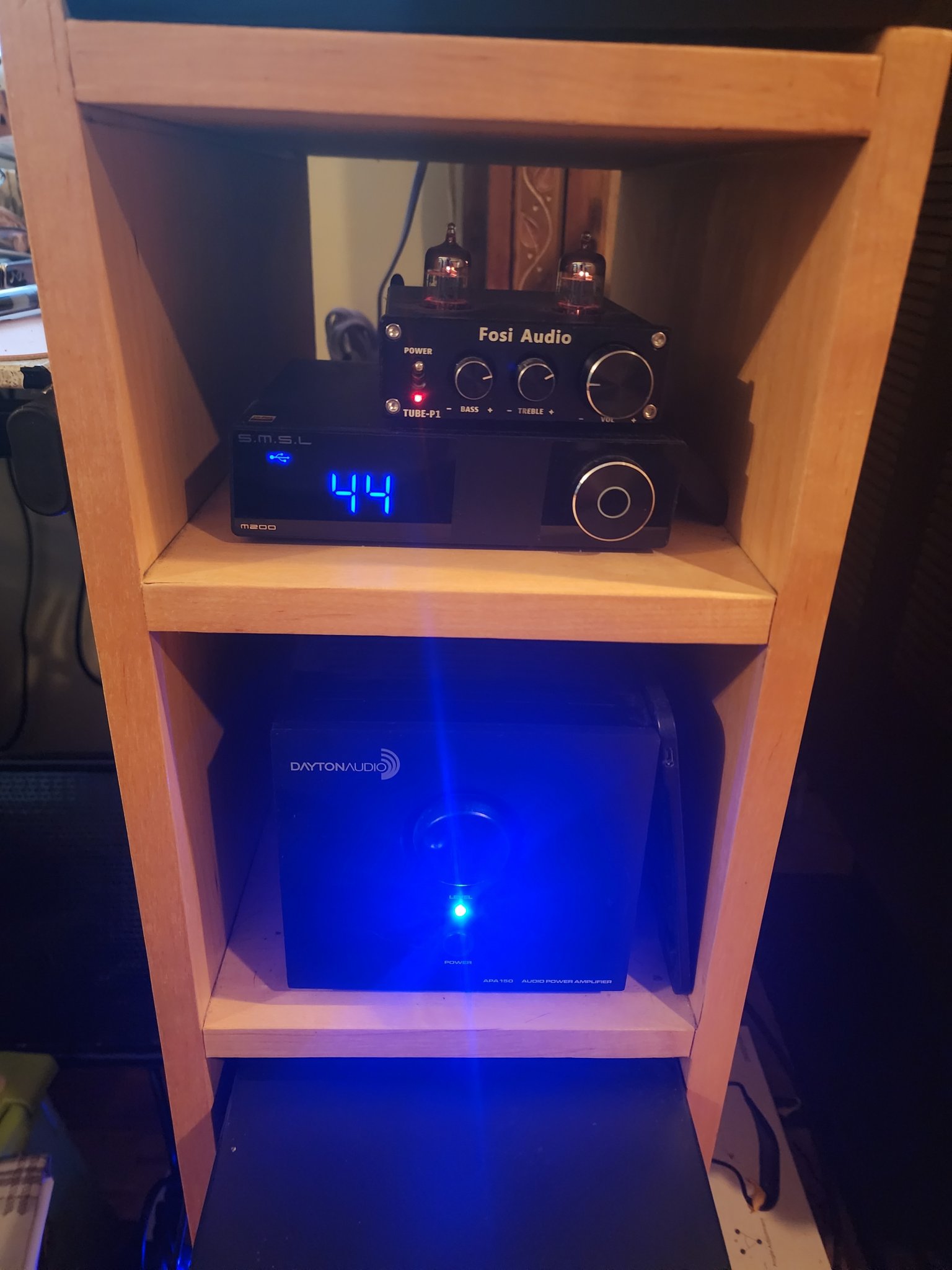

I have a Dayton Audio APA 150 for the amp, S.M.S.L. m200 for the DAC and a tube preamp.
Works great for the computer.
The APA 150 is 75w rms, in my case I plan to use a 3-way with a total 85w passive so... I would like to use a 100w RMS x 2 amp.
Do you think of any that might fit?
