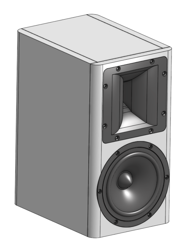

bookshelf horn speaker for small room

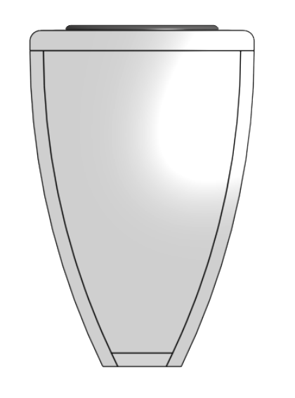

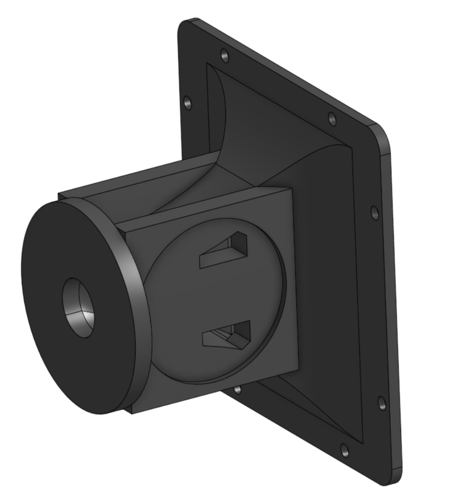

After thinking about it, why not? Tempted to combine the DE250 to the "constant directivity" horn from Aliexpress (how should we call this horn? this is too long). Apparently the exit angle (included) of the DE250 is like 13 degrees. What would this mean for the performance of the combo?

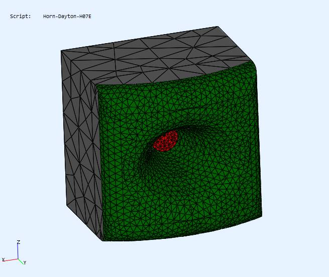

I was thinking about using AKABAK to simulate several different exit angles, by using the normal-driving function and a 1 inch dome shape that mimics the sound wave coming from the driver exit. The "normal" driving simulates a mesh that "breathes" in the normal direction of the triangles that are driven.
If a compression driver (CD) is used, and the XO >1.5Khz, then all that's required is a smooth response. It's optimum to match the exit angle but it's not significant when they do not match. The consequence is a possible reflection from the acoustic impedance mismatch due to flare rate differences. Any gaps or ledges in the matting surface or throat interface are real problems.
I suggest calling the horn "DiffSlotHF" just because its a "Diffraction Slot HF" design. IIR I think it might be a clone of a Beyma horn. In Akabak the driver membrane radiates, by default, normal to the triangles. However, you can also specify a radiation direction that overrides that default, usually in an axis direction, that's useful for deep drivers like a cone.

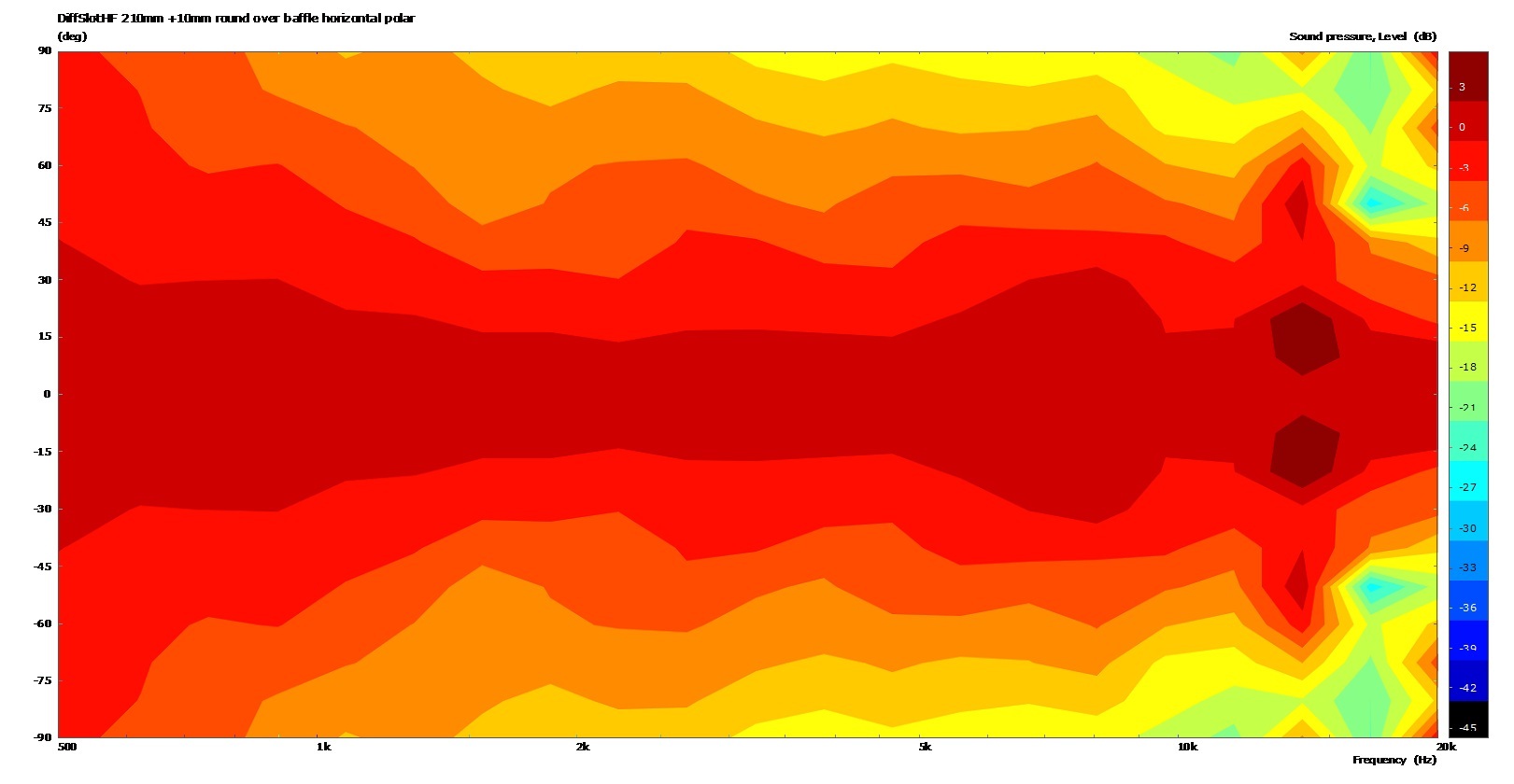

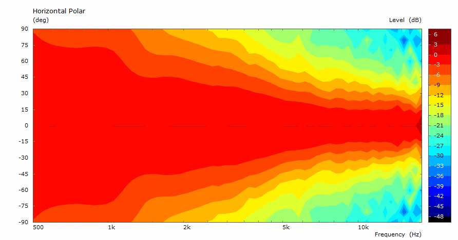

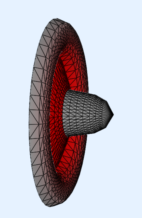

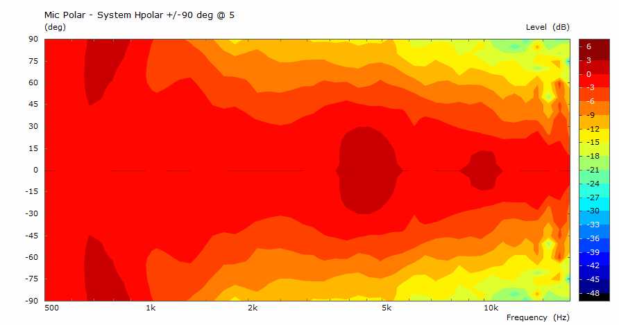

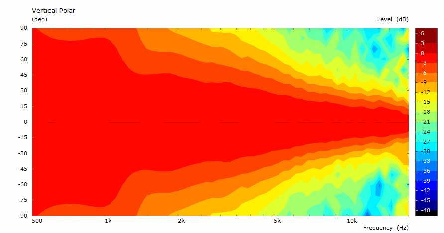

I simulated DiffSlotHF on a baffle/box 210mm wide with 10mm roundovers on the vertical edges like on the renderings of past posts. still need to do the vertical assessment.
past 10k it's a mess. Curious what the real life normalized measurements will show!
The woofer selection needs to be evaluated on beam with because of the new knowledge on the directivity of DiffSlotHF mounted on a baffle. This to ensure a good matching beam with.

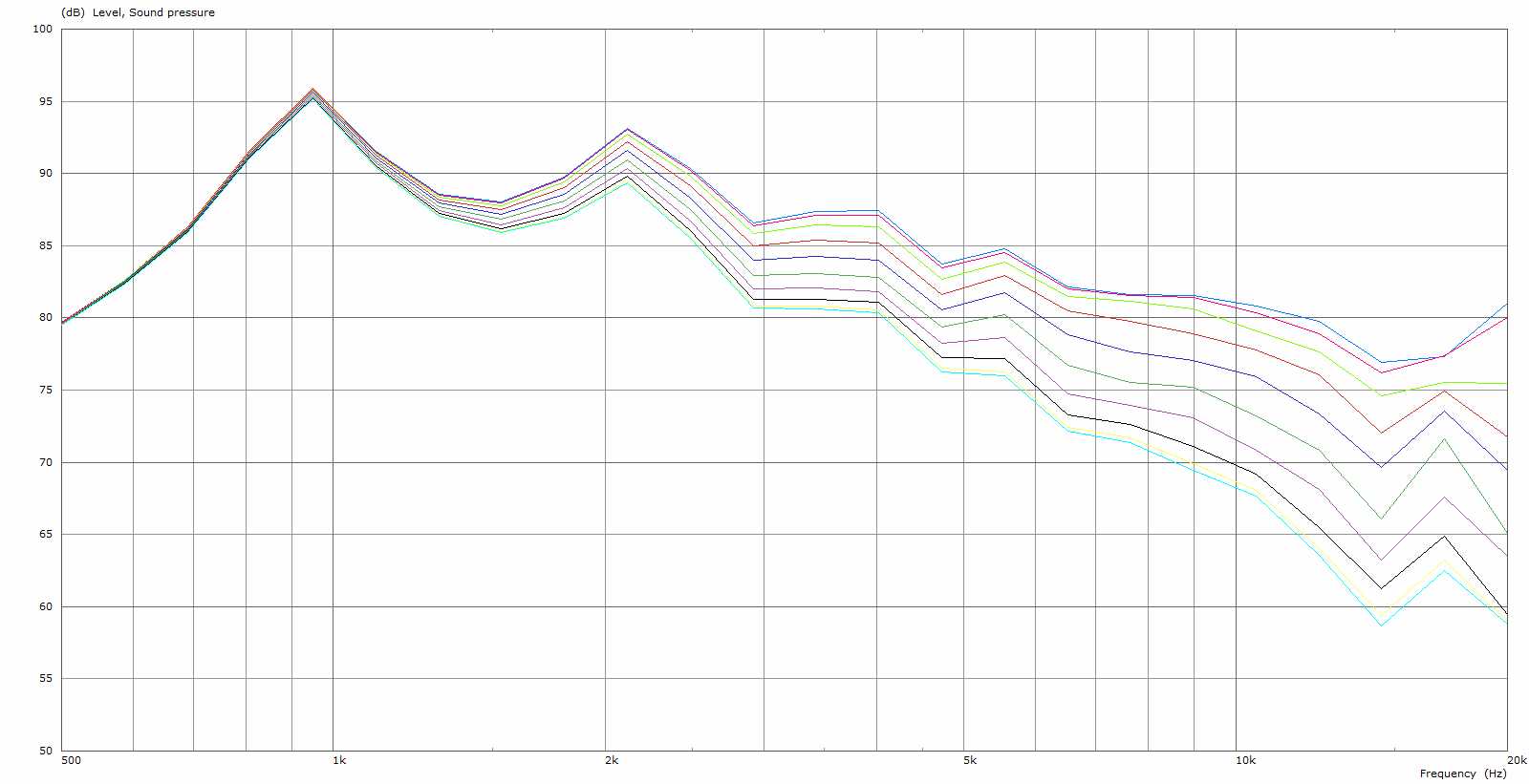

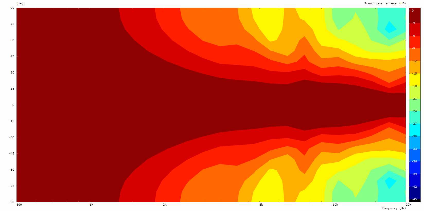

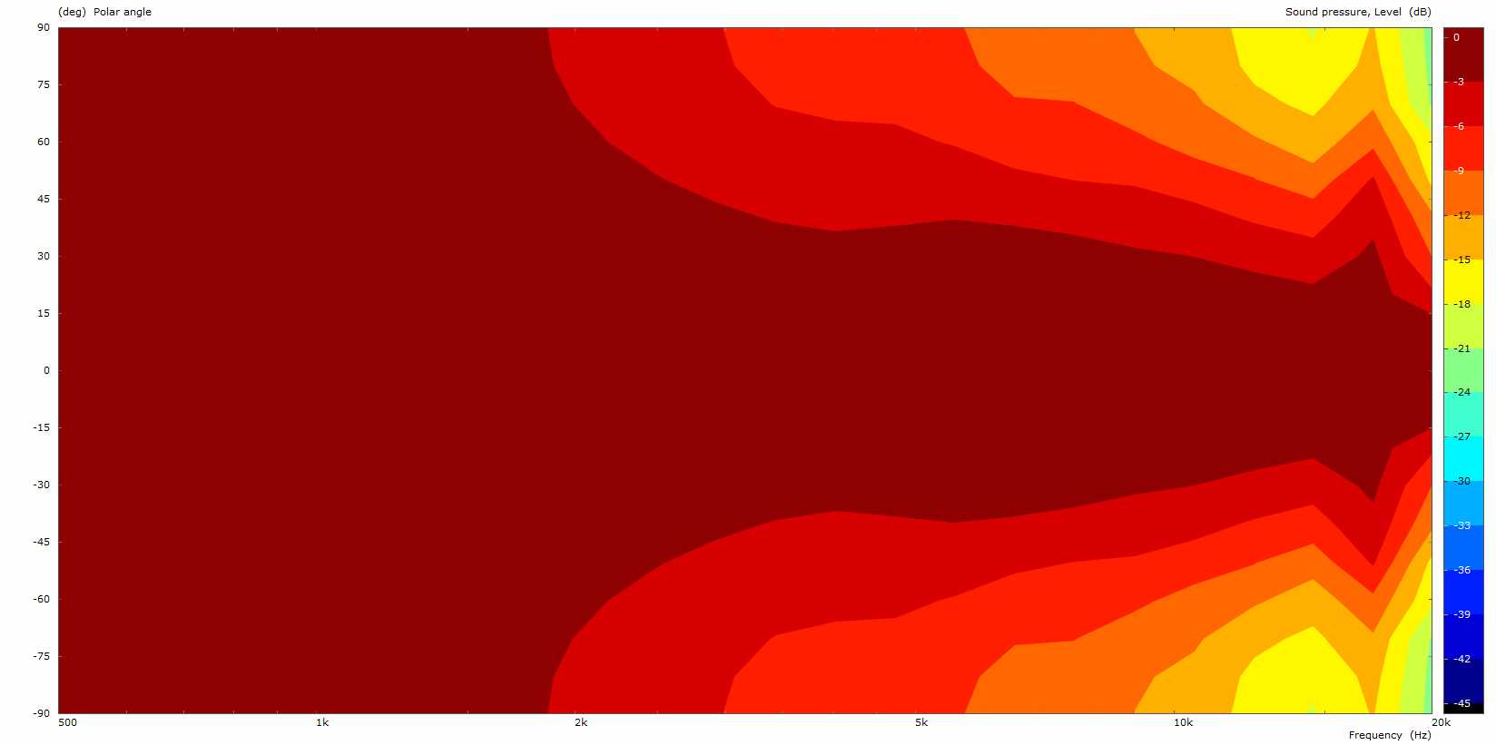

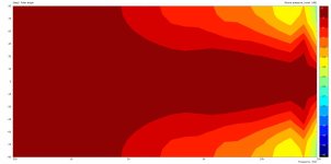

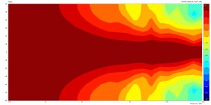

Yes, the XO point would be around where the beam widths are similar. I've included my model for this horn, it's meshed to work up to 18Khz. I've also included a simple pressure box to model the beamwidth of a 8" woofer (simple piston model) and included a 1.5Khz LR4 XO (LEM) to show what the system might look like. A note of caution: the model uses constant velocity drive (no motors) and normalized polars just to show the beamwidth effect. You will need to measure how your CD+Horn actually perform (levels+THD) if you are planning to use a passive XO.
The PB makes it easy to experiment with the woofer size and XO. Any changes in LEM can be re-analyzed without needing to re-solve. Enjoy 🙂

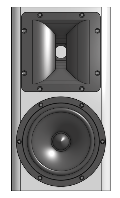

I would keep it simple for a 2-way bookshelf (like post#16) using the CDX1-1747 and RS180-8. If you can measure the acoustic response of the components in the box, it will make a passive 2 way XO easier to design. It would only require a simple stereo amplifier. If you stream music from a PC something like EQ Apo could do global equalization to tailor to your tastes and room conditions. A separate sub could be added later if more bass is needed.
