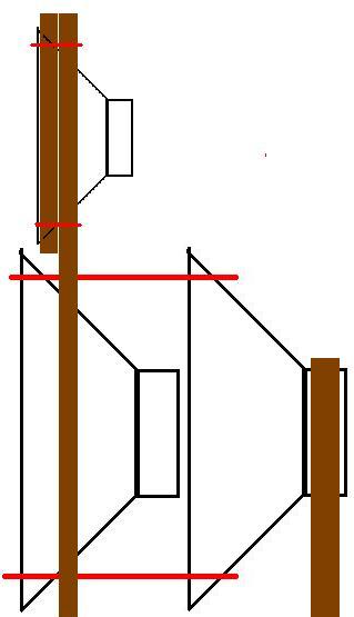

I am more than curious as to your findings regarding the use of woofers in this fashion (SPL levels, equalization, etc). I bought myself fous units of an 18" PA woofer and any enclosure is to big for my small room. So now I am thinking about something along the lines of your idea/project for the bass. I will be using the threads/rods to hold two wooden beams in vertical position on which I will attach a MDF panel containing a B200 fullrange from Visaton. Something like the sketch (very flexible construction, BTW).

ErikdeBest, without baffle they loose spl too quickly, they can't keep up with my main speakers. I attached measurements from 20in distance-red and ~8ft distance-green(with turned up amp gain knob). I am going to try to put these subs closer to where I sit.
Hi MisterTwister
I was already expecting that they would lose SPL too quickly, but as I will use them in a small room at relatively low sound levels I hope I can accomplish something nice. I hope their 18" size will help a bit as well...
Whenever I finish building them according to my sketch in the earlier post, I can always try to add some baffle (although I do not know exactly where...)
Erik
