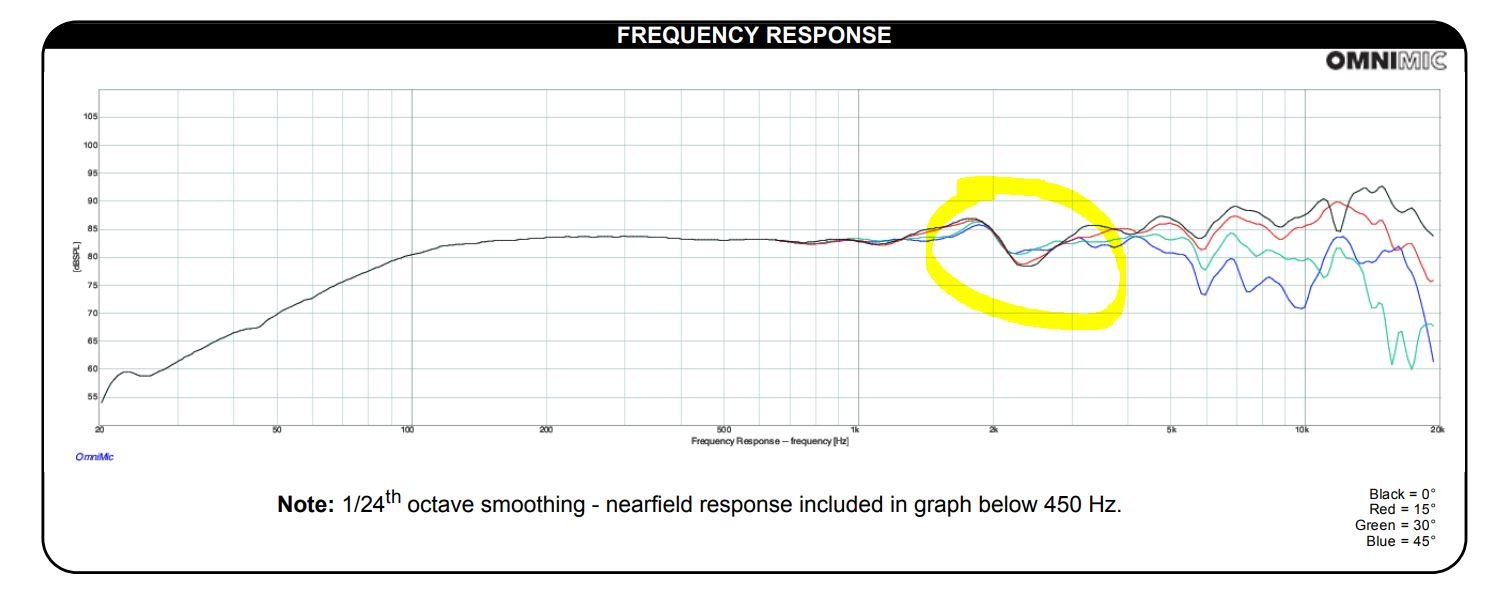

Hi, I want to build myself a pair of bookshelf / desk speakers/ ( I built in the past a few, I have a woodwork shop, I've done woodworking .
I know the basics of electronics, built a few amps, design myself with the help of this community. anyway, when it comes to speaker crossovers I'm pretty noob, so I'm here for some help.)
I already have picked a pair of Dayton's TCP115-4 and ps95-8.
I'm thinking to put them in separate boxes, something like Focal did, Separate the tweeter ( fullrange in this case but with low pass ) from the woofer.
Firstly I wanted to do a 3-way , same speakers but adding a tweeter crossed at 4-5khz and use the ps95's as mid range , from 400, 800 ? to 4-5khz,.
The woofer TCP115 starts to " cone breakup ? " at around 2.5 -2.7 khz, ( yes I could go 2way with a tweeter crossed low at 1.7 or so but they are big , same size as woofer and pricey)
The full range ps95 has a weird dip at around 2.4khz.
Now what would be the thing to do with that dip at 2.4khz, bring the woofer up to compensate? or bring up that 2.4khz on the fullrange within the crossover?.
I tried some variations in XSim with the data files provided by Dayton.
Before I make up my mind to go 2way with the woofer and fullrange or 3 way with also a tweeter ( maybe the nd16fa-6, since it will be crossed high ) , I want to figure out the crossovers.
Some ideas, help , would be wonderfull.

Going by the dent in the impedance plot, it may be cone break-up, with the coil and cone edge swinging in opposite polarity, so there's probably not a lot you can do about that if that's the source. But I wouldn't worry too much until you get the drivers and measure them. They might not even have the dip.
It might be possible to size the box to get a resonant mode that brings the 1.8kHz area down a bit. Or try something similar with a wave guide.

From the Xsim plot of the "Electrical Response", it seems that the present potential filter design has a great deal of overlap between the high and low frequencies. This is quite unusual filtering for a the low-frequency and high-frequency drivers. They will be interacting acoustically over a very broad frequency range, where they are both contributing similar amounts of energy. Is there any particular reason that you may have chosen such an approach?
@motokok that 4inch driver starts to roll of at about 2.7khz and since it's a woofer with decently high xmax, I thought a mid-range, full range driver to take care of the mid range would be better. I could use a good tweeter and cross it low enough , 1.7khz or so , but they are expensive.
@witwald "Now what would be the thing to do with that dip at 2.4khz, bring the woofer up to compensate? or bring up that 2.4khz on the fullrange within the crossover?."
I tought bringing the woofer up , to compensate that dip in the midrange, but I think that would not have been the best ideea,
What freq to cut the woofer to the midrange you recommend? 500-800 ?, 250 to low?.

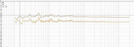

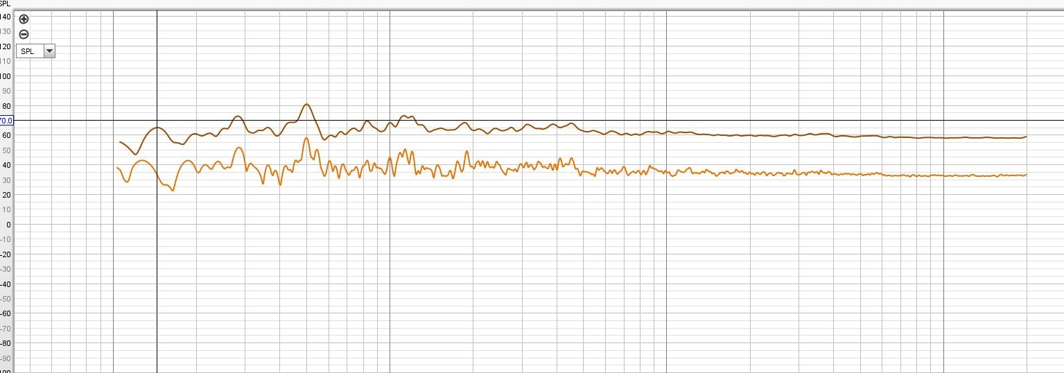

@stv I don't own a callibrated mic, but my mic I think its good enough for testing, just to make an ideea at least?. Here is a graph, my mic in a box with sound absorbing material, to see if its flat or it " colours the sound", if it wasn't flat I would see dips and peaks even if there was no sound to pick up by the mic?. as it would : "colour " the noise as well?. I might be wrong.
I don;t know how to measue if its pretty flat or a mess, since If i test with speakers their freq response won't be flat either. As i read somewhere , mics usually have a peak at 500hz or so , for it to sound better as humans talk into them.
With Brown, second photo, is the freq response , mic open air, no box.
