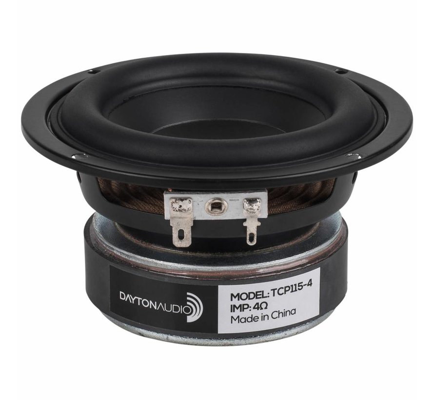

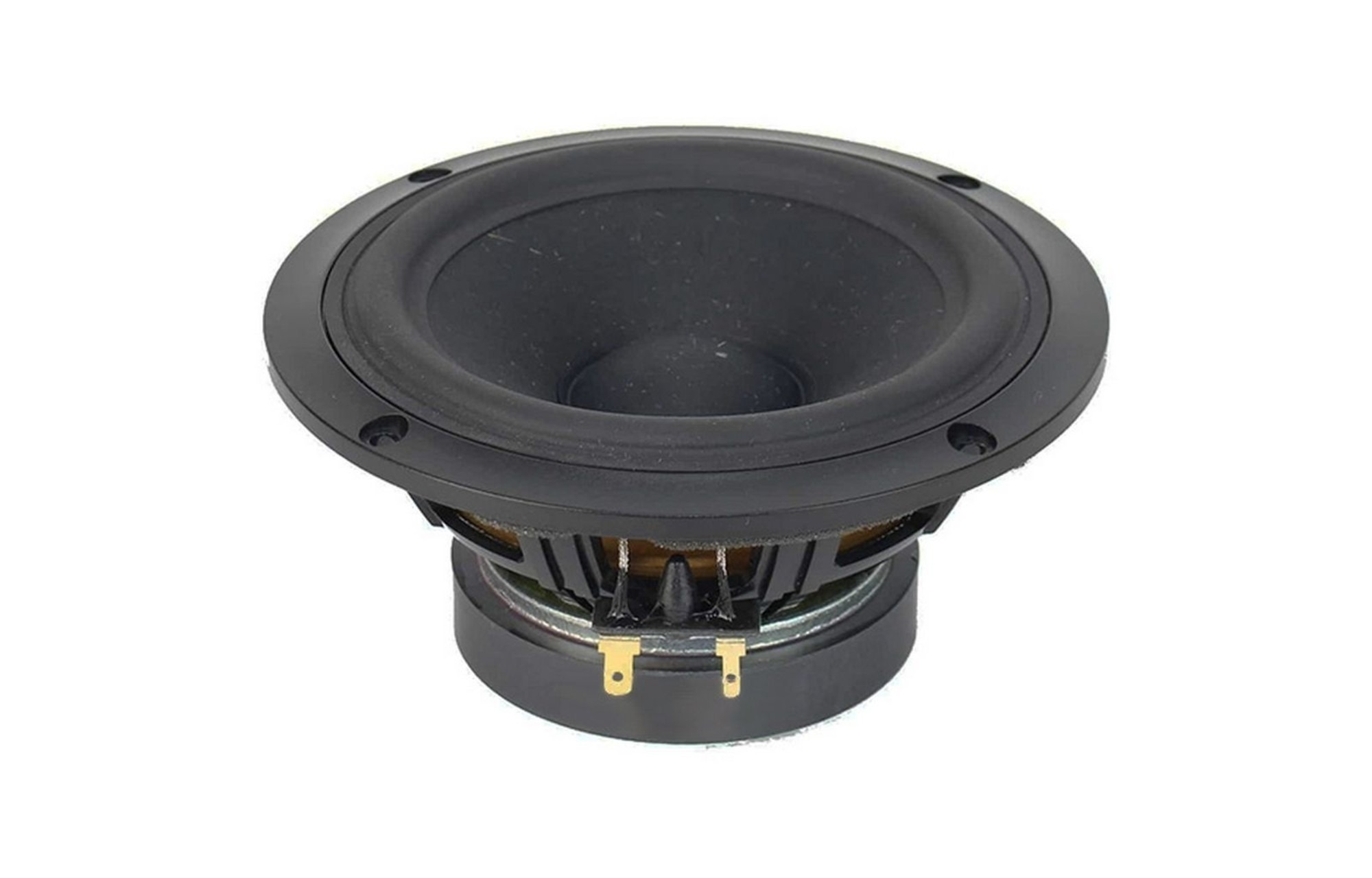

First I found the Dayton's TCP 115 , with many people using them and then I found SB Acoustics who have great drivers ( satori , ceramic etc . )
I dont know what to chose between Dayton and SB Acoustics, these are the drivers I was looking into buying.
The Dayton's seem to roll of at about 2.7khz , and also bass not so great .
The SB Acoustic's have higher sensitivity , great bass but I dont know that dip at around 50hz and from 4khz they have a spike to around 7khz
idk take a look please. at the PDF's .

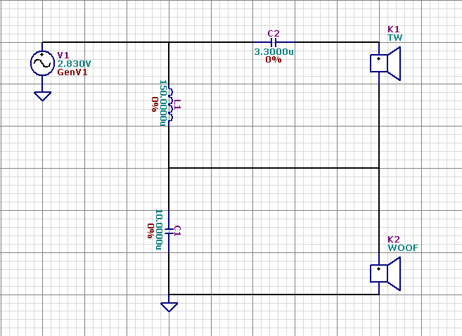

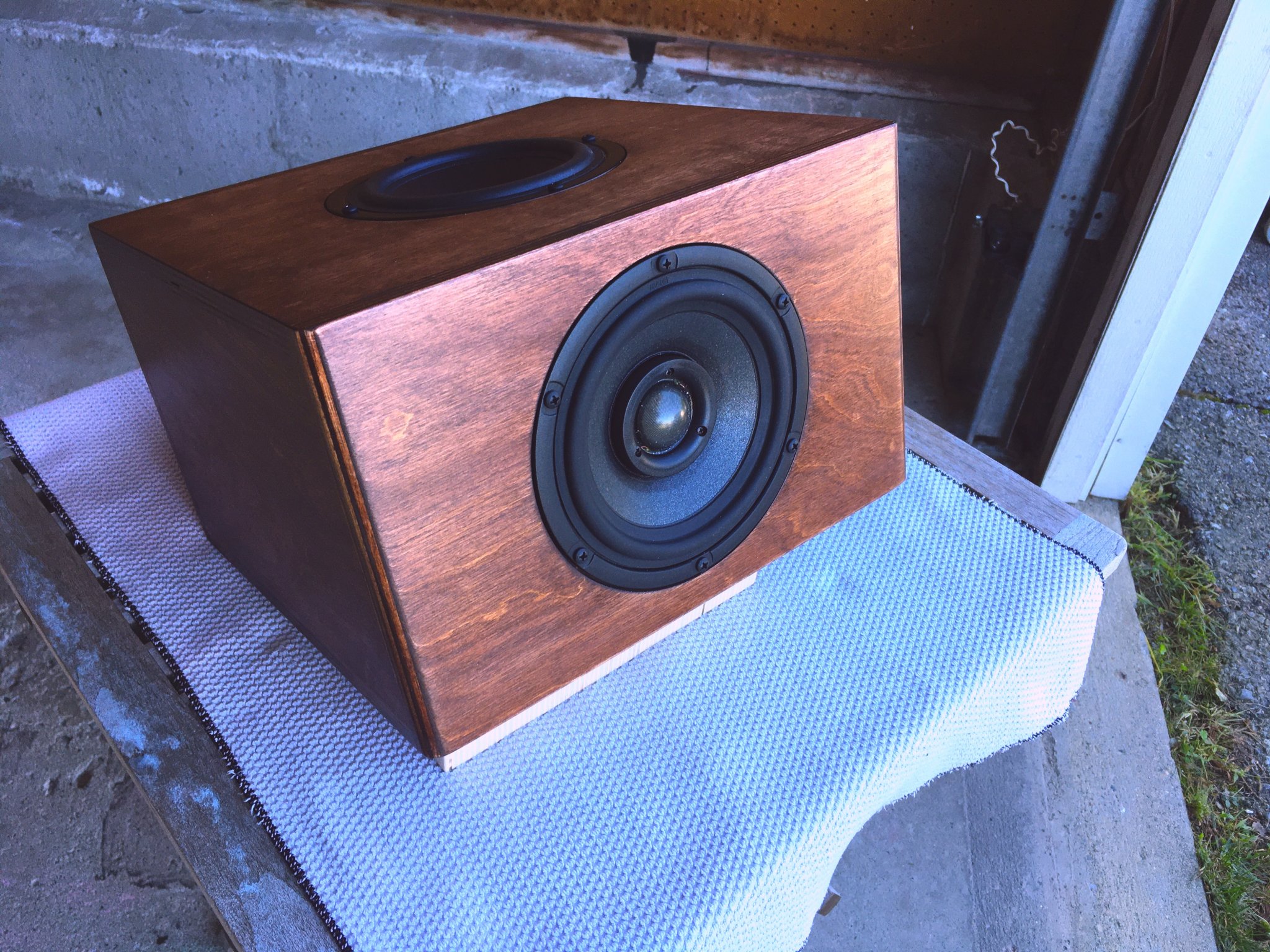

If you are thinking about a desktop speaker with coaxial driver, if your budget can stretch that far, Morel makes a very nifty 5-inch coax. Here it is in a sealed box with an SB passive radiator and a minimalist series crossover. I have a business acct. at Parts Express, and my current price is $180 each. You could also position the loudspeaker vertically with the PRs pointing outward. I use a little triangular piece of wood scrap to aim the driver at ear height. If you wanted a vertical orientation, you could put the driver closer to the top edge. You could also put the PR on the rear panel.
Best of luck,
john
