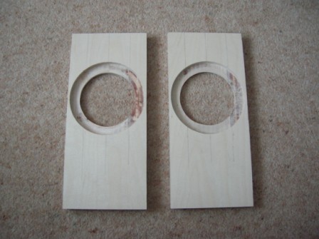

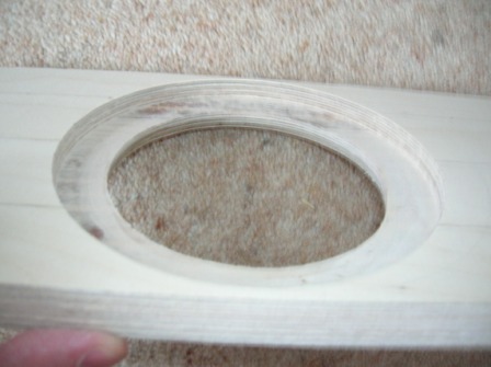

Just a progress report.
Cut out done.
I have started building the boxes. Post some progress when I put the brace in!

nice work

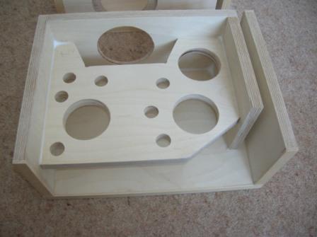

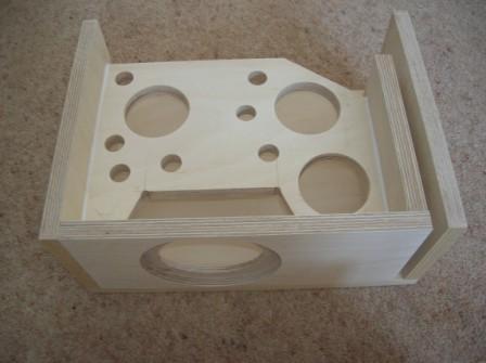

Quick (stupid) question about the brace,
Correct me if I'm wrong.
I guess the contact with the speaker and the brace is important. (So only the cone moves forward and the speaker cannot move back, so all music information is projected)?
How much compression is put on the Alpair basket? Are we talking .5mm 1mm. ie how high above the recess does the speaker sit before being bolted down. Or is it just in touch with the brace when placed in the recess so the compression of the gasket gives the pressure?
I guess putting something soft between the brace and the basket defeats the point ie zero backward movement.
I assume Dave / Chris have a quick sure method without having to trial and error it.

1) No compression on the basket - yes, getting the brace to fit just firmly enough to the magnet (including compliance of gasketing) and all 4 panels is one of the more fiddly parts of the fabrication. And since it entails a lot of dry fitting with driver installed, careful handling of metal coned Alpairs and CHRs is very important - they're not as rugged as paper - so far I've managed to crease 1 each CHR70 and A7
2) mirror imaging of the off center braces would be a little OCD, don'cha think? :wink:
- I mean - probably not necessary :big grin:

nice work so far on the boxes

Thank's for the help - i did mirror the braces. LOL
What are your thoughts on the foam gasket with the Alpairs. Does it make any difference? Ths seal seems quite good on the Alpairs.

I guess the contact with the speaker and the brace is important. (So only the cone moves forward and the speaker cannot move back, so all music information is projected)? How much compression is put on the Alpair basket?
Yes. you do not want to put any strain on the basket.
Yes
Depending on how compliant it is, it will act as a low pass filter on the energy being shunted away from the driver.
Chris is the guy.
dave
