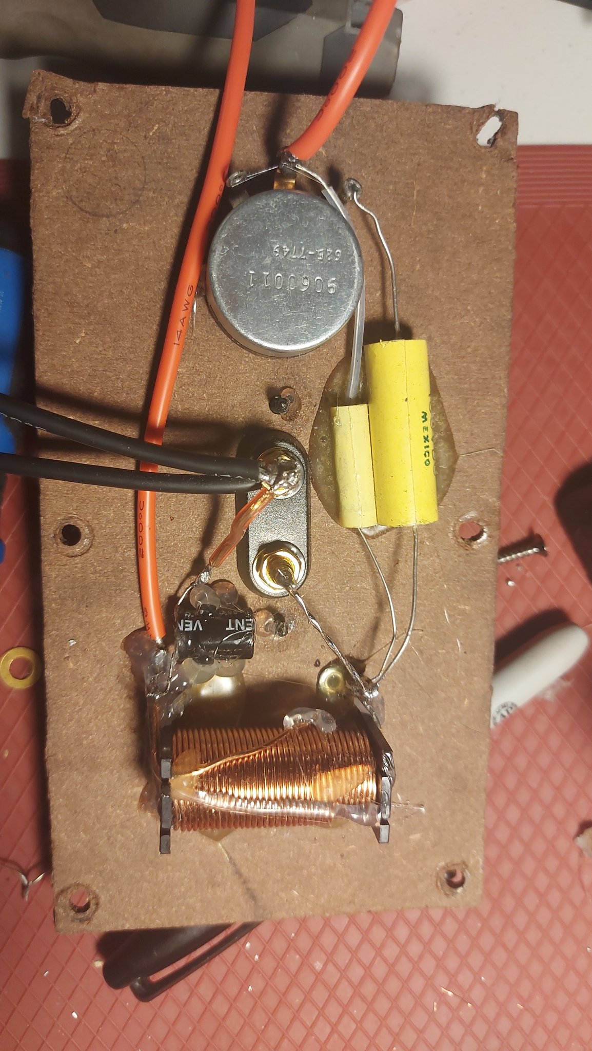

I have been playing around with these in an effort to make them listenable. I mod podged the old paper cones and it made a huge difference in the sound, (for the better). Now I'm working on the crossovers. I'm trying to tame the peaks at 2-3khz. I added an inductor to the woofer and I think my next step is to add a capacitor across the woofer. Any suggestions or insights are welcome.
If it’s possible, try to take some measurements of the woofer and tweeter individually. My recommendation is to set the speakers on stands (or objects) and place the mic at 1m distance (39.37”), at tweeter height. You can also lower the mic height and experiment to see where the impulse response of both drivers more closely aligns, if at all.
I don’t have these speakers anymore, if I did I would do some measurements right now for you.
With the crossover disconnected, measure the woofer alone and then the tweeter alone. To protect the tweeter, set the sine sweep to start at 1000Hz. The measurement doesn't have to be louder than speaking level.
Once you have the measurement plots, you can apply smoothing, such as 1/24 or 1/12 to average out the room reflections and get a little better idea of the response and phase.
It will be up to you if you want to measure the off-axis response. Power response is important, and collecting the off-axis data takes a bit longer.
The next step will be to export the response and use a crossover design app. If you can do impedance sweeps using a resistor jig and sound card/audio interface, that will make crossover design easier. If not, DC readings and guesswork will have to suffice.
