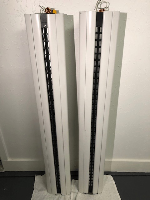

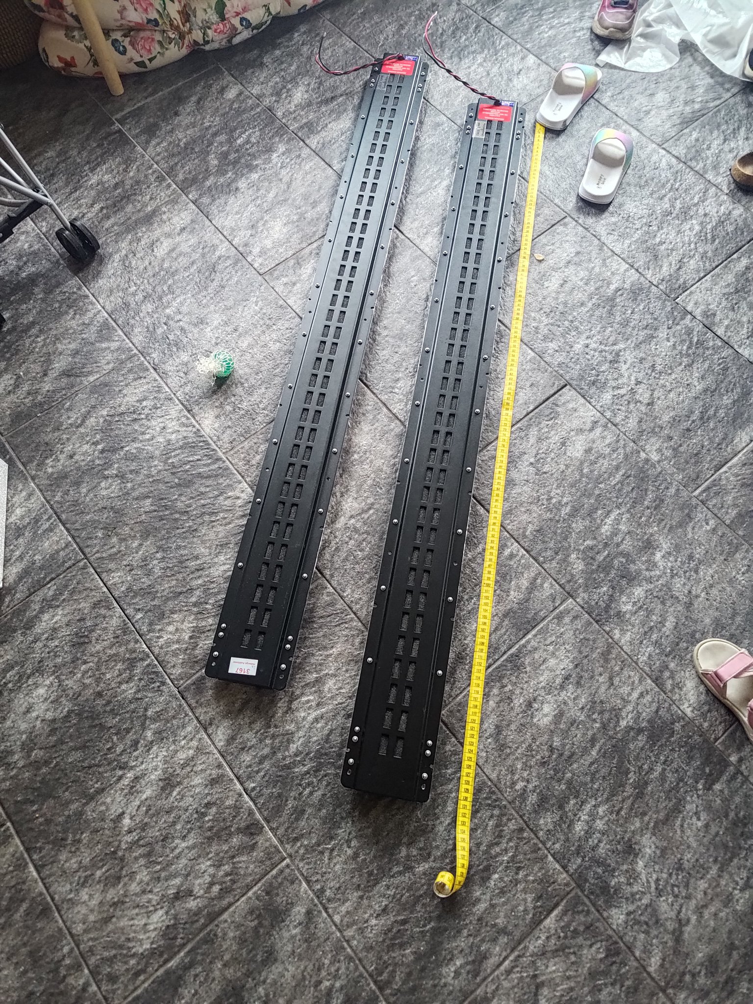

Hey, in a small town in Sweden there was an auction house selling assorted knick knacks on regular basis.
For some reason these ended up there and I bought them mostly out of curiosity.
Now I sit with these behemoths and no clue what to do with them.
Does anyone have any advice? I cant seem to find any diy plans using them.
I have managed to find out that I need something for around 500hz and lower.
Is it even possible to build something slim and discrete for the living room with these?

Mount them on a panel with no enclosure, cross them at around 1,000Hz (less is better, but they sometimes buzz at lower frequencies) to a pair of 8" woofers in a slim sealed box and enjoy. The BGs sound amazing open baffle. BG also lists a contour circuit to get rid of the cavity resonance but I preferred running my RD48s without it.
Typically dipole speakers are at least 3 feet out into the room to increase the delay between direct and reflected sound.Sound reflected from the back wall won't mess anything up?
https://www.linkwitzlab.com/listening_room.htm
If you want to run them in a shallow enclosure up against a wall, that is also possible, but you'll need effective acoustic absorption inside the enclosure to prevent the rear wave from bouncing back and transmitting right through the diaphragm. This is a larger problem on planar speakers since the diaphragm is so light and thin.

Whatever you decide to do with them, I'd test them before building anything elaborate. If you want to try dipole, test baffles for those can be low mass without a big impact on sound. Fome-Cor, cardboard, whatever is easier for you is OK. You can also hang them from a door frame, etc. for these tests.
Ok, 3ft can be arranged if I have them in my hobby room in the cellar but if I want them upstairs I need to make them discrete and definitely in an enclosure.
I have seen an commercial product using them in an enclosure and one (or two) 6.6" in a box doubling as a foundation for the speaker.
I still havn't figured out what direction they are facing.

BG used to sell a speaker based on this driver. Open baffle down to ~400hz, then a small sealed box with a 6(?)" woofer. Called the Radia 520 or something like that. I used to have a pair, sounded great, but needed a sub and a little boost at highest frequencies as they started rolling off around 12kHz.
You are lucky to have found these drivers, which are getting rarer. I have also listened to the B&G Radia 520i in the past and somewhat agree with what John Atkinson wrote: "This balance correlates with the presence-region dip and the slight excess of energy in the mid-treble in the in-room response, my ear latching on to the latter as brightness rather than on to the former as a lack of presence." "Lack of air" also noted from top-end drop-off.
It is frustrating because the planar drivers are obviously well made and their sound often shows so much potential, but the above issues and the integration issue with bass drivers can become very time-consuming and present many "close but no cigar" results. Look at the Herculean efforts put out by Wisdom Audio M75, which needed a pretty sophisticated active "brain" to try to overcome some of the issues.
Having said that, I would put the planars on open baffle and try to find some fast woofers, not too large maybe in 7-8" range.

Those drivers don't have high QTS for open baffle use, so you need to stuff them in a box. Do you still have the old sub cabinets or able to make/get boxes? If so, I don't see why you can't give it a try, provided you have some means to provide crossover, e.g. passive, analogue/digital active, etc.I have a pair of these drivers collecting dust. Couldn't I use them?

No boxes of crossovers but boxes are easy.
It is the crossovers that will take some time.
I have only copied other peoples designs so I know nothing about them.
But I guss that I need one that filters away anything below 500hz from the transducer and another that does the opposite from the woofer.

As someone else said, they will sound best at least a meter from the back wall. I ran mine open baffle with a 900Hz 4th order DSP crossover and about 1.5 meters from the back wall . My baffle was tapered from top to bottom; about 300mm wide at the top and 500 wide at the bottom. I also tried them with a rear chamber but I did not like the sound as much as OB. It's very easy to try.That easy?
Note that Carver ran them open baffle and very close to the edge of the baffle in the Amazing Loudspeaker. Mine were the the RD48s, designed for that exact speaker and yours are similar; just 2" taller.
