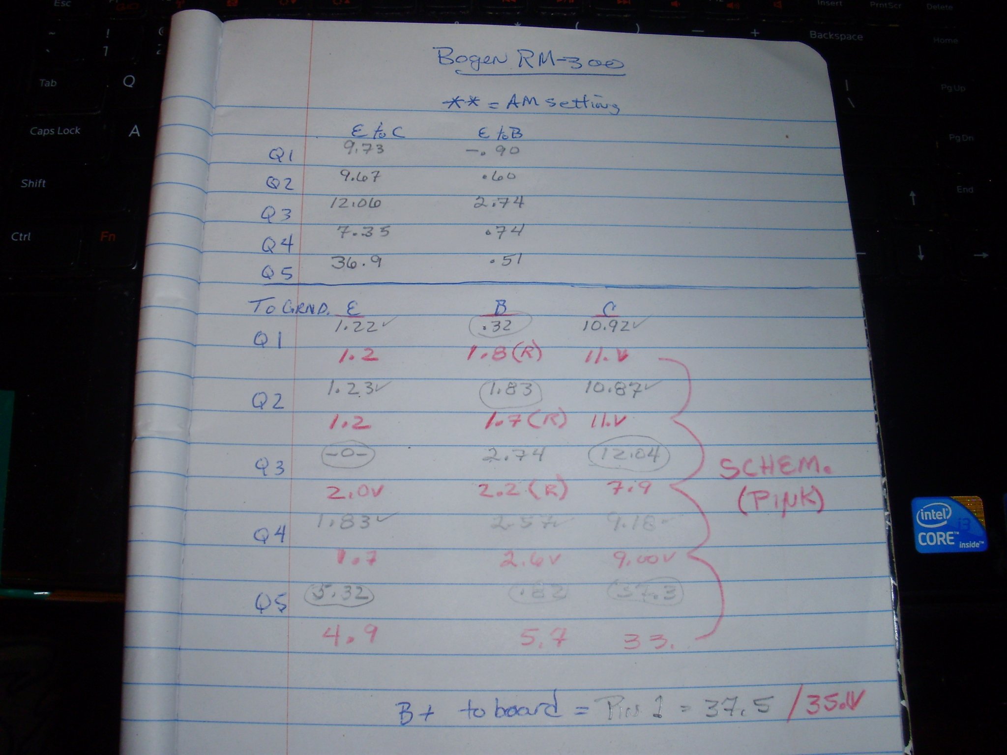

I finally got a chance to look for the problem with no AM on this receive... I took readings from Q1~Q5 both E to C and E to B,,, And each pin to ground, as the schem states... The readings don't look too good,, I tried to trace the signal from the antenna fwd, but no luck,,, any thoughts are welcome!
Seems FM also uses some of these transistors, but at different voltages,,, and FM plays very good... Also the tuning meter needle seems stuck in the center both AM and FM...
