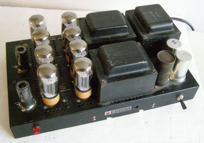

Bogen MO-200A transplant /conversion
Anyway, I used a variac to determine the OPT primaries based on the original loads, and they are around 4.5K each, so fully parallel, they would be 2.25k which would be perfect for PPP KT88 or 6550s.

As I am striping the second amp and popping the end bells off for paint, I noticed something again that I just ignored on the first one. Can anyone explain why the output transformers have a different part number from each other on each amp? They are different also in that the laminates are slightly shorter on one than the other.
Will this cause any issues when p parallel the two transformers?
It is just strange.
Thanks!
Blair
