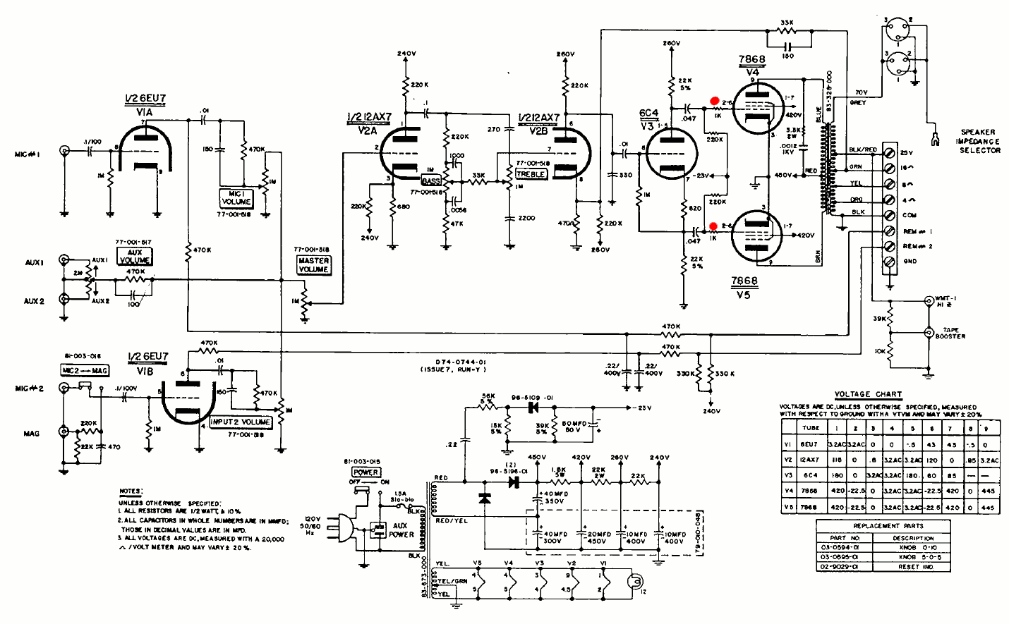

I got a nice all-tube Bogen CHB-35 PA amplifier and like many others
before me, want to re-work it. However I'm a total "toob-noob" ,
my experience until now being 100% solid state.
Here are some quick specs on the amp (I also attached a copy of
the schemmy) :
1x 6EU7 input stage (electrically equivalent to 12AX7, I'm told)
1x 12AX7 wired as the tone stack
1x 6C4 phase splitter
2x 7868 output pentodes.
I already did a number of mods on my bogen (silvertone 1484
tonestack, re-wired pre-amp with the two 6EU7 triodes cascaded,
standby switch & some other inconsequent stuff...)
They mostly didn't work out too well so I'm coming here for some
help !
A few questions : (many, actually)
1- when run at higher power, the power tubes (2x7868) seemed
to produce a mechanical rattling sound when striking notes. One
of the tubes actually glowed brighter blue than the other... Are
they dying on me ? Is my output stage badly biased ? (I noticed
some PP output stages on "real" amps have a bias pot.)
2- In contrast with the orig. schematic, my amp did not have 1k
resistors between the 7868 grids and the rest of the biasing
network (if that's the correct term). I marked them in red in
the attached schematic. What is their function ?

The 1K resistors are referred to as "grid stoppers" - they help prevent oscillations, which are likely with high gain tubes like the 7868. You DO want to add them. I suggest removing the feedback in a guitar amp, to slow the transition into clipping. This will increase the gain quite a bit. Just remove that resistor and cap.
The split-load phase inverter works great in the linear region but has very asymmetrical distortion when overdriven - this igets much worse with feedback applied. You COULD use a 6J6 dual triode, by rewiring the 7-pin socket. Of course this will give even MORE gain...
I guess you've already discovered the "grid leak" bias (no cathode resistor) doesn't work well with guitar - I think they used it to save parts. Low noise for mike use, but can't take much input. Some like it for harp though...

Hi & Merry Christmas all,
That part of the circuit is a bit shady to me. I see the 6C4 grid biased -15V under the
cathode, which is well into the cutoff zone (based on a plate graph I may be reading
wrong). So one phase of the input signal would do nothing (already in cutoff) and the
other half would need to reach at least +15V peaks to reach Vgrid=Vk...
Ah, but then Vk must vary as the input signal changes. I'll try simulating that...
But you're right, the original CHB35A circuit is totally not a guitar amp.
Another discrepancy I noticed: my Bogen is lacking the 1n2@1kV cap in series with a
3k3@2W resistor between B+ on the OPT and the plate of the top 7868...
Something else to guard against HF oscillation ?

Do you mean when the 6C4 is overdriven or when overall the tube stages are overdriven?I suggest removing the feedback in a guitar amp, to slow the transition into clipping. This will increase the gain quite a bit. Just remove that resistor and cap.

jjman : I think it's just to set up a DC bias on the cathodes ?What’s up with the cathodes on the 12ax7 being attached to the power supply thru 220k resistors? Is that for real? Certainly not a guitar amp approach.
