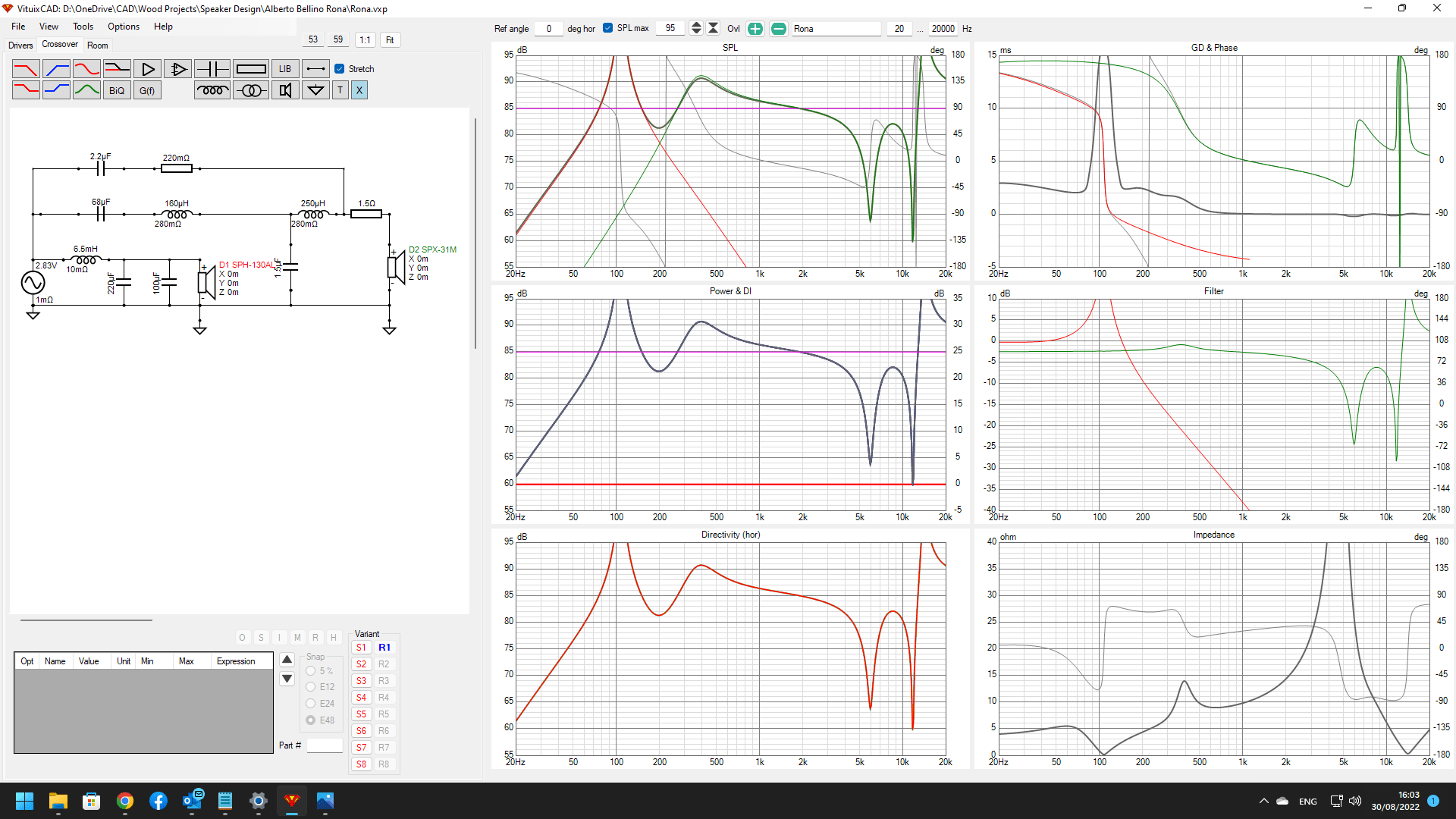

I don't know,It's the SH-130AL crossover that's causing the huge peak at about 100 Hz. Try adding a 10-20 ohm resistor in series with the 100 uF cap. Adjust the resistor value so the SH-130AL response blends with the SPX-31M response. I modeled just the SH-130AL in VituixCad and my results match yours.
PS: The inside diameter of the port tube is 35 mm.
It seems strange to me that a very famous and respected designer (A. Bellino) messed up the cross over.
It doesn't fit.
I am more inclined to think that there is something else.
Maybe I should consider the 3 drivers as completely separate units. They are working in 3 completely different planes.
There is some diffraction at the edge, but in principle only the full range is pointed to the listener.
The sound from the other 2 drivers comes to the listener in some mysterious ways (especially the twitter).
I don’t know if Vituix can simulate that.
I guess the simulation is based on a typical 2-3 ways configuration with the 3 drivers on the same emission plane. In that case there is interaction, cutting freq., phase, etc… but this is not the case.
Maybe in this configuration is just about cutting frequencies: low pass for the woofer, high pass for the tweeter, and something in between for the full range.
No idea

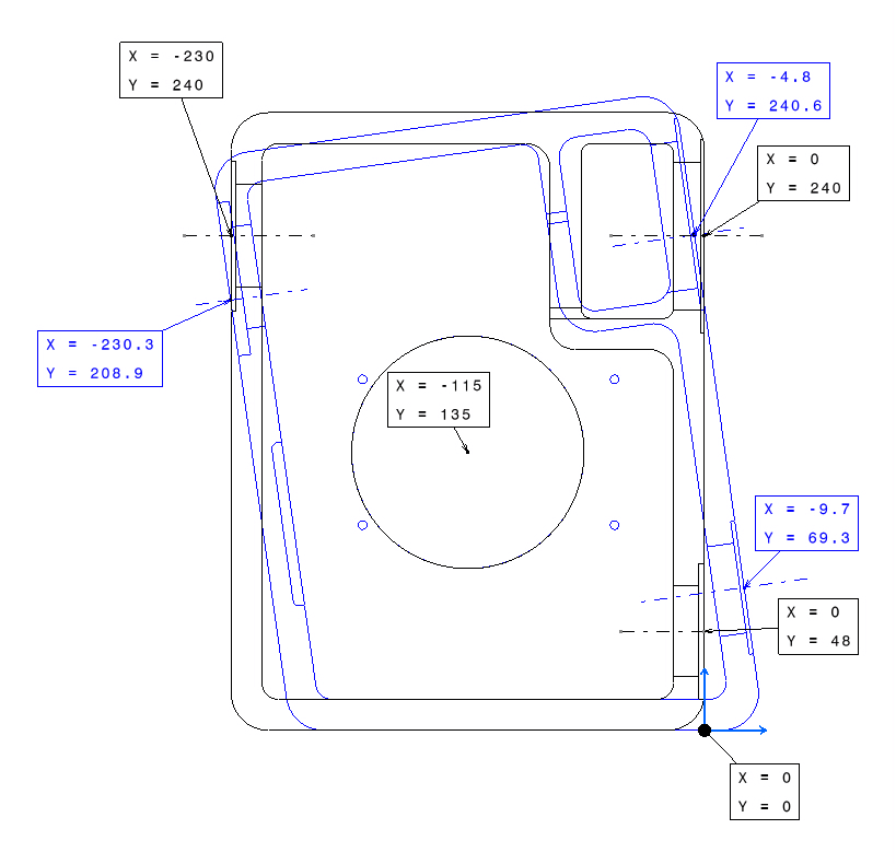

All these parameters can be entered in VituixCad (crossover tab. These are the coordinates of the side firing woofer. When the baffle is slanted/stepped you have to calculate the exact value related to the position of the driver to be entered (Z).
Coordinates origin, x,y,z=0 is generally the position of the TW.
