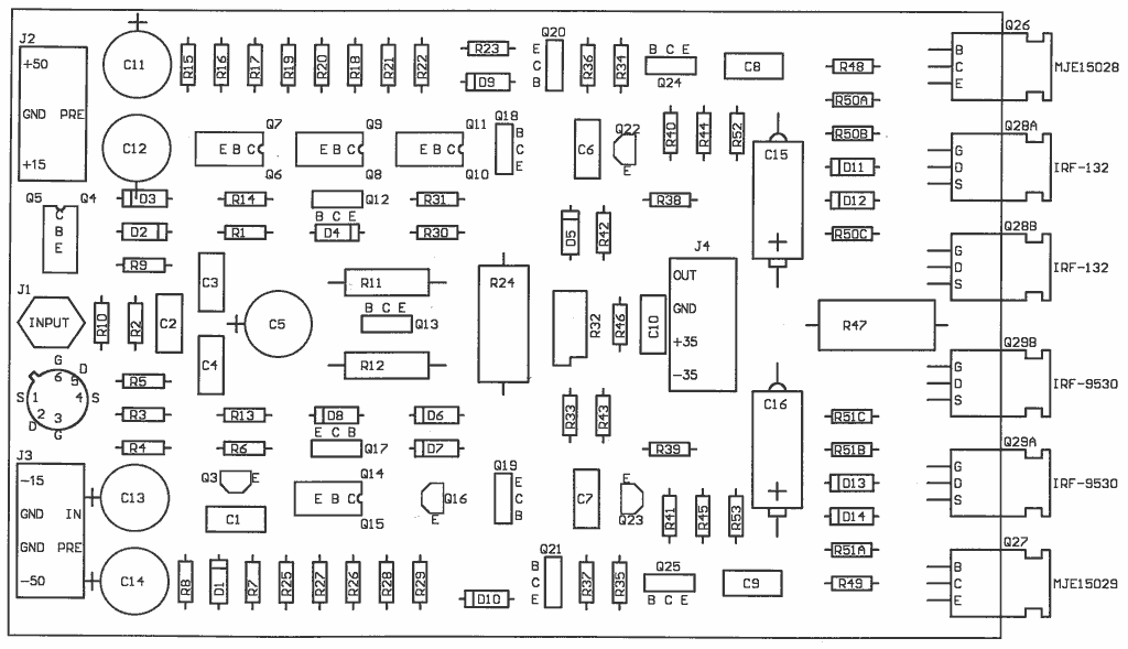

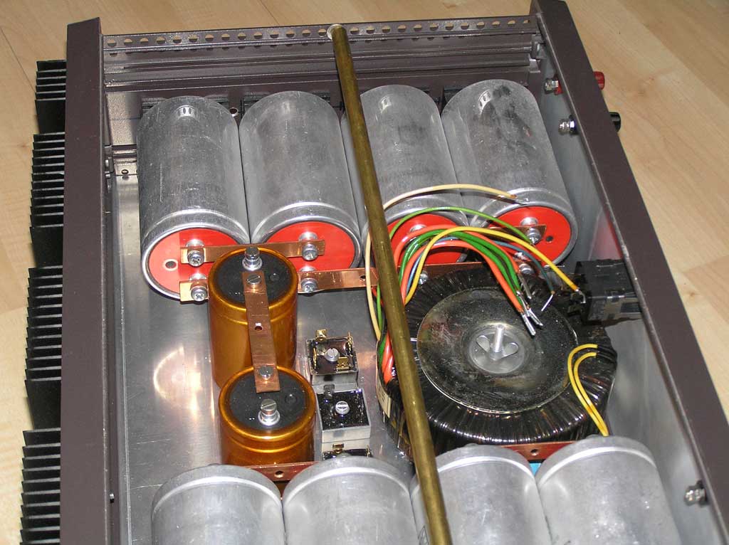

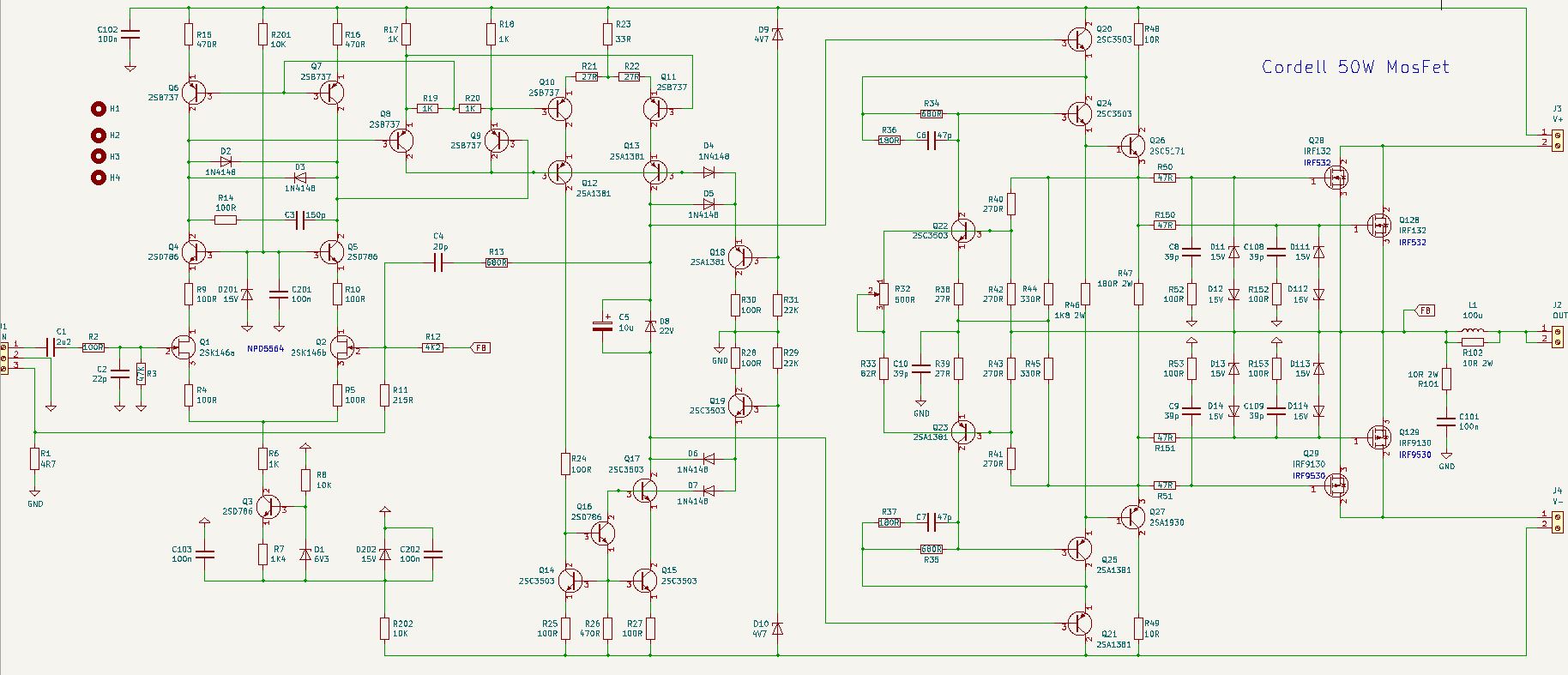

I am thinking og reviving your 50W HEXFET amplifier project that I started 30+ years ago. I did the layout of the boards, bought components, even built the box and had a custom ordered transformer. But I never came to actually producing the PCBs. So my question is this: Is it worthwhile in your opinion, to make this amp now? Will it compare favourably to the DH-220C? Which btw,I already have made a PCB for, but not started building.
A second question about output transistors: In my schematic I have doubled the output tranistors. Is this possible? To balance the transistors, maybe I would need to add source resistors to the HEXFETS?
My original PCB layout and box:
Today's schematic:
Reactions: anatech

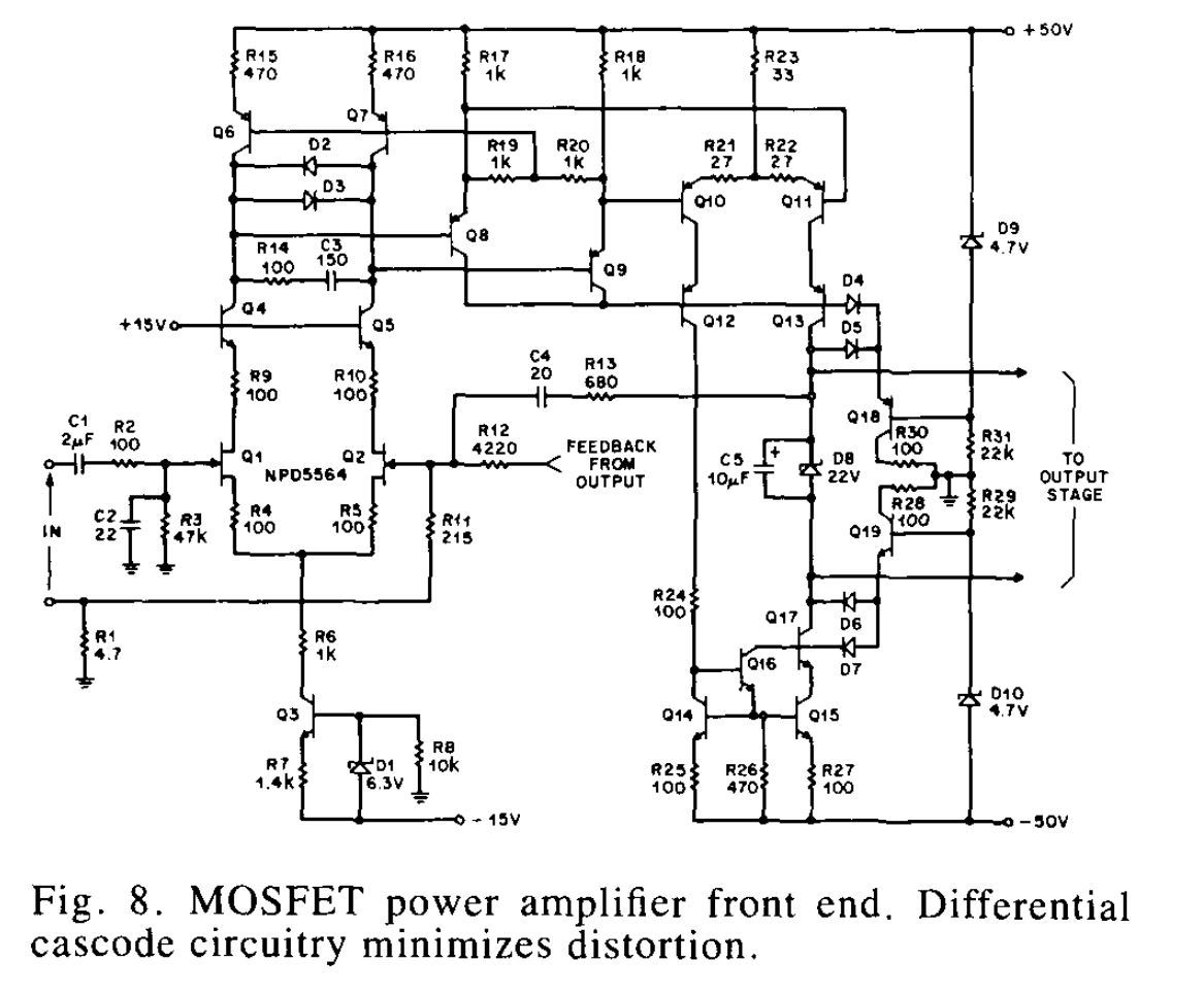

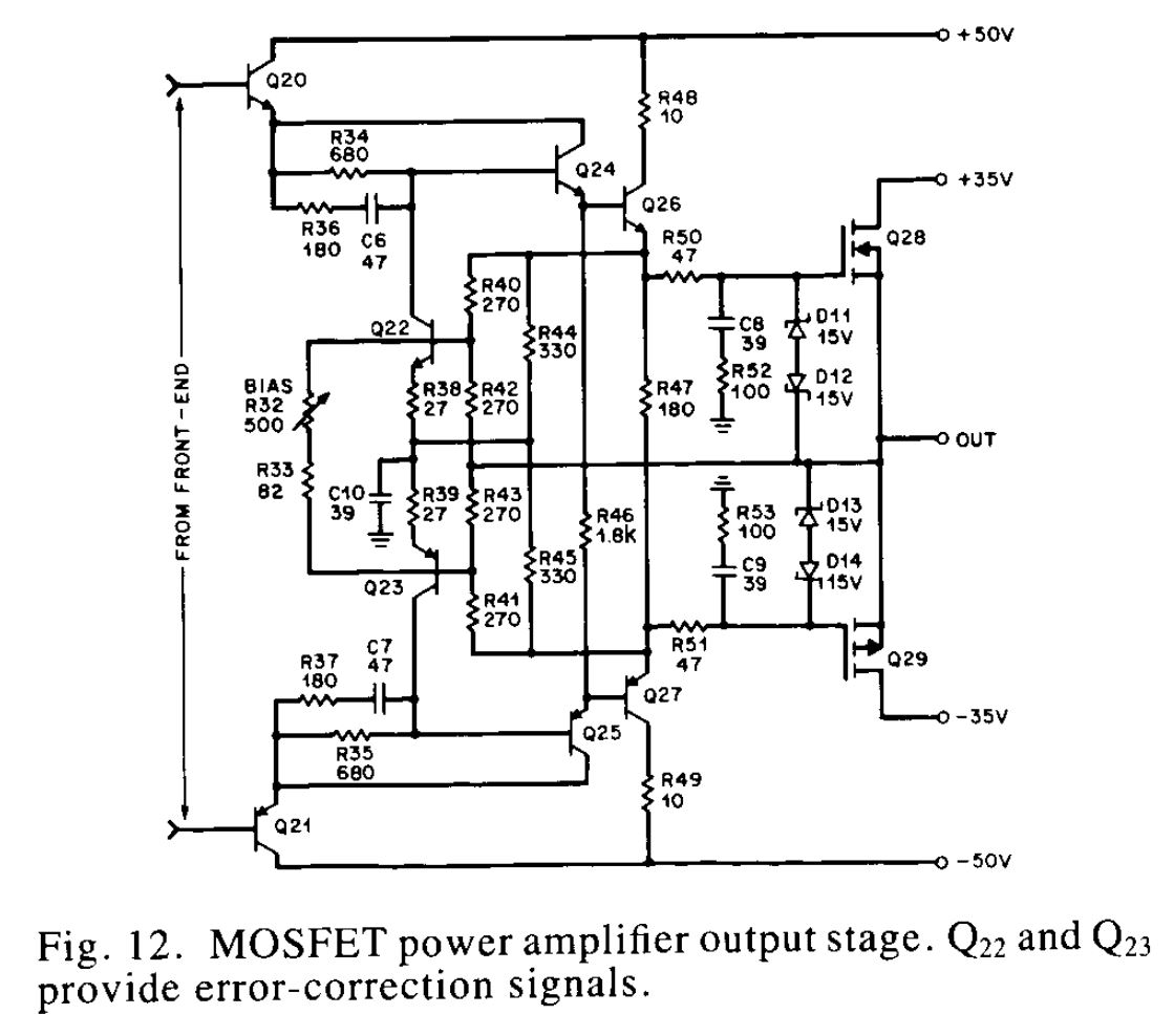

I have copied from the original article but there may be errors (hope not). Not having to double the output is a good thing! Seeing Bob is using cascodes and CCS's, would it be OK to rise supplies by 10V? I.e 60V & 45V?
Here are the original drawings:

Thanks for your comment! This project is more about nostalgia and fun - if I believe the end result is good enough. I did enjoy reading Cordell's application note in those days and I camo SO close to finishing the project. To make a completely new amplifier is not an option, since I have at least 10-15 projects in different states of (un)completion, and they are all begging for more attention.
But if you can give any advice on raising the supply voltage and maybe the comparison with the DH-200C, it would be great!
