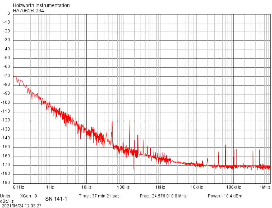

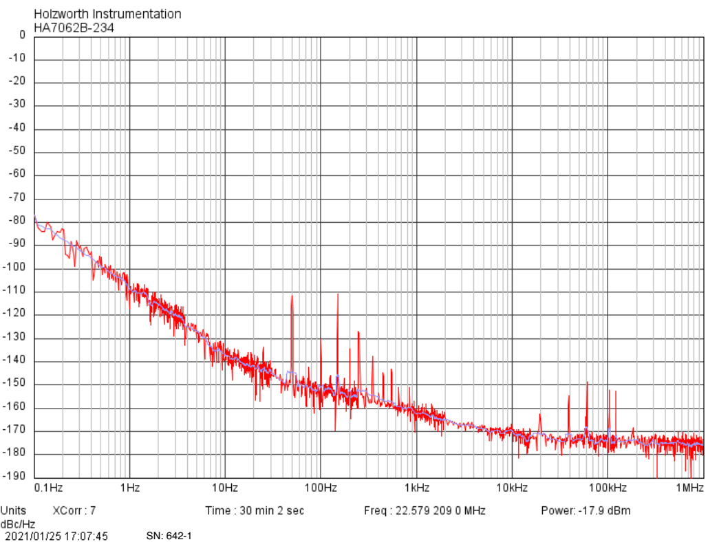

SOA crystal oscillators are readily available with extremely low close-in phase noise. Go look up the specs over at Vectron.
Here are what I am using today. Is Vectron any better at 22/24MHz? Probably not.
