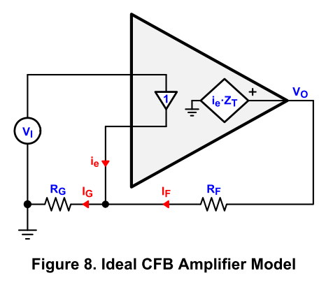

And in that light, this may be of assistance (it was indicated by Tournasol (thanks for that))
Yes, and as was 'referred to https://www.diyaudio.com/forums/sol...lls-power-amplifier-book-955.html#post5872349' earlier (by Jan/Bob ) it explains the GBW differences between both (VFB/CFB) clearly (I thought).
Yes, a good app note, but then again, no good audio book should be without a similar discussion, dispassionately discussing pros and cons of variants what Bob is so good at ;-)
https://www.diyaudio.com/forums/att...ack-operational-amplifiers-renesas-an1993-pdf
The direction of three arrows showing currents in figure 8 are of fundamental importance.
Ig = Ie + If
