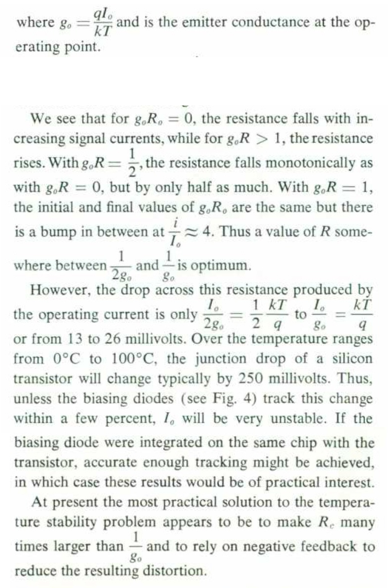

Speaking of Barney Oliver, here's the relevant section of the paper he wrote. Not somebody else's interpretation or summary. The original. You may have to click on the image one or two times to see it full size and undistorted.
Look for the expression "13 to 26 millivolts".
Oliver does not say "26 millivolts". He says "13 to 26 millivolts".

True, but in this context he appears to be saying that the optimum voltage across the external emitter resistor may be less than 26 mV as a result of changes in kT/q as a function of junction temperature, not as a result of an ohmic component of transistor emitter resistance as seen looking into the emitter of the power transistor.

No, Vt doesn't change that much from 300-400k. I think "between 1/2Go[=1/2Vt] and 1/Go[=Vt]" refers to a different mechanism.

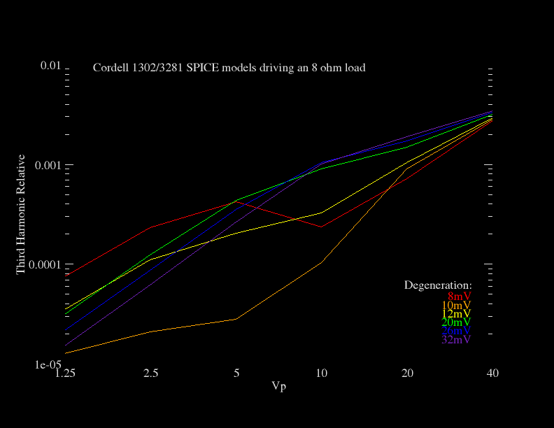

The reason the range extends below 26mV is because while 26mV results in a better average distortion when operating above the crossover region, it does this by creating a gain dip at the crossover point, thus creating the W shape in the wingspread chart.
This means that although large-signal distortion has been decreased, small-signal distortion at the crossover point has been increased.
When you reduce the emitter degeneration voltage, the W turns into a U, and at about 13mV (or thereabouts) you get a plateau at the bottom of the U which is very linear. This is good for signals below the crossover threshold, bad for signals above it. So if you want a linear class A stage using a complimentary EF, this is an often overlooked way of attaining it. Barney's observation of the thermal feasibility of low degeneration voltage is a significant concern.
You might remember this graph I created years ago using your simulation models with a voltage driven EF, which shows the interesting effect of lower degeneration voltages. The chart shows a null at 10mV for low output. There may have been a few mV extra across the base stoppers and internal base resistance.
Oops, I really messed up that first paragraph. Ic/2Gm=1/2Vt and Ic/Gm=Vt. Oliver seems to mean something a bit different by Io. But it seems clear to me he is not referring to Vt changing with temperature when he gives 13-26mV as the valid range.
You can download the paper here, although it is a bit blurry:
Barney Oliver: Crossover Distortion in Class B Audio Amplifiers
Yeah, I didn't take that away from what he wrote either, and when you look between 300K and 400K on >10^16 doping of silicon, the number of intrinsic carriers is too small to modulate the threshold voltage.
