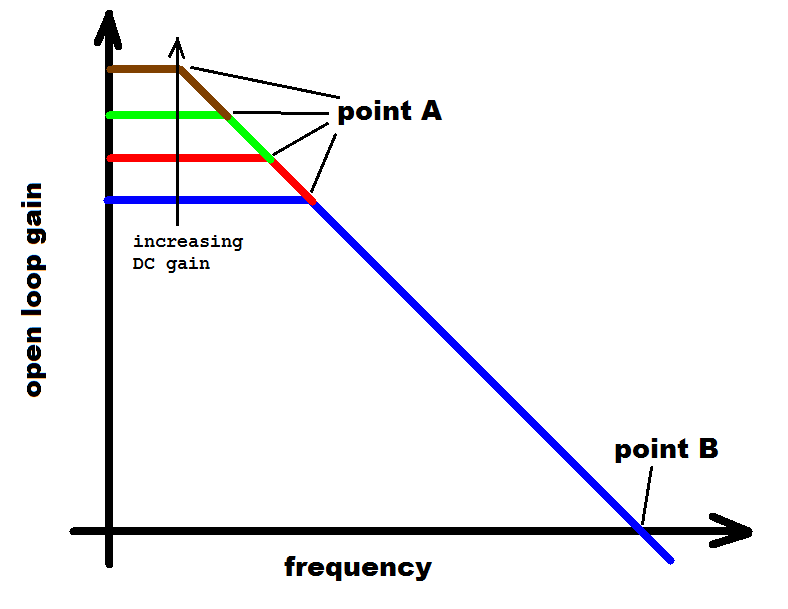

Okay. But isn't it the AC gain that matters?

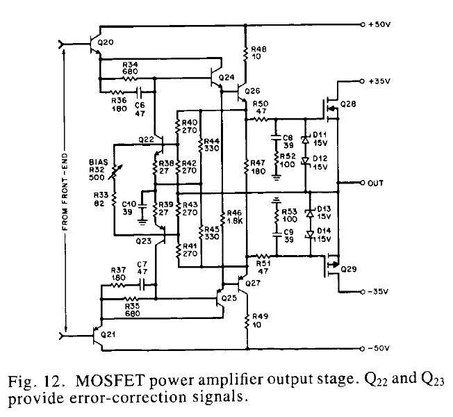

But to me the essential difference is that Curl's power amp topology connects MOSFET gates to the "VAS" output node. These have infinite input impedance. So the 2nd stage gain is stratospheric.my MOSFET power amplifier with error correction on my web site. It uses a cascoded push-pull VAS and has MOSFET output transistors, so its dc gain is also in the stratosphere.
Your power amp connects Q20,Q21 emitter follower bases to the "VAS" output node. These have finite input impedance. So the 2nd stage gain is merely tropospheric. schematic below.
_
What really counts is the open loop gain at frequencies above the intercept with the DC open-loop gain; like usually 1kHz and above. In other words, the open loop gain that matters is when it is being controlled by the compensation, such as the Miller capacitor, and is falling with frequency.
For all of the same reasons, open-loop bandwidth in these sorts of designs does not matter.

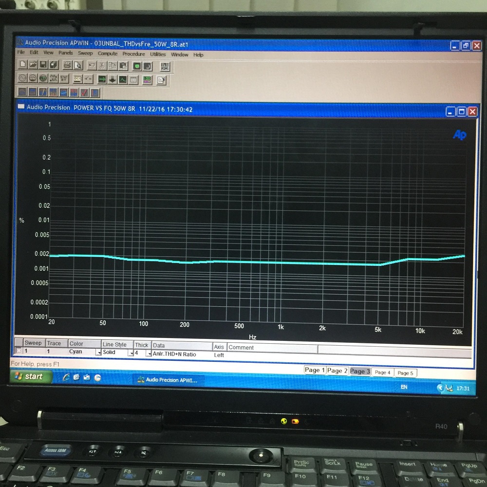

I am not sure what sort of design you are talking about, but some say that similar distortion (low enough) thought whole audio spectrum will sound better and that is possible to achieve with wide open-loop bandwidth(or loop gain). I don't have enough listening experience to say it's true and would like to know others opinion.
.edit
Richard showed that plot before in this thread.
BR Damir
_
This is all fine about the mosfet's infinite Z on dc gain. but what about the capacitance loading on the VAS?
.edit
BR Damir

Right. So there isn't much point in shoving the dc gain up further. The slope stays the same.

Then he applies a cute trick: he builds the output stage cascade of followers, using MOSFETs as the first of the followers. Their zin is ~ infinity. So the output stage's zin is ~ infinity and it does not load the 2nd stage (at DC) even one little bit.
Yes, and also much more nonlinear, since the mosfet input impedance is very nonlinear, pretty much Crss capacitive, much worse than a low Cob bipolar. Take a look at how the Crss varies with the Vds voltage in a typical high voltage low power mosfet like the 2SK4150 https://www.renesas.com/en-us/doc/products/transistor/004/rej03g1909_2sk4150ds.pdf it's between about 80pF @1V and 3pF @25V. For the same voltage span, a 2SC3503 has Cob varying from 6pF to 2 pF.
The "cute" trick for using a mosfet in the VAS, while certainly providing a large (open) loop gain, goes in fact straight against the "open loop linearity" design philosophy, and it was long time proven to be a false solution to a real problem (the VAS nonlinearity).
