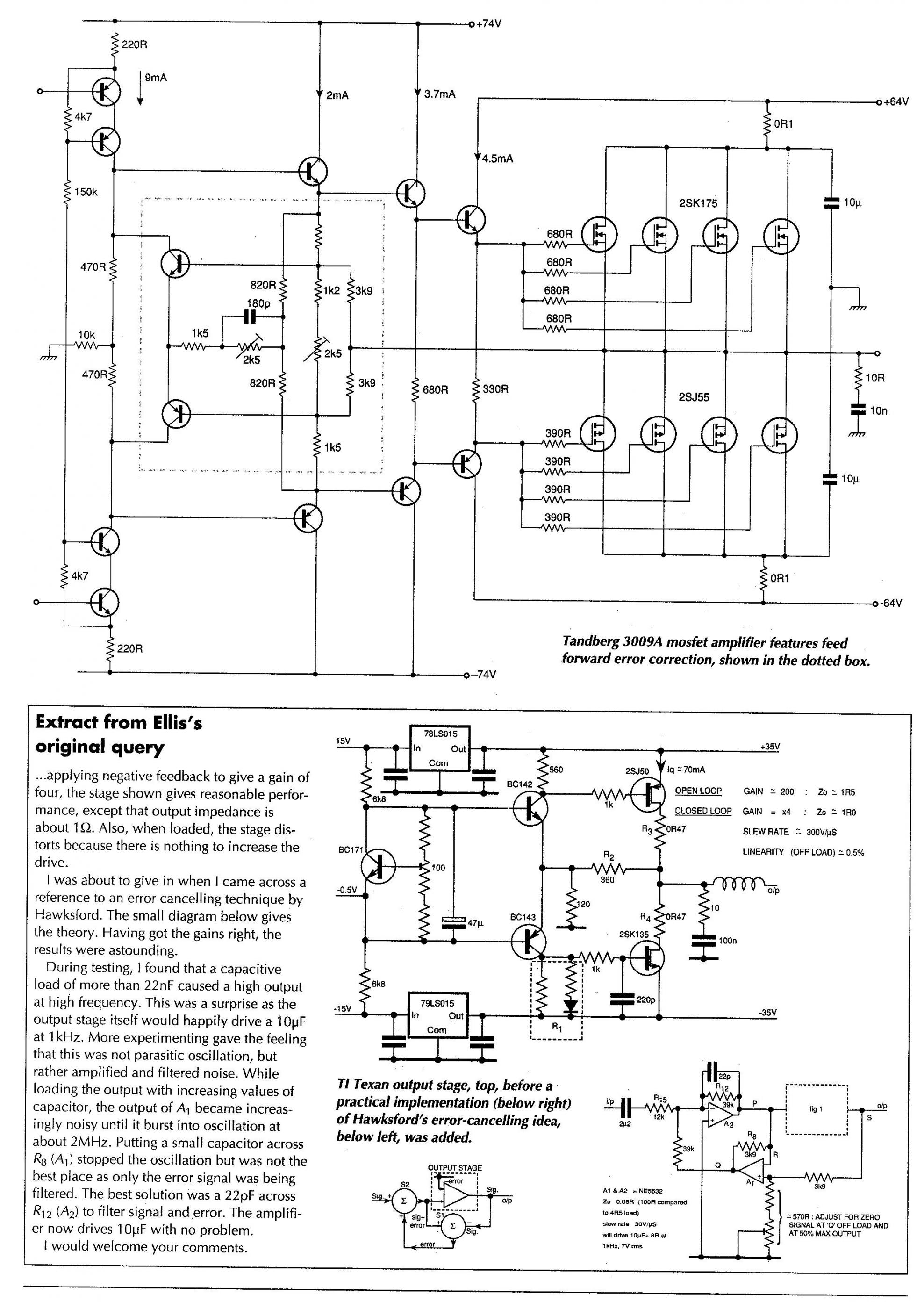

Yes, in fact I had a whole chapter in the book on error correction, specifically my implementation of Hawksford error correction (HEC) for vertical MOSFETs. The Electronics World article shows my implementation of HEC, so of course I think highly of the approach 🙂.
Bob

The Ellis amp will SELF-DESTRUCT if overloaded at HF and perhaps also at MF and at lower levels.Here are the two full Electronics World articles about error feedback quoted above :
K. H. Ellis, december 1996 :
http://iodau.pagesperso-orange.fr/Ellis.KH_'Amp%20err%20corr%201'%201996-12_EW.PDF
What happens is MOSFET Cgs charge up and can only discharge through the 680, 1k and 'R1'. On HF overload, the capacitors charge up to very high voltages until the MOSFETs die or the PSU gives up.
Adding extra Cgs like the lower 220p makes this happen at lower frequencies and/or levels.
