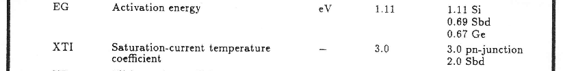

Dear Bob,
is it possible, that the EG parameter of the model 2SC3503C may be wrong? I have some thermal troubles using a 2SC3503C in a Bias generator compared from simulation to real life (using the base/emitter diode as temperature sensor). If using the BD139C model the difference between simulation and real life is smaller.

In my SPICE modeling I did not adjust EG from the manufacturer's models. It does look like the value here of 0.75 is on the low side, as EG for silicon is most often in the range of 1.1. Try changing it to 1.1 and see what you get. However, if I am not mistaken, that may interact with IS in such a way that simulated Vbe at room temperature may change.

Dear Bob,
thanks for this information - this explains the problem very well.
FYI: Just tested 2SC3503C model with EG=1.11 .
This seems to fix the differences. Now the simulated bias change from temperature 22 - to 50 degrees is nearly exactly the same as the real life measured one.

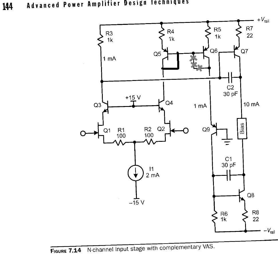

I'm sure that Bob will check in on this sometime soon, but yes...I agree that the schematic should be corrected in the manner that you show.
Hi
during reading Bob's book I found a possibly mistake,
am I right the circuit should be like amended in attachment?
Hi Pawel,
Thanks for pointing this out. I always appreciate feedback on the book, be it in regard to errors, or sections that need better explanation, or technical assertions I have made that one does not agree with. Many people on this forum have been very helpful in this regard, and I had been previously made aware of this error. I have been keeping a list of all such errors so that I can make corrections in the second edition.
