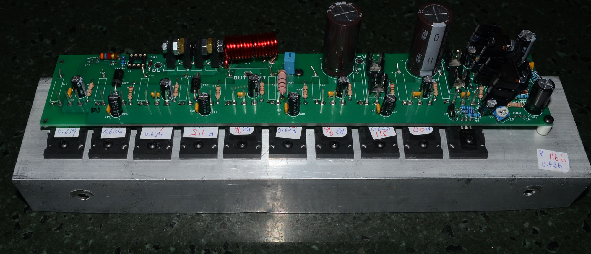

Attached is the image of my OPS on the heatsink. Finally I got the 0.22, burn in the 0.22 and put it all in. I measured the resistors and put the two that is like 2.5% lower value at the two ends and put the two transistors that has beta 1% higher than the ones in the middle at the two ends. Vbe of all the PNP and NPN are matched to at least 1%.
The temperature of the transistors at the two end has better cooling, so I make it work harder to heat it up slightly more and for more accurate temperature sensing. All in all, I don't think I need all those fancy uP stuffs to avoid hogging. I am a true believer of "less is more". Don't get stuck in all the fancy ways of controlling the bias current.
Sorry.
