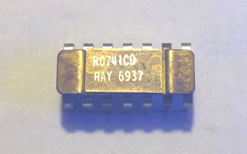

I here Radio Shack has filed for chapter 11. All I ever saw there was 1970's stock of parts.
I'm not sure all the parts were new though. So UOS. Lots of uA741. I had a guy there try to sell me a 741 for a an open collector voltage comparator. Claimed he was an engineering student, so he should know.
Are the NOS 741's supposed to sound better than the ones currently available? Ha, ha.
Bob
For best sound you must use the very oldest 14 pin ceramic packaged 741's. Fairchild is best but Motorola is a close second.
