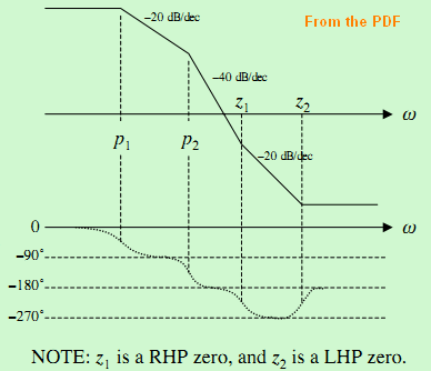

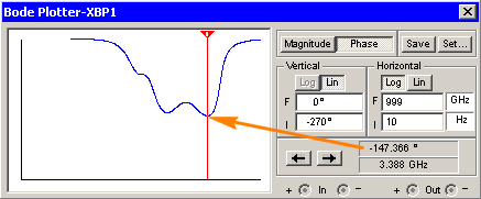

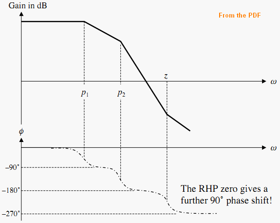

Re - RHP
I'd never heard of RHP Zero until mentions of it in this thread. After looking @ the FrequencyResponse.pdf linked by michaelkiwanuka http://cktse.eie.polyu.edu.hk/eie304/FrequencyResponse.pdf i examined my Enhancer circuit http://www.diyaudio.com/forums/solid-state/238449-thd-loop-gain-enhancer.html
Yes the phase is "rather" extended 😀 but that's just to see what it shows. I doubt that in a real Amp etc, even with the worlds best oscilloscope, we could witness such HF plots with real audio circuits ?
I noticed that the phase never reached 270' only 147' ? There do though "appear" to be some similarities between my phase plot & the ones in the PDF. I don't pretend to understand it all, or anywhere near, i'm just attempting to establish whether there is "something" worthwhile exploring further in RHP ?
An explanation of what i'm seeing, would be welcome 🙂

An explanation ... would be welcome
Hi
The link is excellent. I found and read it a few years back and re-read it when reminded by Michael's post. Thanks to him for that because it was helpful to read it second time. So you probably need to read it a few times too😉
RHP zeros are practically never desirable in an amplifier so it is worth the effort to eliminate them. In a conventional amplifier the only one is likely to be caused by the VAS aka TIS. Usually not a problem because it is above any frequency of interest.
It is possible for a particular combination of reasonable component choices to result in the RHP zero frequency to be sufficiently low to affect the stability a little. This can occur if the LTP emitter resistors are fairly low (to reduce noise probably) compared to the VAS/TIS emitter resistor (used for over-current protection, often).
If your circuit is unconventional then normal rules-of-thumb won't help. But I doubt a RHP at >3GHz will hurt.😉

Yes the phase [frequency? - HarryDymond] is "rather" extended 😀 but that's just to see what it shows.
Please do not waste your time simulating to 1 THz. What you are seeing bears no resemblance whatsoever to what you would see in "real life". Unless you have specific distributed models for every single component in your schematic, including circuit board traces, don't bother going above about 200 MHz (even at this frequency you need at least some modelling of circuit board traces).
I hope by reading the reference from Michael that you realise that to get anywhere with AFEC, circuit analysis (aka maths) is required.
