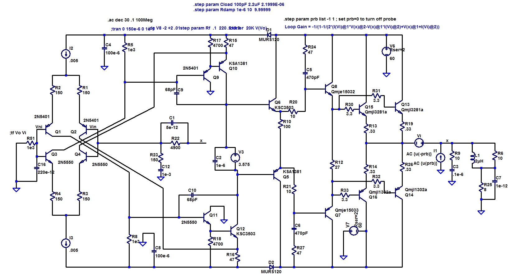

Well, I always design WITH an output L, but here are some examples illustrating the point.
1st graphic is normal amp without L driving a (brutal) 2.2uF load - might be an Electrostatic panel for example. This amplifier is not stable and the phase margin insufficient.
In the 2nd graphic, the loop gain has been reduced - the diff amp degen resistors increased and Cdom doubled to set the ULGF to about 200 kHz. The output stage pole now sits higher than the ULGF even with the 2.2uF load. This amplifier is stable. BUT, the loop gain is reduced, so you pay a penalty for this approach in distortion performance. I did not optimize the ULGF - just stuck it very low at 200 kHz to illustrate the point - you could probably get away with something a little higher at 300 or 400 kHz.
The final graphic is the original high LG compensation design, but with a 2uH//10 Ohm load coupling network. Here the ULGF is 1 MHz (quite typcial for this type of design).
The kink in the LG you see at 77.912.6265322924 kHz 🙂D)is just the output coil resonating with the load capacitance.
Note, even with amplifiers that eschew an ouput inductor, you are still likely to see ringing as the speaker cable inductance resonates with the speaker capacitive load - there's no getting away from that one, but I guess as a speaker designer you already know that.
The last is the circuit of the amplifier - with the values of Cdom and Rdegen shown for low loop gain. There are probably more advanced compensation techniques that could be used in this design (TPC/TMC for example) to improve the distortion performance with the lower loop gain, but I have not addressed that here - this is purely illustrative. Note, the output coil with this low LG design is shown in situ in the circuit - for the plots, I shorted it out.
