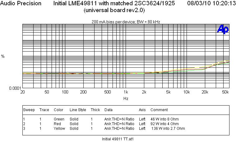

The best I've done with a BJT amplifier is 0.005% THD-20 at 20 kHz into 8 ohms, but I was not really trying that hard or doing anything fancy. The amp used two pair of ThermalTrak devices with RE=0.22 ohms and a gain crossover frequency of about 500 kHz with straight Miller compensation. The amp had 50V rails.
Here is my data, though using LME49811 driver chip. But I payed much attention to layout and wiring to get the performance. My rails is +/- 40. MJE15030/31 driver and two pairs of Sanken 2sc3624/sa1925 EF, RE=0.11 ohms form the output stage. Single-pole compensation is used.

Hi Edmond,
If anything, I think the positive TC of the 20 mV number is a good thing; it certainly would be in the right direction if it was reflective of the output transistor temperature, since Vq = Vt has a similar positive temperature coefficient. However, over the temperature ranges that the LT1166 can be expected to operate (essentially board ambient), the temperature change as a percentage of absolute temperature is quite small, so I don't think it is much of a factor one way or the other.
It is notable, however, that if you take the spec sheet at its word, there is quite a large tolerance on the 20 mV, about a 2:1 p-p range. This is not desirable, if really true. The ones I looked at were very close to 20 mV. If this were a problem, I would not rule out adding a trim pot. I know, it sounds crazy, but eliminating the trim pot is not the only potential advantage to a well-executed 1166 circuit - non-switching and dynamic temperature stability.
Yes, I essentially introduced a series R-C across the device. BTW, as a shunt bias spreader, the device is more than adequately fast, and in fact this is part of the reason the compensation of the common mode loop is necessary.
