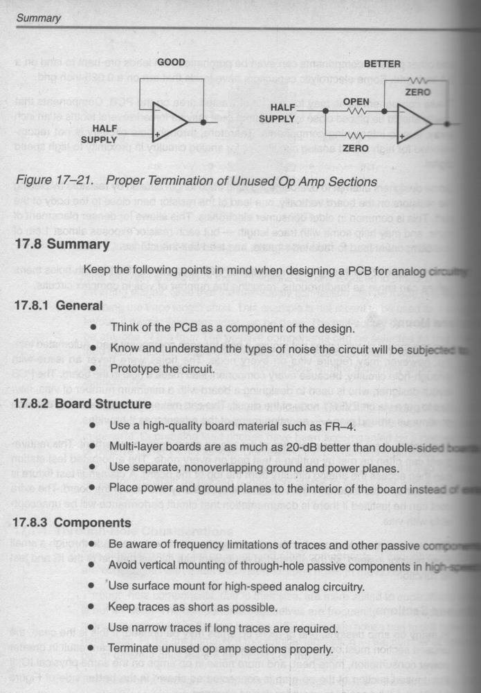

Recently I tried to make selfoscilating classD amp. It drives me bananas 😀
It appears that the PCB is the most important component of these high-frequency designs (target=400khz selfoscilating), not the transistor, not the capacitor.
Then I look for reference. TI's SLOD006, chapter 17 with it's 2 references papers (by Bruce Carter) seems talking about this.
The first page of this page (17-1):
"Prototype, Prototype, PROTOTYPE".
Like what NP said, it seems in this area it is "trial and error" type of work. 😀. In the general summary, it says "Prototype the circuit", not saying "make this = this way, make that = that way"
In page 17-14 I found more surprise. Above 100khz, PCB trace behaves more like inductor, not resistive. Ground plane, antenna effect, input and return path, so many things to be aware of. If we use ground plane, PCB track is actually making capacitor with ground.
Well it makes me learn alot....I'm sure the experience of making selfoscilating classD PCB teaches many things that is perfectly implementable to classAB PCB designs.

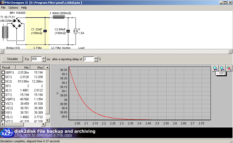

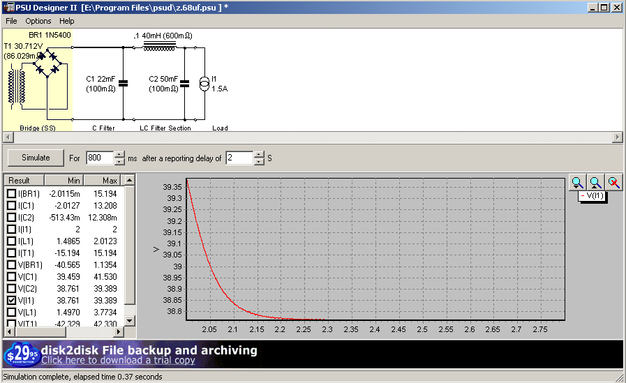

jackinnj said:
I am going to bet that the mean voltage from which it is stepped is higher.
Here are the sims. All three used stepped load with 1.5A constant current jumped to 2A at 2 second. They are identical except the last cap having different values.
68000uf
agent.5 said:
If you set PSUD2 to stepped load, you will notice that too much capacitance will slow down the rise time.
Of course it will. That's what capacitance is all about. But it will also slow the "fall time" if you will. The net result is that the power supply with more capacitance will provide a steadier voltage under load, as any given cycle of the same magnitude will use a smaller fraction of the available capacity. I'm no expert on electronics, but this issue is a simple matter of balancing both sides of an equation.
A stepped load in PSUD is there to look at ringing behavior in the power supply. You have to be careful making conclusions about what it means for music signals.

Well, my conclusion was that more capacitance is NOT always better. I did not try to go to either extreme of no capacitance or so much capacitance that only NASA can afford to experiment with such setup.
Looking at the 3 sims above, it appeared that they all have pretty constant voltage and similar ripples, and the lowest capacitance setup is the fastest.
Maybe I should ask, Sheldon, which one of the three will you pick based on the graphs?

I did not say that more capacitance is always better. Who knows what might sound best to any particular person. What I did say is that more capacitance means that you will have less ripple on the rails, either from the rectifier input or from the effects of the amp drawing power during music signals. If that's your definition of slow, then yes, slower would generally be considered better. If by "faster" you mean a "stiffer" power supply (which I would think is the usual definition, or at least a definition based on the physics), then your analysis is flawed.
Sheldon
Edit: I pick the one behind door 1.
Sheldon
Now let me ask you a question. Do you want the power supply voltage to drop rapidly when you begin drawing more current, or would you like it to stay where it was?

again, it is all within a small range. Looking at my 3 sims, they don't drop all that much to begin with.
I agree, the analysis is flawed.Sheldon said:..... more capacitance means that you will have less ripple on the rails, either from the rectifier input or from the effects of the amp drawing power during music signals. If that's your definition of slow, then yes, slower would generally be considered better. If by "faster" you mean a "stiffer" power supply (which I would think is the usual definition, or at least a definition based on the physics), then your analysis is flawed......I pick the one behind door 1.
this sounds like "do you want high dynamic overhead" or good bass?Sheldon said:Now let me ask you a question. Do you want the power supply voltage to drop rapidly when you begin drawing more current, or would you like it to stay where it was?
I think you have asked PSUD2 the wrong question.What have you asked PSUD2 to tell you?
Your supply with 0r6series resistance is superb at eliminating mains hum, but less good at maintaining rail voltage under load, particularly the varying load of a normal ClassAB amplifier.
Put a scope on the supply rails and measure what they are doing.
Try reducing the series resistance significantly (a much thicker wire in your choke) then your recharge will be quicker and by keeping the biggish caps you keep stiff rails under load.
BTW, I would normally recommend +-15mF to +-20mF/ch for your amp and speakers. The lower 15mF based on rail ripple and the higher 20mF based on PSU RC>=160mS. You are way above this. Is this a very high bias ClassAB amp? A low bias amp that suffers from hum with +-20mF of smoothing is faulty/badly designed.
